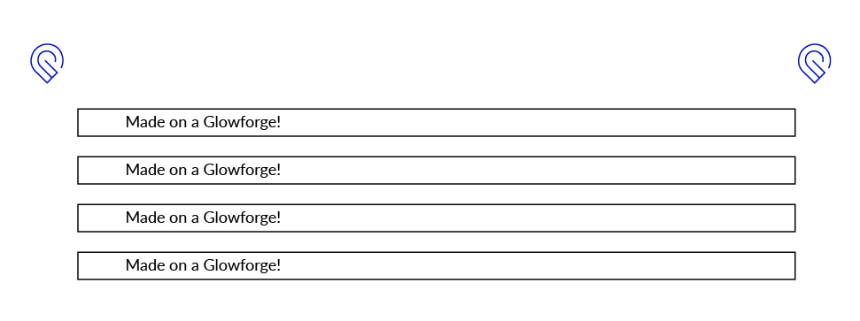

Download the tutorial template
  • For this tutorial, download the pencil jig template file we've prepared.
  • Add custom artwork
    • Add artwork you want to engrave inside the cutouts. In our case, this means adding text into the rectangles that will hold the pencils.
  • Add custom artwork step - snapmark
    • Save as an SVG
    • Save the file as an SVG and upload it to the Glowforge app.

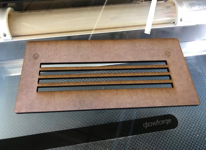

  • Print the jig
  • Create the jig you'll use to hold your pencils in place.

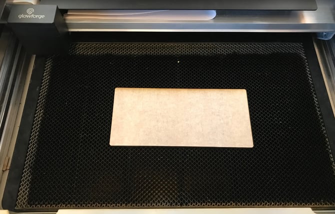

  • Place jig material in the bed
  • Put your jig material in the bed. TIP: Choose material that's a similar thickness to the items you're customizing.
  • Put jig material in step
  • Print your jig

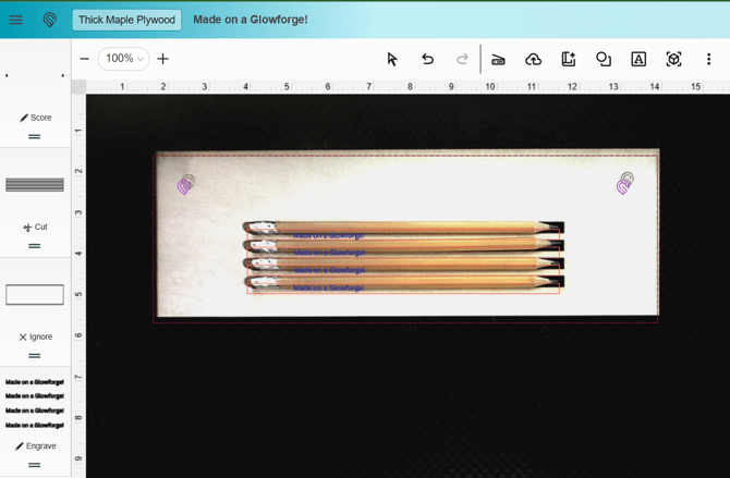

Before you hit print:
  • Set the Snapmarks to "Score"
  • Set the cutouts to "Cut"
  • Set the artwork to "Ignore"
PencilJigSnapmarkTemplate
Hit "print"
When it's done printing, take the jig out of your Glowforge and remove any scrap.

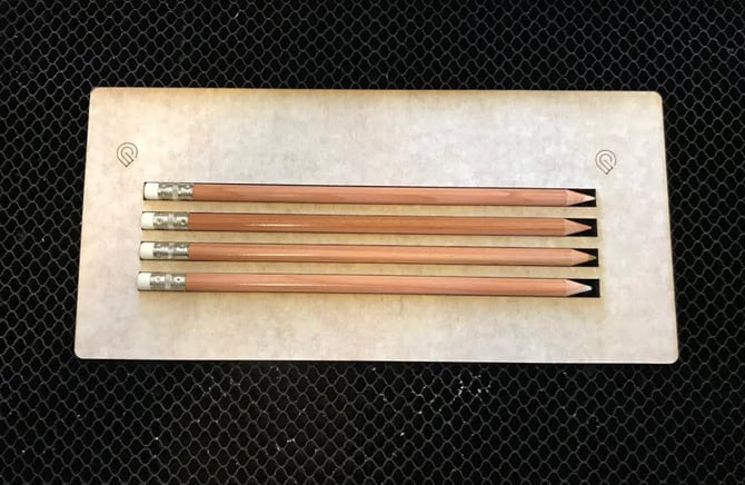

Load the jig
  • Get your items ready to print.
  • Place items in the jig
  • Put the jig back in the center of the bed and place your items in the cutouts.
load the jig

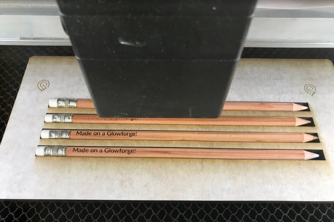

Time to personalize your pencils!

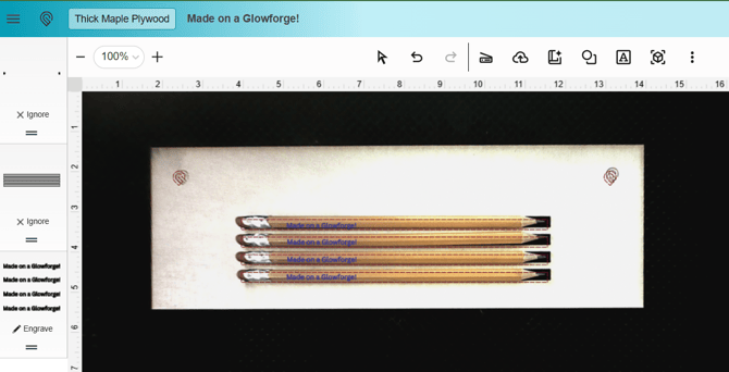

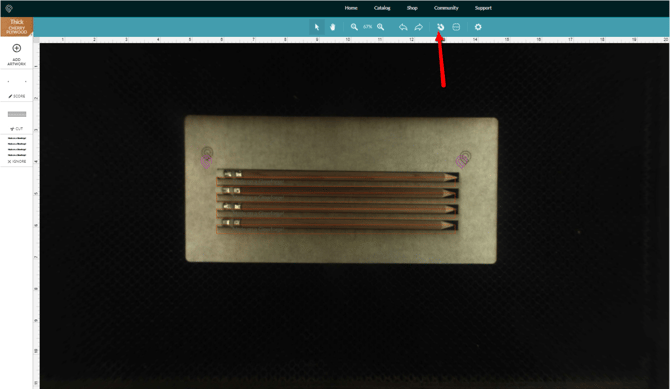

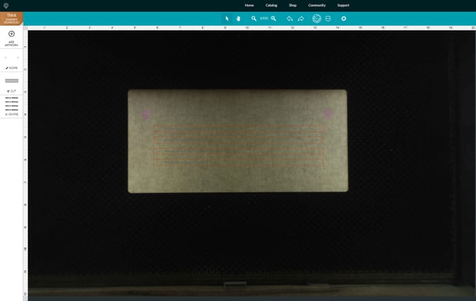

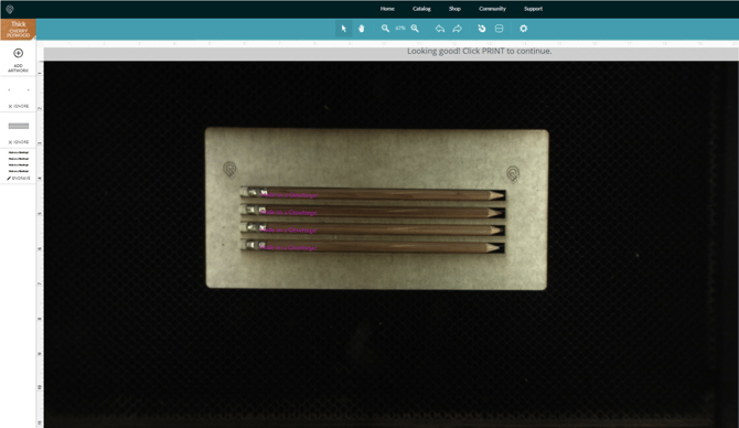

Hit the "Snapmark" button
image (4)
Let your Glowforge search
Your Glowforge will start searching for Snapmarks on the bed. After a few minutes, you should see the artwork moved to match the previously scored Snapmark locations.
Don't move your artwork
Do not move the artwork or material after this step, even if the image doesn't look right on your screen.
image (6)
Prepare for printing
  • Set your artwork to "Engrave"
  • Set the Snapmarks to "Ignore"
  • Set the jig cutouts to "Ignore"
Hit "print"
hit print

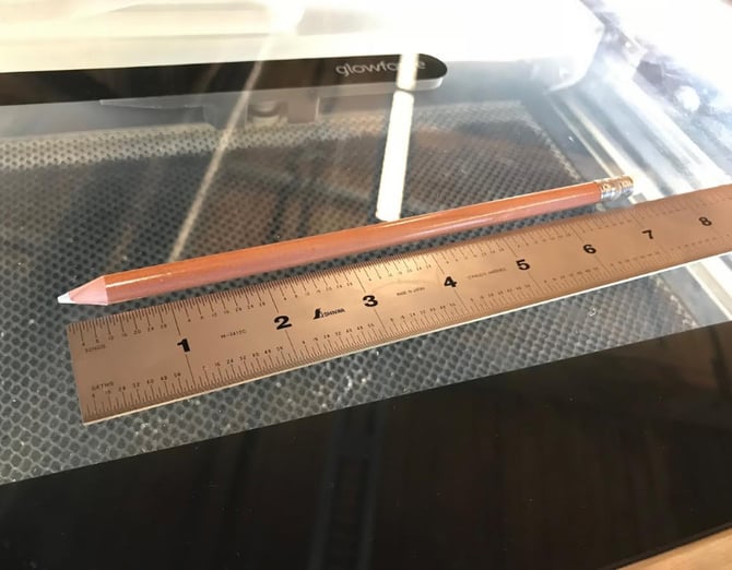

Measure your items
Measure the items you'll be customizing. (In our case, a set of pencils.)
Pencil and rulerr

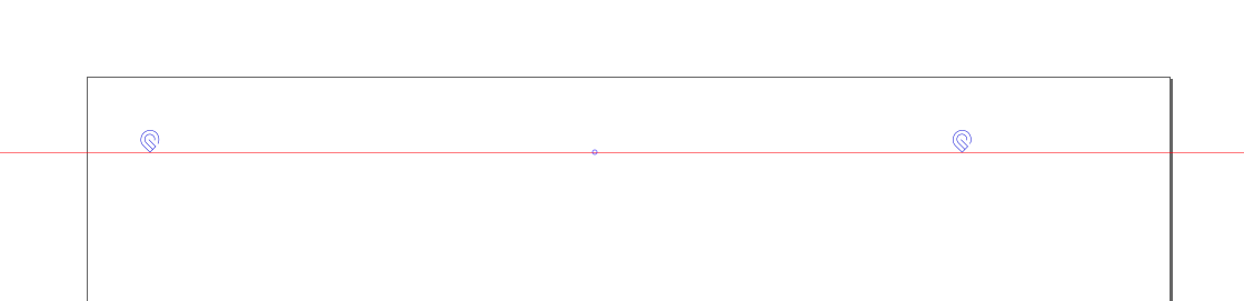

Adjust snapmarks
Snapmarks should be parallel to each other and no more than 16" apart (at least 2" inside the perimeter of the printable area). You can move the pair of Snapmark markers closer or further apart, and up or down, so they fit around your artwork.
Snapmark pair
Place and lock your Snapmarks
Make sure not to rotate or resize the Snapmarks when you place them. Then, lock the Snapmark layer again.
