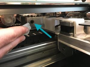

Inside the left-hand side of your Glowforge Pro, Plus, or Basic you'll find a silver box with a small, silver-ringed orange window, which protects the mirrors and optics  from harmful dust and dirt. This is the silver laser window.
If it's scratched, damaged, or has stuck-on residue, prints can go awry and the window will need to be replaced. A new silver laser window can be purchased in the Glowforge shop.
Here's how to replace the silver laser window:
  1. Turn off your Glowforge.
  2. Lift the lid.
  3. Locate the silver box on the far-left side of the Glowforge.
  4. On the box, find the silver-ringed orange window.
  5. Unscrew the window. (For a better grip, try a rubber glove.)
  6. Screw in the new window.
  7. Clean the new window with a Zeiss wipe.
    A hand holding a lens wipe and cleaning the window inside the left-hand side of the Glowforge
