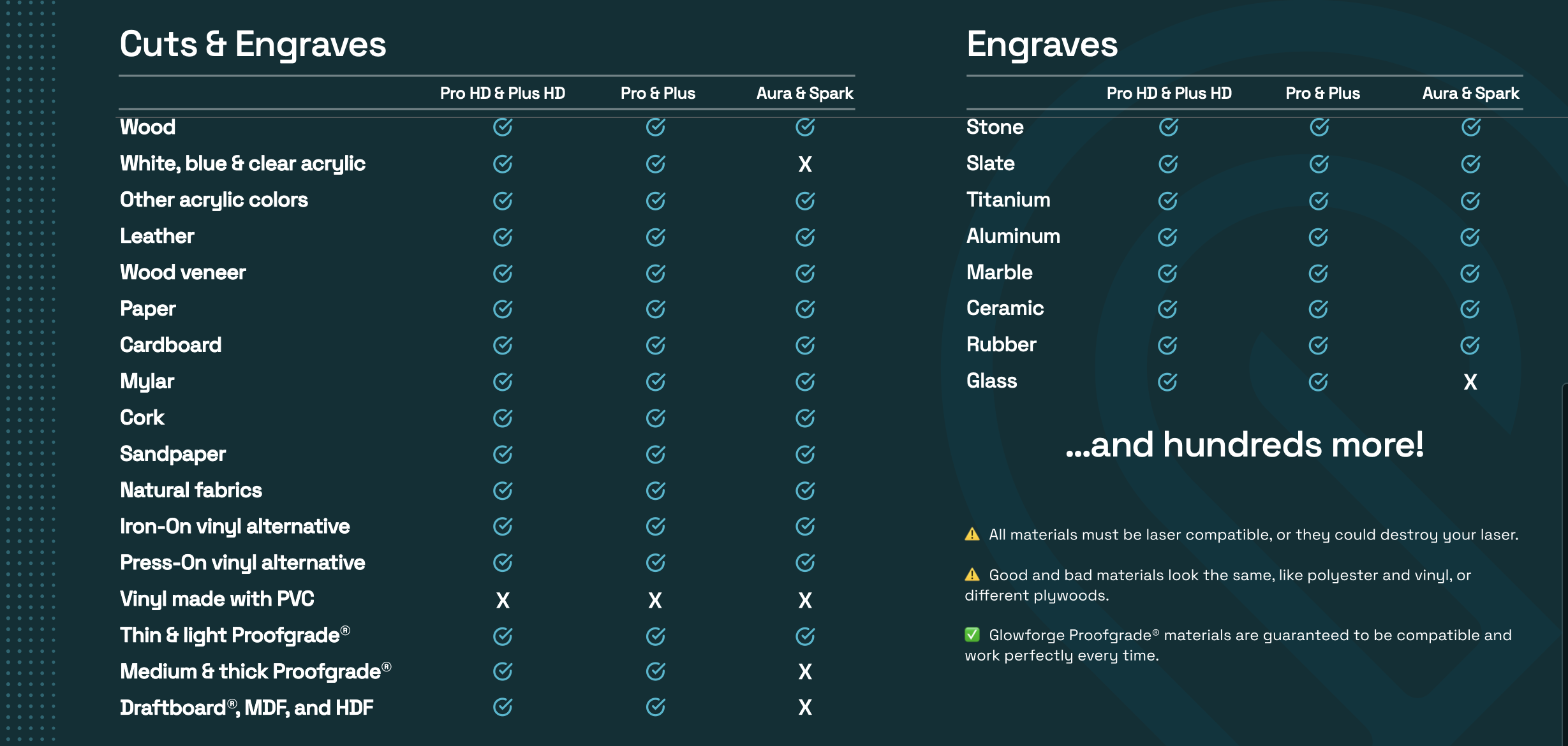

Can I print on...?
Glowforge creators often ask us what materials they can use. The short answer is that there are a lot of options, but please note, while many materials are laser compatible (including many (but not all) woods, plastics, leathers, and papers) you still have to take care with what you use. Using the wrong materials can damage your laser or cause harm to you or others. For example, some leather is processed with non-laser-compatible chemicals.
To simplify the process, we created the Proofgrade® line of laser-compatible materials, which are extensively tested for safety. Designed specifically for Glowforge, these high-quality wood, leather, acrylic, and other materials include protective masking to prevent char. They automatically print with expertly determined settings to provide the best print every time.
So, while we support our Proofgrade® materials and will happily help you get the best from them, we can't speak to the safety and reliability of other materials. We always recommend that you contact the manufacturer, inspect their safety data sheet (SDS), and/or consult an expert to determine if each material is compatible with your laser.
You can read more about materials safety in the manual at glowforge.com/manual. Now that we've explained some of the considerations to keep in mind while choosing materials, let's talk about specific materials.
