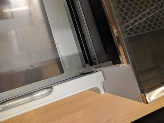

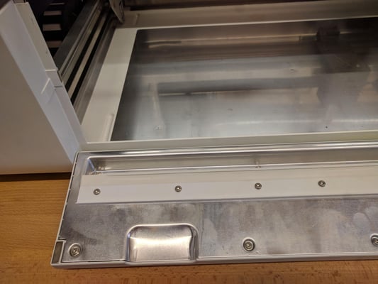

If you're still receiving the message, please compare the following photos to your Glowforge:
​The front-left of the Glowforge lid. The lid is closed completely and undamaged. ​The front-right of the Glowforge lid. The lid is closed completely and undamaged.​
​The left side of the open front door of the Glowforge. There is no debris present and the door is undamaged.
​ ​The right side of the open front door of the Glowforge. There is no debris present and the door is undamaged.​
​The left side of the closed front door of the Glowforge with the lid open. The door closes completely and there is no damage.
​ ​The right side of the closed front door of the Glowforge with the lid open. The door closes completely and there is no damage.
If anything on your Glowforge looks different, please take a picture and send it to us.
