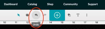

First, you can use undo actions any time, until you leave or refresh the page, by using the undo buttom (shown below).
A screenshot of the menu bar in the Glowforge App, with the Undo button circled.

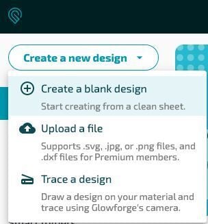

For a clean start with a design you've uploaded, go to your dashboard, click Create a new design and then click the Upload a file button to upload the file again.
A screenshot of the create a new design options in the Glowforge App

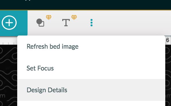

  2. Click the "..." button
    A screenshot of the 3 dot button in the Glowforge App
  3. Click Design Details.
