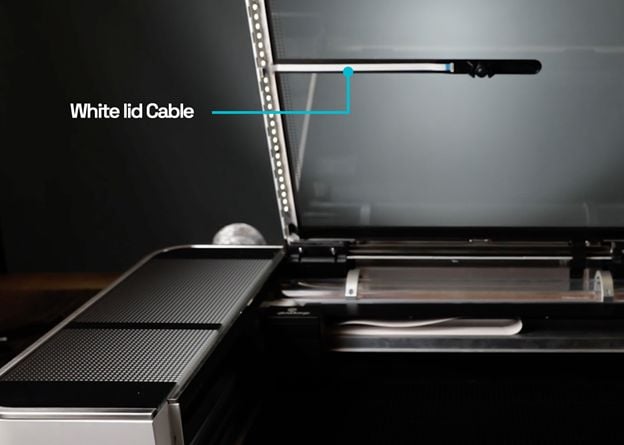

  2. Open the lid and locate the white cable to the left of the lid camera.
    A Glowforge with its lid open and the lid camera visable

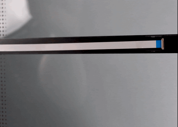

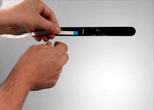

  5. Holding the new cable with the adhesive covering facing the lid, slide the right end of the cable into the clip next to the camera, and then close the clip.
    Animated gif of inserting the cable into the socket next to the lid camera and then carefully closing the socket clip
  6. Align the cable between the clips as straight as you can.

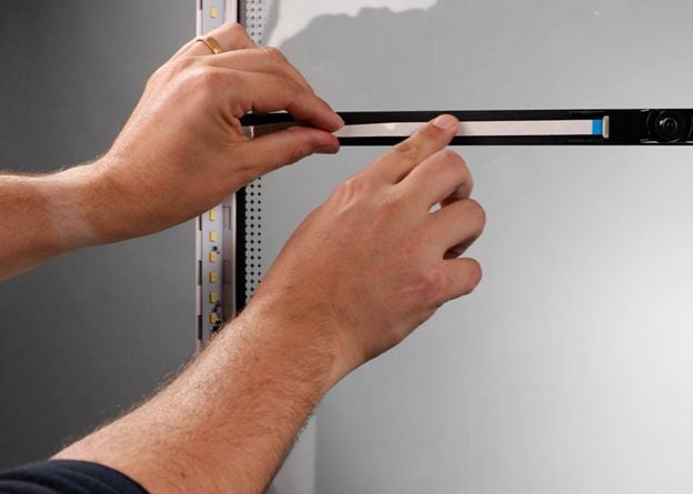

  7. Working from the right end near the camera, peel back the adhesive covering and attach the cable to the lid with the adhesive.
    One hand holding the cable, the other pressing on it to stick the adhesive backing down

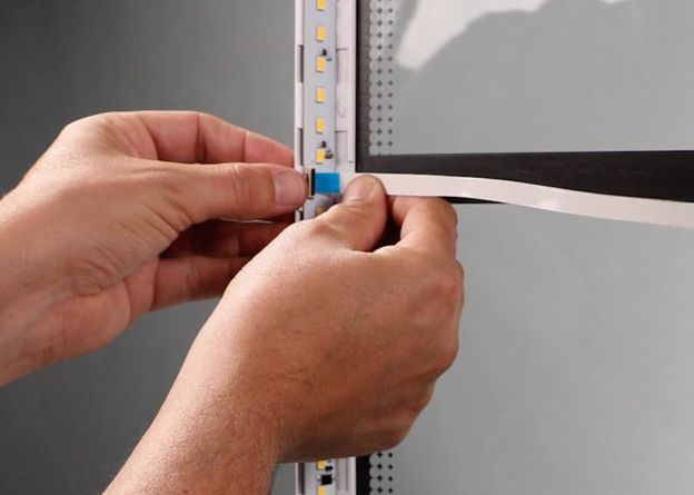

  8. Slide the left end of the cable into the left clip, and then close the clip.
    The cable being inserted into the socket along the LED strip on the left side of the lid
