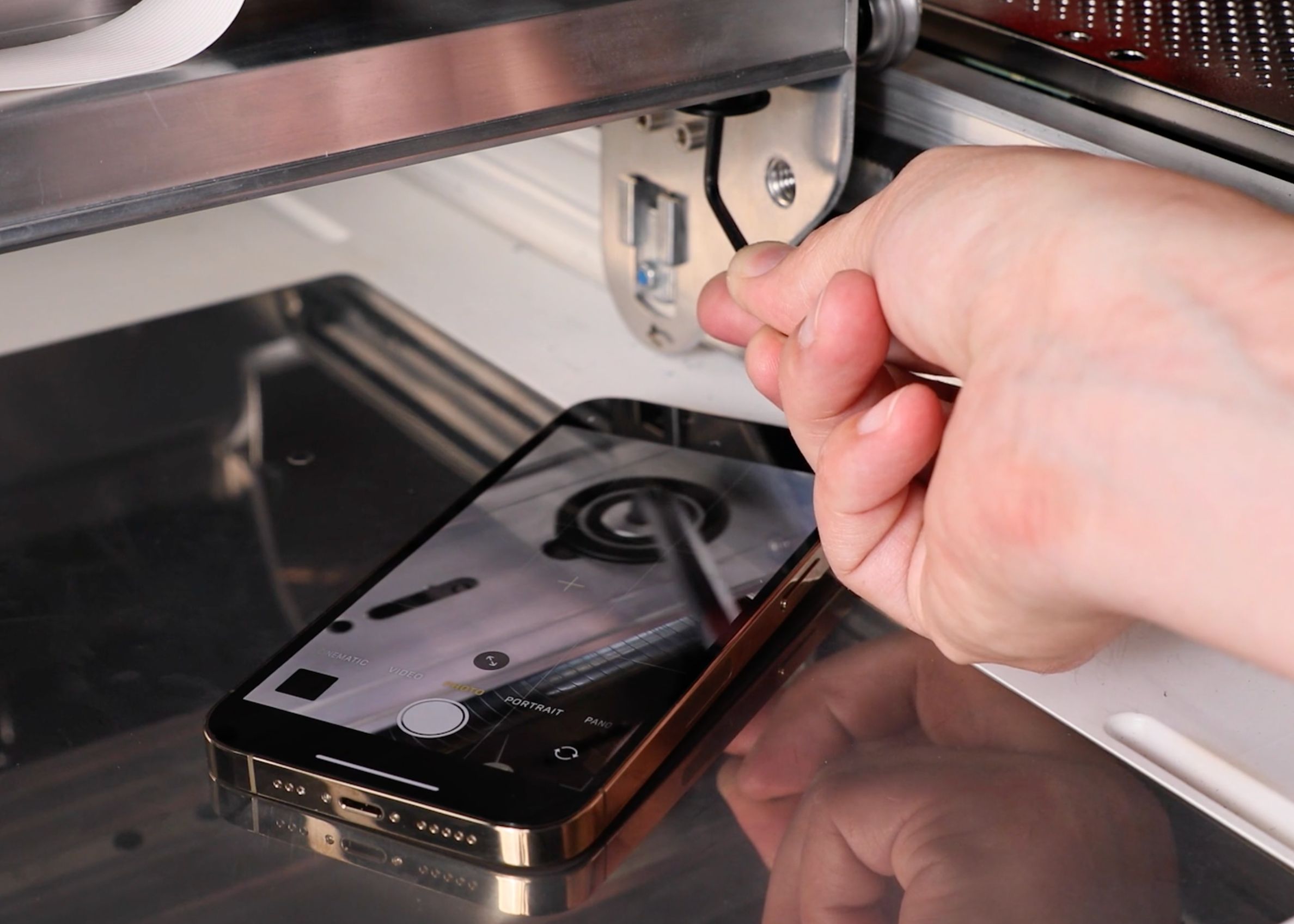

- Locate the tension pulley, underneath the laser arm on the right side of your Glowforge.
TIP: To make it easier to find, use a mirror, or the selfie mode on your mobile phone.
- Insert the short side of the 3mm hex L-key into the metal screw with the long handle of the hex key pointing toward the front of your Glowforge.

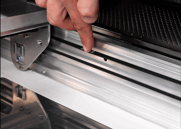

- Once you've tightened the screw fully, check the belt tension. When pressing lightly on one side of the belt, the other side should not move. If it does move, the belt is too loose.
- To further check the belt tension, gently slide the printer head back and forth along the laser arm. It should move easily and smoothly. If it feels stiff, the belt is too tight, so adjust accordingly.
- It may take a couple of tries to get the tension right. You can check the tension on the side belts to compare for correct tension. The tension on all three belts should feel about the same.
