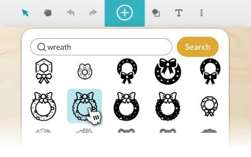

A screenshot showing using the + button and search feature to select clipart of a wreath in the Glowforge App
First we'll add some artwork. For this design, we’ll build our gift tag around a picture of a wreath.
  1. Click Import Artwork, and then search for "wreath."
  2. Find the wreath in the image above and click it.
Besides browsing the featured artwork, you can also search from more than two million images, upload your own designs, or trace hand-drawn artwork. You can also follow along with these steps to create your own design from scratch.

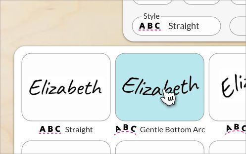

Screenshot of using the curved text feature in the Glowforge App
Next, we’ll add the customized text for your gift tag and apply one of the fun, new text styles.
  1. On the top menu bar, click Insert text.
  2. In the text box, type the name of the lucky recipient.
  3. Select the font you want from the dropdown menu. For this project, we used the font Caveat in the Handwritten collection.
  4. To add some extra pizazz, click the Style menu, and then select a style that curves the top of the text like Gentle Bottom Arc or Medium Top Scoop.
