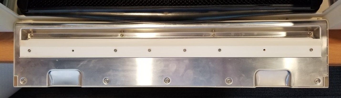

- Line up the new flap with the screw holes. The flat side should be against the door.
Image: Top-down view of Pro flap (Pro shield removed). - Replace the six screws with the T10 screwdriver, so the flap looks like the picture above.
Note: The two smaller empty holes are for the Pro shield. - If needed, install the front Pro shield. (Remember, you need to remove both front and back Pro shields before you make a passthrough print.)
