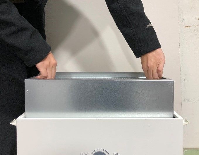

Remove and dispose of the old cartridge.
Grab and lift the metal lip to remove the filter cartridge. Dispose of it in the garbage.
Lift the filter cartridge out
Replace with a new filter cartridge.
Start by unwrapping the new filter cartridge and inspecting it for damage. Lower the new filter cartridge in the same way you removed the old one. -
