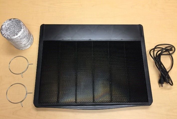

Your Glowforge printer came with an accessory pack that includes the exhaust hose and two ring clamps (shown on the left side)
To connect your Glowforge Performance Filter, start by gathering the exhaust hose and two ring clamps that came with your Glowforge. (If you want a new hose, you can purchase one in the Glowforge shop.)

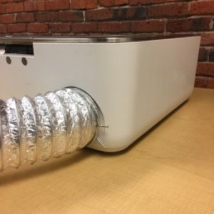

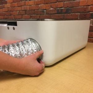

First you'll connect the hose to your Glowforge. (If you're already using an exhaust hose to vent to the outside, you can reuse that hose and skip this step since the hose is already connected to your Glowforge.)Slide the ring clamp around the silver 4-inch-diameter hose provided. Squeeze the two ends of the clamp together to fit the hose and clamp over the exhaust connection on the back of your Glowforge printer. Let go, then check that the clamp is settled over the white ring around the exhaust and will not come off with a gentle tug.

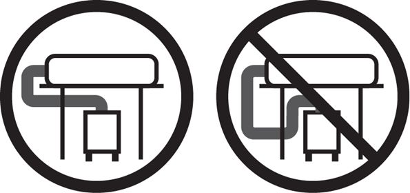

Keep the hose as straight as you can, with no more than three turns of 90 degrees or less. Make sure the hose isn’t twisted, pinched, kinked, punctured, or flattened. If there is extra hose, do not let it sag; wrap it tightly with duct tape to keep the hose length as short as possible.

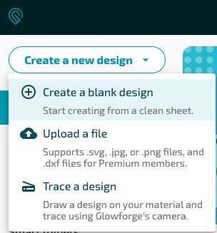

- On the Dashboard, click Create a new design, and then click Create a blank design.

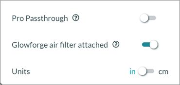

- On the top menu bar, click the three-dot More menu, and then click the gear icon, and then turn on the Glowforge air filter attached option.
That's it! You'll notice a difference in exhaust sound as the fans on your printer will now run slower to match the speed of the fan in the air filter.
