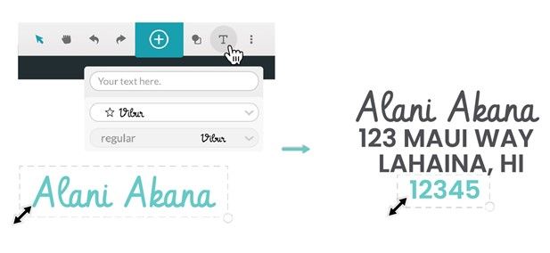

First, add the text for your address.
  1. On the top menu bar, click Insert text.
  2. In the text box, type the first line of your address.
  3. Select the font you want from the dropdown menu. For this project, we used Vibur and Poppins.
  4. If you want to add any bold or italic variations for your font, click the bottom dropdown menu and select from the options.
  5. Repeat steps 1-4 to create a text box for each line of your address.
  6. You can resize, rotate, or drag your text as you like.

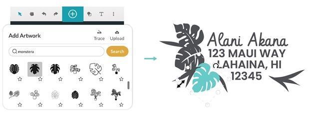

Now, let’s add some artwork to your design.
  1. On the top menu bar, click Import artwork.
  2. Search for  art you like, or click one of the featured illustrations.
    Tip: To make your design even more interesting, you can insert and overlap multiple artwork elements as we did in the example above.
  3. Resize, rotate, or move your artwork to align it and make it look great.

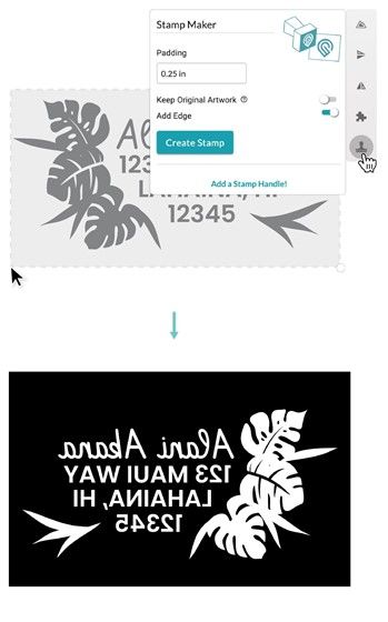

Next, it’s easy to make your design stamp-ready using Stamp Maker.
  1. Click and drag a selection box around all of your art and text elements.
  2. If you are using this stamp for the Customizable Luggage Tag catalog design, resize the artwork to fit within a 4” x 1-¾” rectangle.
  3. On the right toolbar, click the Stamp Maker button.
  4. Set the padding (the blank space around your stamp artwork) to 0.50.”
  5. Turn on the Add Edge option to add a cut border around your stamp.
  6. If you want, turn on the  Keep Original Artwork option to retain an editable version of your design.
  7. When you have the settings you want, click Create Stamp.

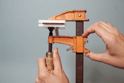

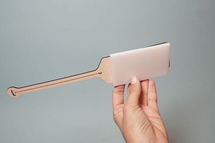

  1. First, soak your leather fully submerged in water for up to 60 seconds.
  2. Sandwich the saturated leather between the stamp and a piece of scrap material that’s about the same size. This will help to support the leather during stamping and spread the force from the clamp across the entire stamp design.
  3. Using a heavy-duty clamp, squeeze your leather and acrylic sandwich for a minimum of two hours. We’d suggest using a screw-type clamp for this job, as a squeeze clamp is unlikely to provide enough pressure.
  4. After a couple of hours, remove the clamps to reveal your custom luggage tag.
