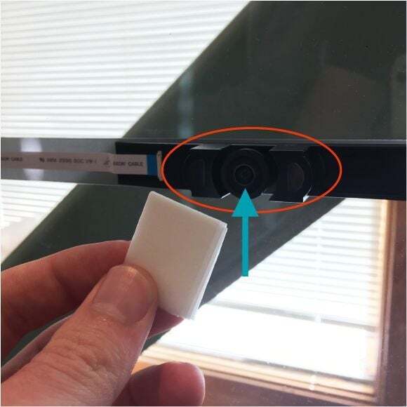

Sometimes debris and small particles can build up on the lid camera. If the workspace image in the App appears blurry or hazy, cleaning the lid camera can help your Glowforge properly detect the Proofgrade material.
To clean your lid camera:
- Turn off your Glowforge.
- Using a Zeiss wipe, gently wipe the lens of the camera on the lid camera.
- Place a piece of Proofgrade material in the bed with the QR code facing up.
- Close the lid and turn your Glowforge back on.
- Open any design in the Glowforge app to test if the material is detected. If the material is still not detected, try the next step.
