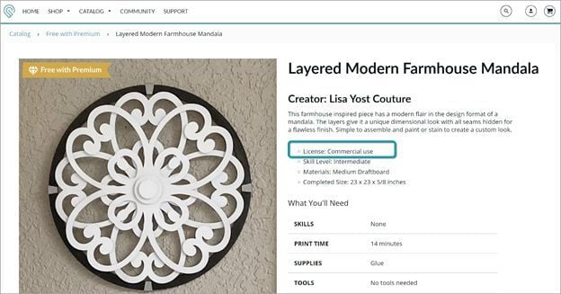

Commercial Use
Some Catalog designs are marked for commercial use. That means you can print them and sell the finished product! You can also change and customize these designs. To learn whether a design is licensed for commercial or personal use, click the design in the Catalog. The license information is in the description.
You cannot sell or use for commercial purposes designs that are licensed only for personal use.

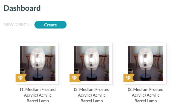

More complex designs may require different materials or multiple sheets of material. These will show in your Dashboard as separate prints. Just print them in order and follow the instructions in the design details window.
For example, this Acrylic Barrel Lamp is three different prints:
