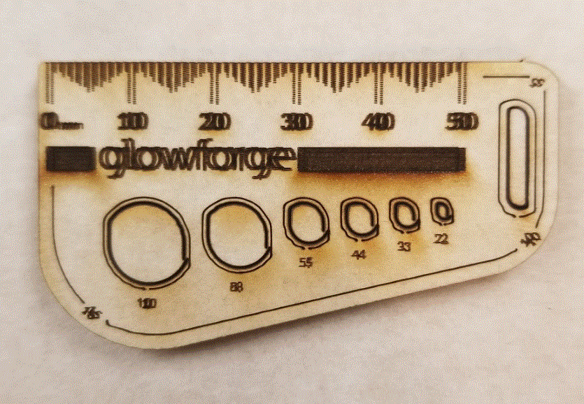

A distorted print, the lines are wobbly and there is a double-image
An example of a distorted print

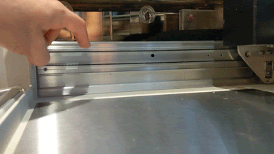

We're going to check three belts: two in the printer bed and one under the laser arm. They should all fit snugly around the pulleys. When you push on one side of the belt, the other side shouldn't move; however, the belts shouldn't be so tight as to restrict movement of the carriage plate or laser arm.
Here's how to check them.
  1. Turn off your Glowforge.
  2. Open the lid, lower the front door, and remove the crumb tray.
  3. Using both hands, gently move the laser arm to the center of the bed.
  4. With the laser arm pushed all the way in the back of the printer, press each side belt on the top.
  5. If you see any sagging or if it feels loose, adjust the side belt tension until it matches the tension in the image below. (It may take a few tries to get it right.)

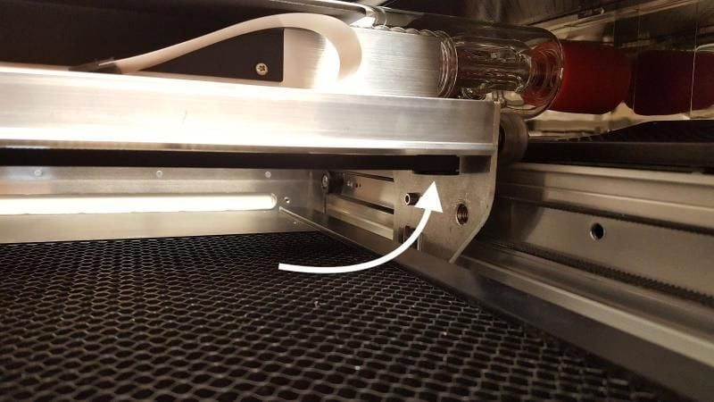

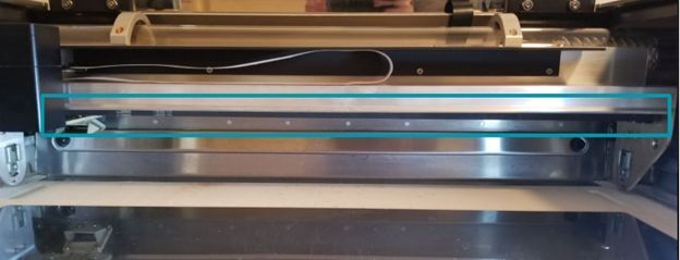

  6. Next, check the carriage plate belt. This belt is underneath the laser tube and moves the carriage plate under the printer head. With the front door of the printer still lowered, move the printer head all the way to the left. The belt is the black rubber piece directly under the metal laser arm.
    The Glowforge laser arm, viewed from the front.
  7. The belt should be straight across with no curve or twists, as in the image above. If it seems loose, adjust the tension, following the steps in Adjust the Carriage Plate Belt Tension.

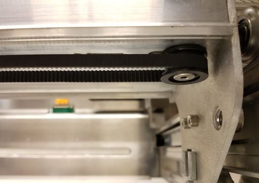

      1. Remove the belt from the laser arm by placing your thumb between the belt and the laser arm, near the pulley. Now, push down on the belt while sliding the belt to the right towards the pulley. The belt will slide off of the pulley.
        Closeup of the idler pulley on the underside of the right-hand side of a Glowforge laser arm

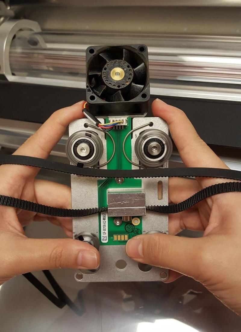

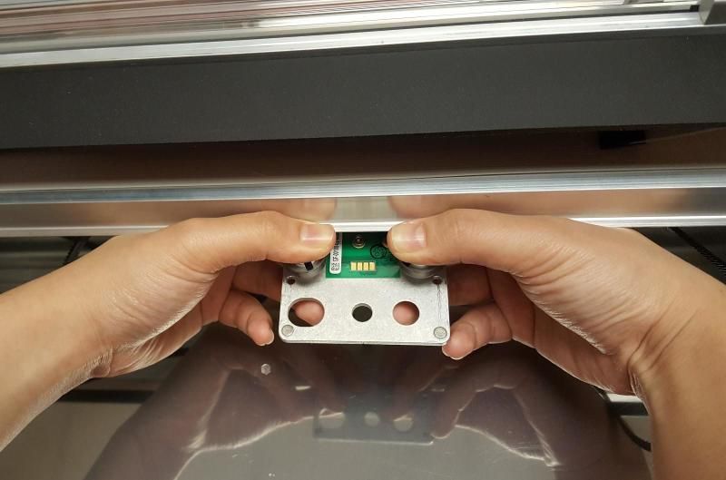

      2. Next, place your thumbs on the top of the front wheels of the carriage plate. Support the base of the carriage plate and gently pull it towards you.
      3. Once the front wheels clear the laser arm, gently pull the carriage plate downwards and to the back. It will detach from the laser arm.
        Two hands gripping the carriage plate under the Glowforge laser arm

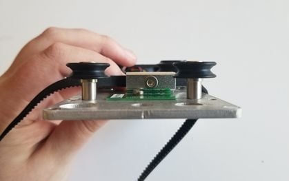

      4. Inspect the tops of the v-wheels for cracks or other damage. The surface of each wheel should be smooth and round.
        A carriage plate removed from the Glowforge. 4 wheels are visible.
      5. Check the sides of all four wheels for cracks or any other damage. If anything looks damaged, send a photo to Glowforge Support and we can help with replacement parts.
        Carriage plate wheels viewed from the side. The v-grooves in the wheels are clean and undamaged.

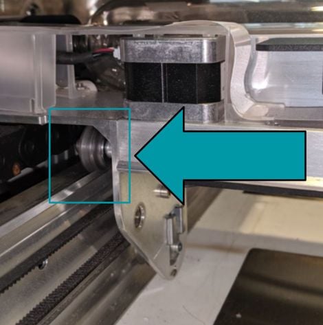

      6. Look to the right side of the laser arm. The pulley on the underside keeps tension on the belt. The pulley should be smooth with no cracks, with the top flush against the bottom of the laser arm. If you see the metal bearing of the pulley between the black plastic and the laser arm then the pulley should be replaced.
        An arrow pointing to the idler pulley under the right side of the laser arm
