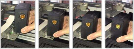

- Position the laser arm and metal plate by gently sliding the metal plate on the laser arm all the way to the right, then push the arm to the back of the unit.
- Remove the printer head: Holding only the finished black surfaces, grasp the printer head as shown. Pull gently up and back to disengage the magnets and remove the head.

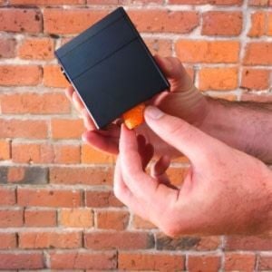

- Carefully pick up the replacement printer head
To keep the optical components clean, do not touch any part of the printer head that is not flat-black metal. If you touch any other surface, use lens wipes to remove any fingerprints. Remove the printer head from the white foam tray and remove the orange foam cylinder from inside the head.

- Attach the printer head
As shown, lower the printer head over the metal plate so that it rests next to the two round posts. Then push it gently away from you – you’ll feel a click as magnets pull the printer head until it sits snugly atop the metal plate.

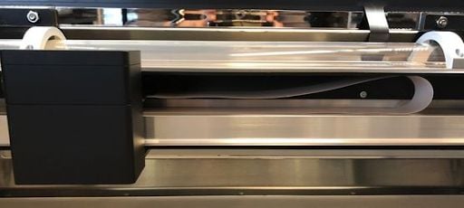

- Make sure that the head slides freely, and move it to the center
Using both hands, gently move the laser arm to the center of the bed.
Gently slide the head all the way to the left, then right. If it doesn’t slide easily, make sure that the ribbon cable is a simple loop with no twists, as shown.
