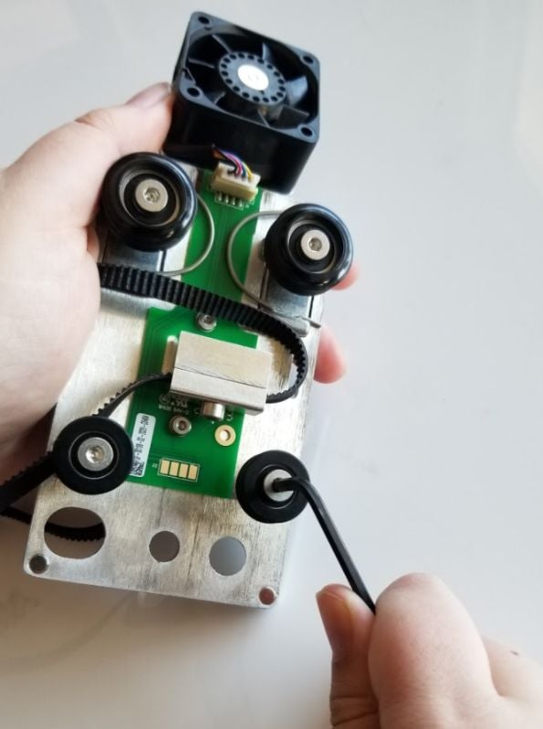

To install the new v-wheel, you will need a 3mm hex key, as shown below.
- Turn off and unplug your Glowforge.
- Disconnect the printer head and remove the carriage plate from your Glowforge.
For instructions, visit the Cleaning Your Air Assist Fan article, and follow the steps in these three sections: Remove the Printer Head (Steps 1-3), Unhook the Driver Belt (Steps 1-4), Remove the Carriage Plate (Steps 1-3). - Insert the end of the hex key into the screw with the damaged wheel. Turn it counter-clockwise to unscrew the wheel from the plate.

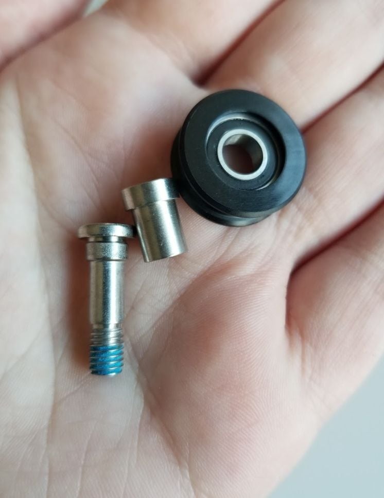

- Remove the damaged wheel, screw, and metal spacer. Keep the metal screw and spacer for the new wheel.

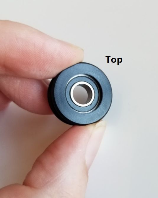

- Identify the top of the new wheel. It will be side with no markings.

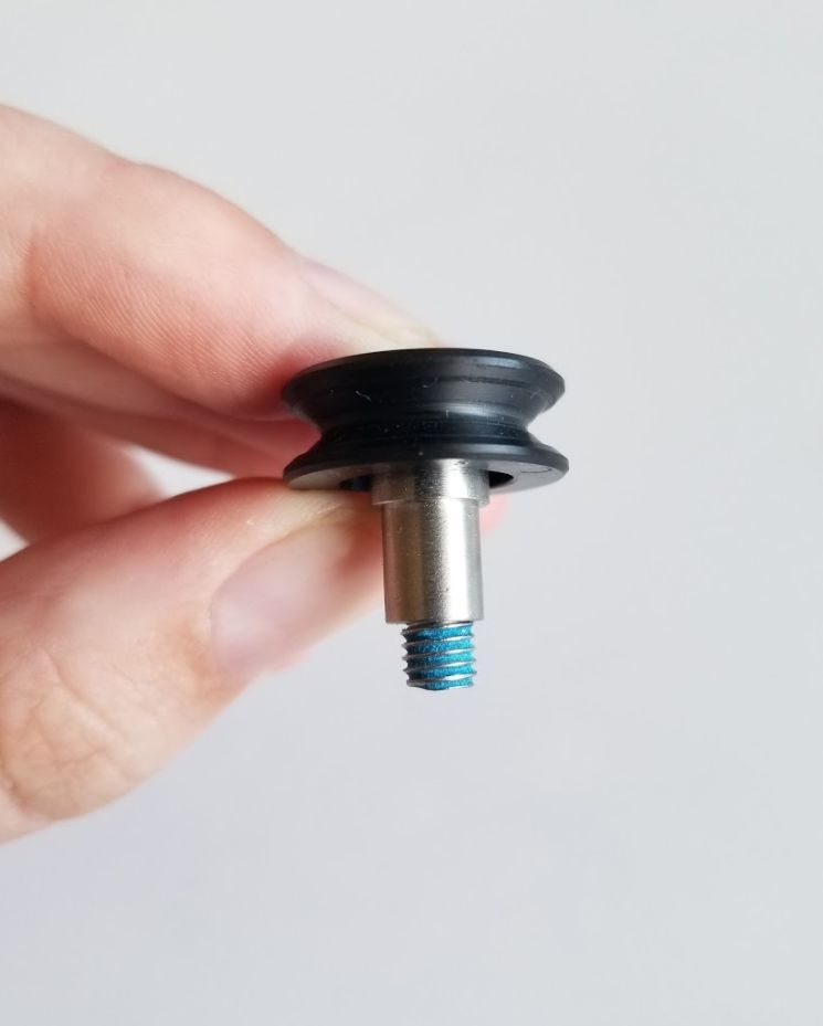

- Insert the screw into the wheel from the top.
- Slide the spacer onto the screw below the wheel. The spacer for the small wheel has a larger end. That end will be against the wheel.
- Turning clockwise with the hex key, screw the wheel to the carriage plate and make sure it is snug.
