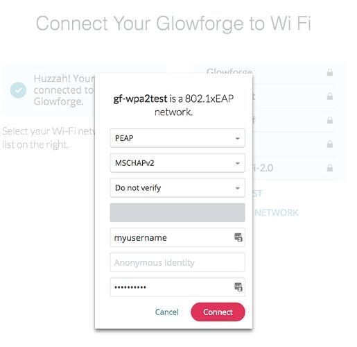

5. Connect Your Glowforge to Wi-Fi
Follow the instructions on screen to connect your Glowforge to Wi-Fi, making sure to select your Enterprise network. The instructions on screen will vary depending on your network - the picture below is an example.
Screenshot from the Glowforge App showing a window for connecting to an enterprise network
Having trouble connecting to your Enterprise Wi-Fi network?
Please note that your network needs to use one of the following authentication methods supported by our Enterprise Wi-Fi update:
  • EAP-PEAP
  • EAP-PEAP/MSCHAPv2
  • EAP-TTLS/PAP
  • EAP-TTLS/CHAP
  • EAP-TTLS/MSCHAP
  • EAP-TTLS/MSCHAPv2
Our Enterprise WiFi support is still in beta, so the support team can’t help with troubleshooting yet, but if you still need help getting set up on an Enterprise network please reach out in our community topic here.

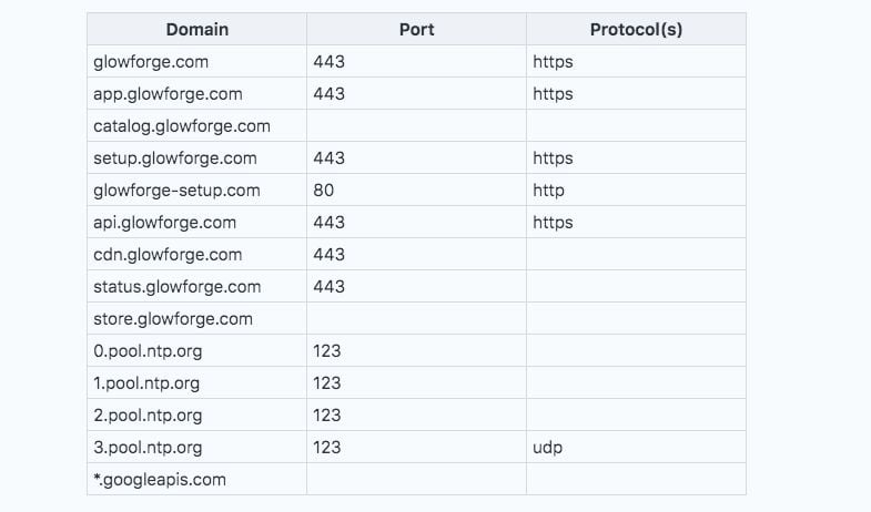

Port Information
Your Glowforge communicates with Glowforge servers and external services via http, udp, and websockets, on ports 443 and 123. Your internet connection will need to be able to access the following URLs:
A table showing ports & URLs that need to be opened for a Glowforge to function.

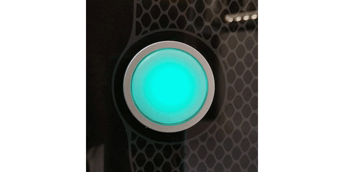

  3. Press and hold the Glowforge button. The button will glow teal and eventually blink teal
    Animated image showing the Glowforge button glowing teal and then blinking teal
  4. Release the button when it begins to blink teal.

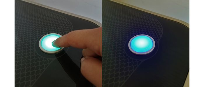

  5. Press and hold the blinking teal button again until the button begins to blink blue.
    A finger holding down the Glowforge button when teal, and then the button turning blue after being released

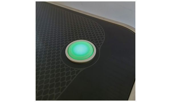

  6. The button will eventually turn solid green on its own, and your Glowforge will reboot automatically. Please contact us if the button does not turn solid green.
    The Glowforge button glowing green
