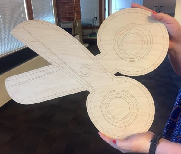

Pro Passthrough software makes it easy to print really big designs that wouldn't otherwise fit in the 11” (27.9 cm) x 19.5" (49.5 cm) workspace. The Pro Passthrough slot in the front and back allow for materials that are 20” (50.8 cm) wide, up to ¼” (0.6 cm) thick, and as long as you want.
That means you can create huge, dramatic products like furniture or giant scissors!
A large, lasercut illustration of scissors

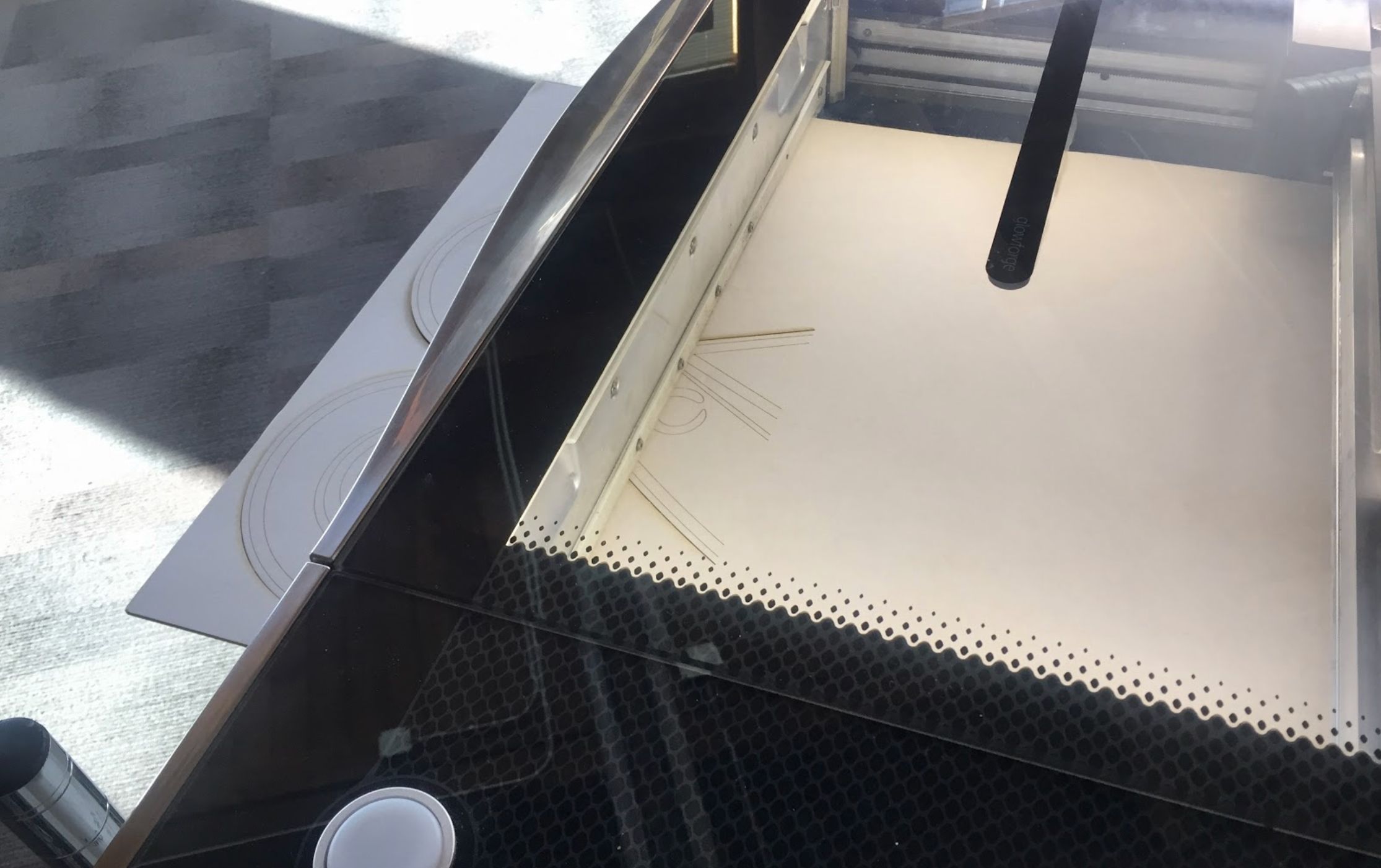

    Load your Proofgrade® material from the back of your printer toward the front.
    • Follow these instructions to remove your Pro Shields.
    • For most prints, slide the material until the bottom edge is touching the front of your printer. Excess material should extend past the back of your printer.
    • For thin material, it can help to slide in a piece of thicker material like hardwood first, then put your material on top, and then take the hardwood out.
    • A long piece of material can sometimes get tilted up or down, so use a stand to hold the material in place. Make sure the stand is secure, and be careful not to bump into it.
    • Load your material straight at the start, or else your design might eventually veer off the edge.
      A Glowforge Pro with material inserted through the rear Pro Passthrough slot

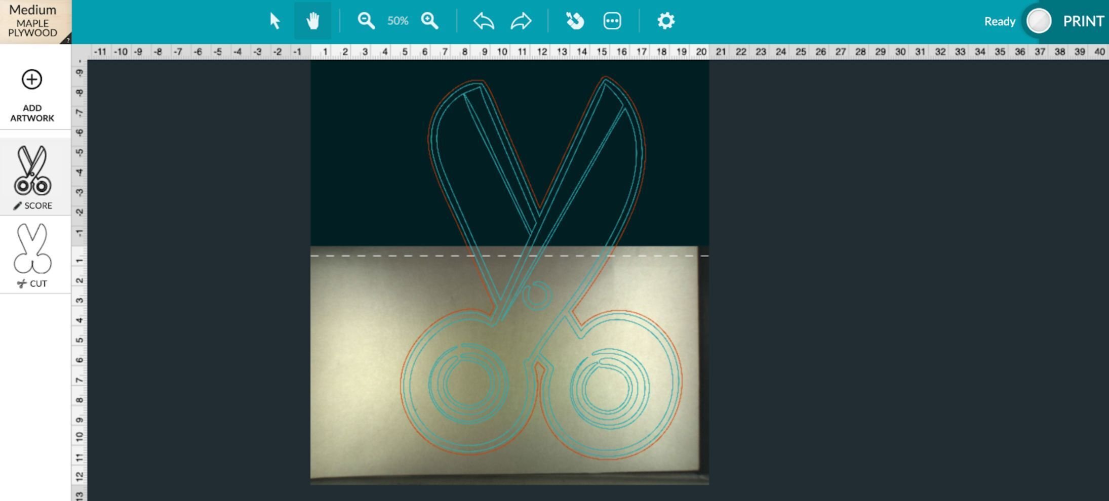

    Once you've selected Pro Passthrough, you’ll see a zoomed-out image of the bed with a dashed line.
  4. Line up your design
    • Get a new bed image by opening and closing the lid or selecting Refresh bed image under the gear menu. Move your design into place.
    • Since Pro Passthrough works from the bottom of the design to the top, align the bottom portion of your design along the bottom edge of the material (close to the front of your Glowforge).
      • Make sure the design does not hang off the left, right, or bottom margins.
      • Add, move, and resize artwork as you wish.
      • Note: The dashed line is the cutoff for the first print - anything above the dashed line will not be included in the first print. The black area above the dashed line illustrates the extension of your material.
        Screenshot of a scissor illustration design, with roughly half the design above a horizontal, dashed line in the Glowforge App

  1. Shift your material
    When prompted, slide the material toward the front of your printer so that there are at least 3 in (7.6 cm) of the previous print still on the bed. You can lift the lid during this step.Material that has been moved through the Glowforge Pro, with the already printed portion now sticking out of the front Pro Passthrough slot.
