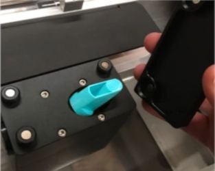

- Power off your Glowforge and open the lid.
- Holding only the finished black surfaces, grasp the printer head as shown. Pull gently up and back to disengage the magnets and remove the head.

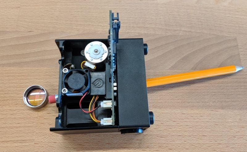

- Push down on the small tab in the center of the wire ribbon to release the wire ribbon, and gently pull the wire ribbon plug from the printer head.
- The top of the printer head is held on by strong magnets. Grasping only the top, pull up carefully to remove it and set it aside.
- Gently pick up the mirror and set it aside.

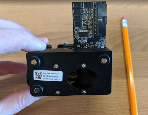

- Set the print head down, and tip it slightly toward you.
Starting at the top of the head, where you just removed the mirror, use the eraser end of a pencil to gently push the lens out of the bottom of the print head.
- You've successfully removed the lens.
