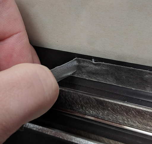

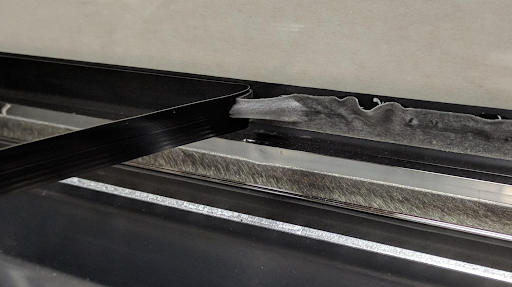

4. Remove the Old Cable from the Lid
Once all three ends are disconnected, peel the cable off of the lid.
Peel the Old Cable Off the Lid
5. Remove the Remaining Adhesive

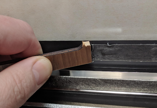

This may take a few minutes. We’ve found using a piece of Proofgrade scrap to be useful in scraping away the adhesive. Wipe the surface clean with a dry cloth. The surface does not need to be perfectly clean for the new cable to adhere properly.
Remove the Adhesive 1
Remove the Adhesive 2

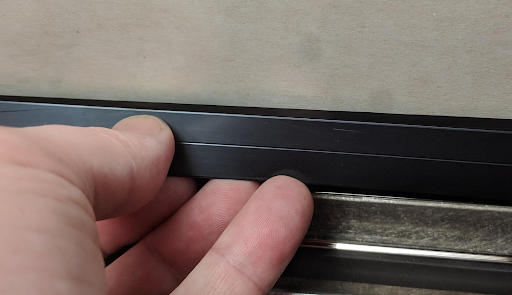

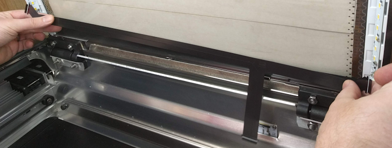

6. Determine the Location of the New Cable
Don’t remove the adhesive backing yet! Determine the location first!
The top of the cable should be about 1/8 inch below the black paint on the lid glass.

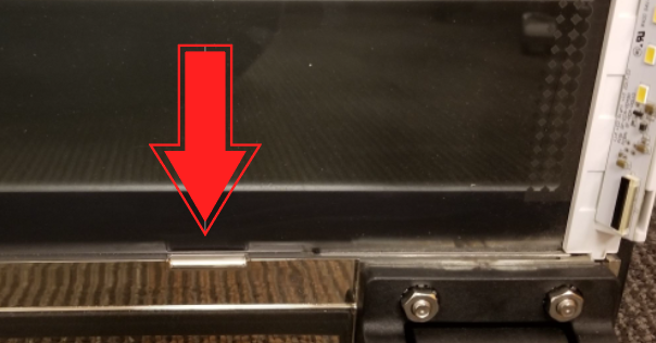

7. Locate the Flat Notch on the Lid
Locate the flat notch in the metal case. The black cable should cross at that point, slightly more left than right of center.
Locate the Notch in the Lid
Correct Placement in Lid Notch

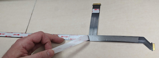

8. Remove Long Adhesive Strip from New Cable
Take your time. Once you're confident on placement: proceed by removing the long strip of backing (but leave the small square on for now).
Remove the Long Strip of Adhesive Backing

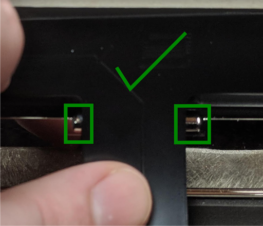

9. Apply the New Cable to the Lid
Holding on the edges, carefully apply the cable into the position you just planned, remembering that the top of the cable should be about 1/8 inch below the black paint on the lid glass.
Start by sticking the cable down where the vertical part of the cable is positioned across the flat notch, and then smooth outwards to the right and left.
Apply the Cable to the Lid

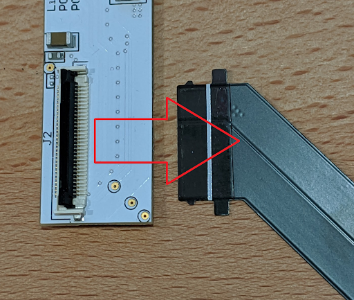

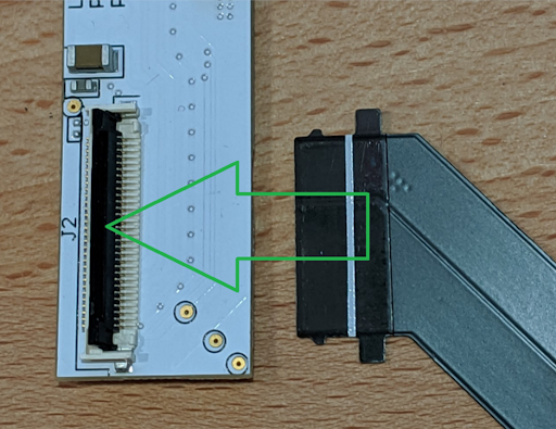

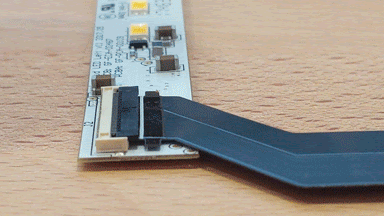

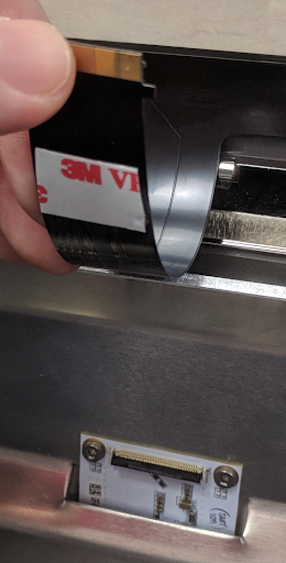

10. Connect the Left End of the Cable

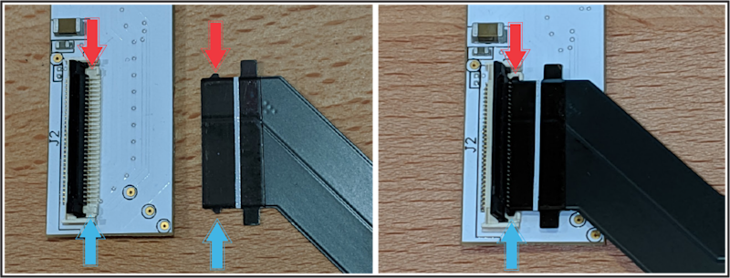

Carefully connect the connector on the left side. Take your time to avoid damage to your Glowforge or the cable.
Insert the end of the cable into the slot as straight as possible. Do not insert the end in at an angle.
Insert the End of the Cable Straight into the Connector
Insert the End of the Cable Straight into the Slot 2

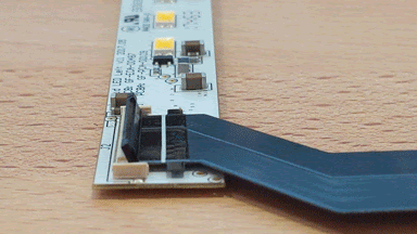

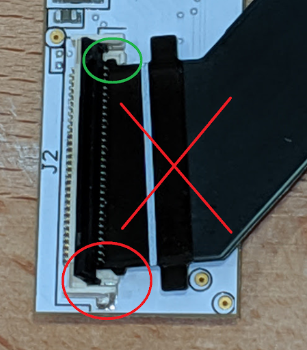

11. Check For Correct Installation of Left Side
Make sure the small black tabs fit into their groove in the connector.
Check End of Cable

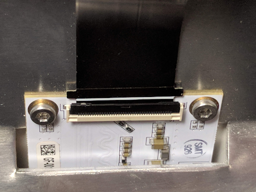

12. Secure the End of the Cable
Close the connector gently, like a hinge.
Repeat steps 10-12 for the connector on the right side.
Close the Clip like a Hinge

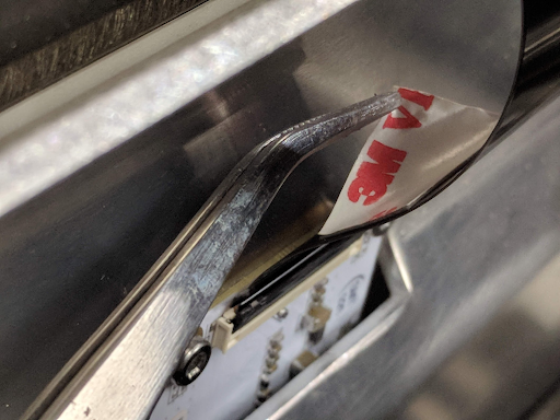

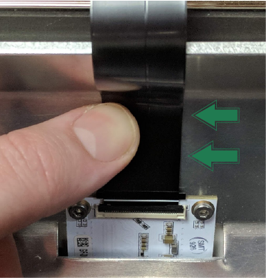

14. Remove Small Adhesive Strip
Once the clip is connected, carefully reach in, and remove the backing. Tweezers make this easier, as shown.
Press and rub just above the clip, as indicated by the green arrows.
Press in Cable
15. Check the Installation
Check your work: Look again at each clip to be sure they match the photos of properly closed clips. Make any necessary adjustments.
