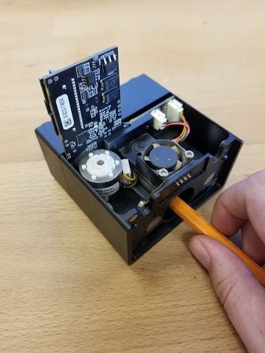

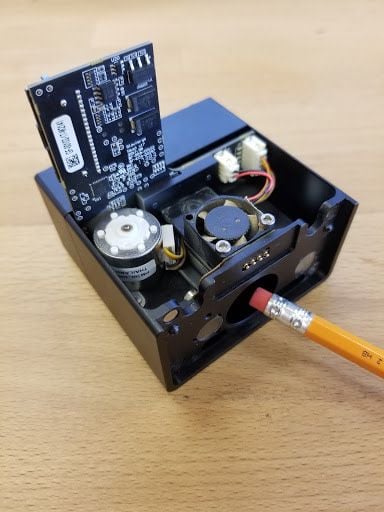

- Turn the printer head over so you are looking at the bottom of it.

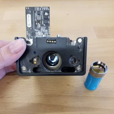

- Starting at the bottom of the printer head, use the eraser end of a pencil to gently push the mirror out of the top.
If the mirror has been damaged (for example, if the plastic handle has been melted), please check the print head interior for additional damage. If everything looks as expected, you can purchase a replacement printer head mirror through the shop.
