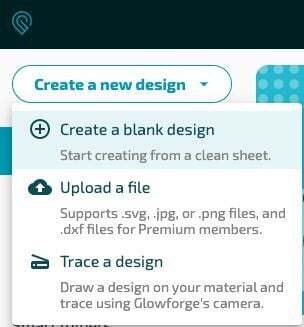

Sign into the Glowforge App (https://app.glowforge.com).
On the Dashboard, click Create, and then click New Blank Design.
Click the three-dots More menu.
If you are using a Glowforge Performance Filter, turn on the Glowforge air filter attached option.
If you are venting to the outdoors, make sure the option is turned off.

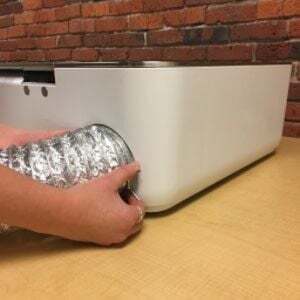

Vacuum your exhaust connection and hose
- Remove hose from printer
Squeeze the two ends of the ring clamp together, then pull the clamp and the hose away from your Glowforge. - Vacuum exhaust connections
Use a vacuum to remove dust and debris from the exhaust connection and your outdoor exhaust vent. - Vacuum or replace exhaust hose
Replace your hose, or use a vacuum to remove dust and debris from the hose. The exhaust is a standard 4" exhaust vent, similar to what one would use with a clothes dryer. You can see it here.

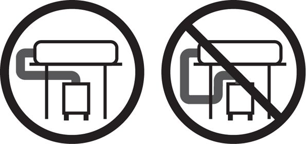

- Confirm the hose has no more than two 90-degree turns if you vent to the outdoors, and three if you're using a Performance Filter.

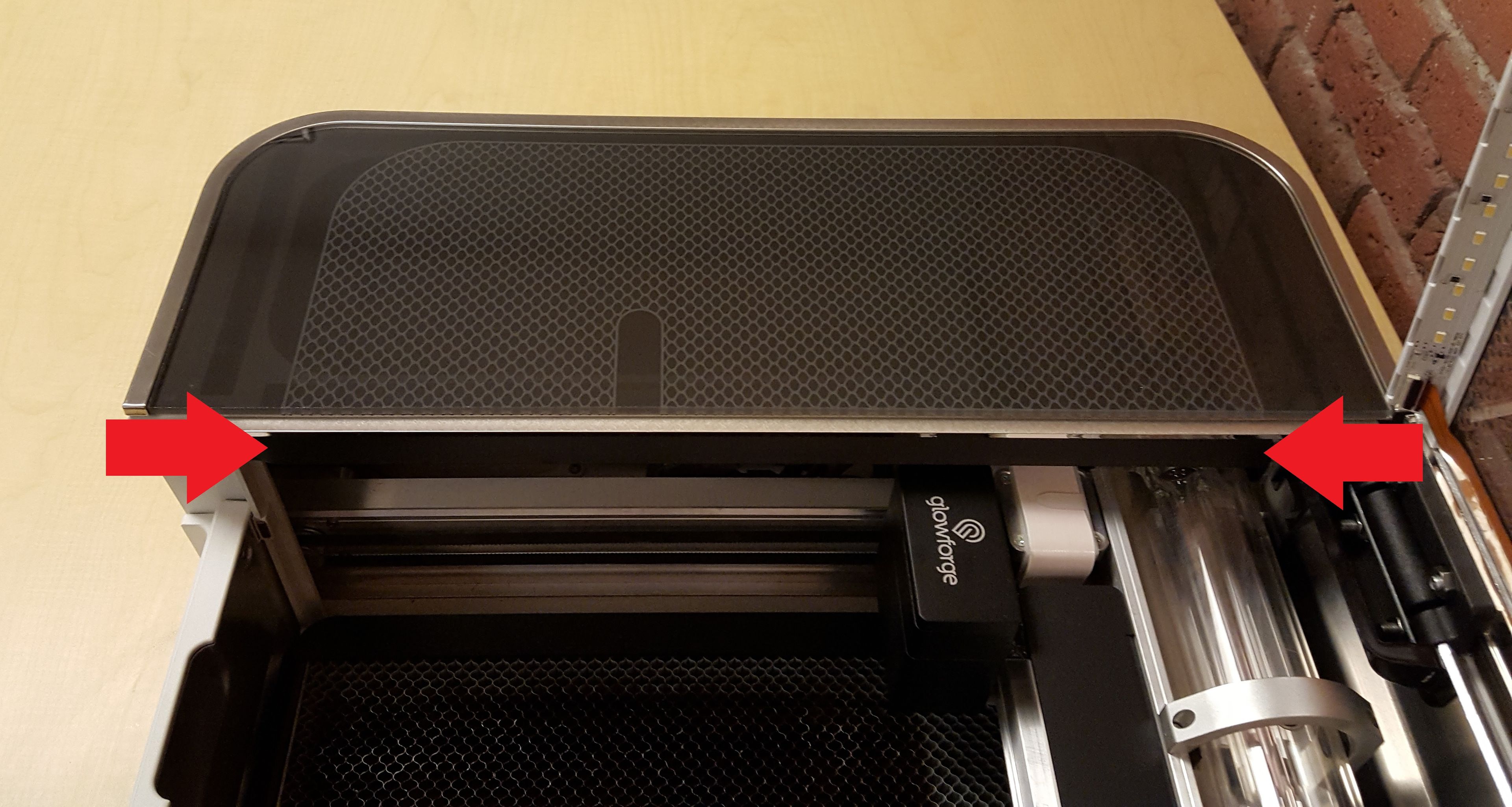

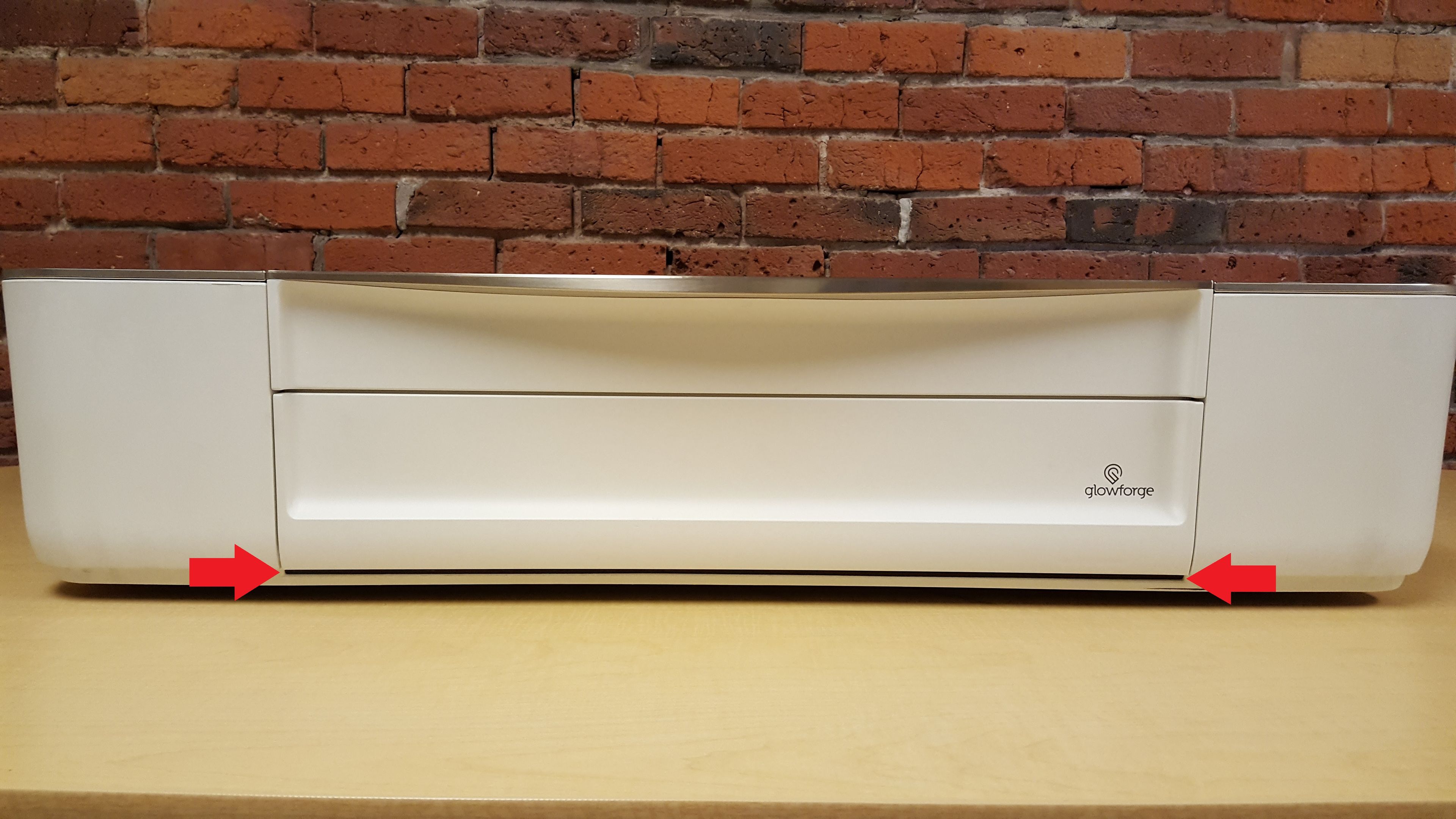

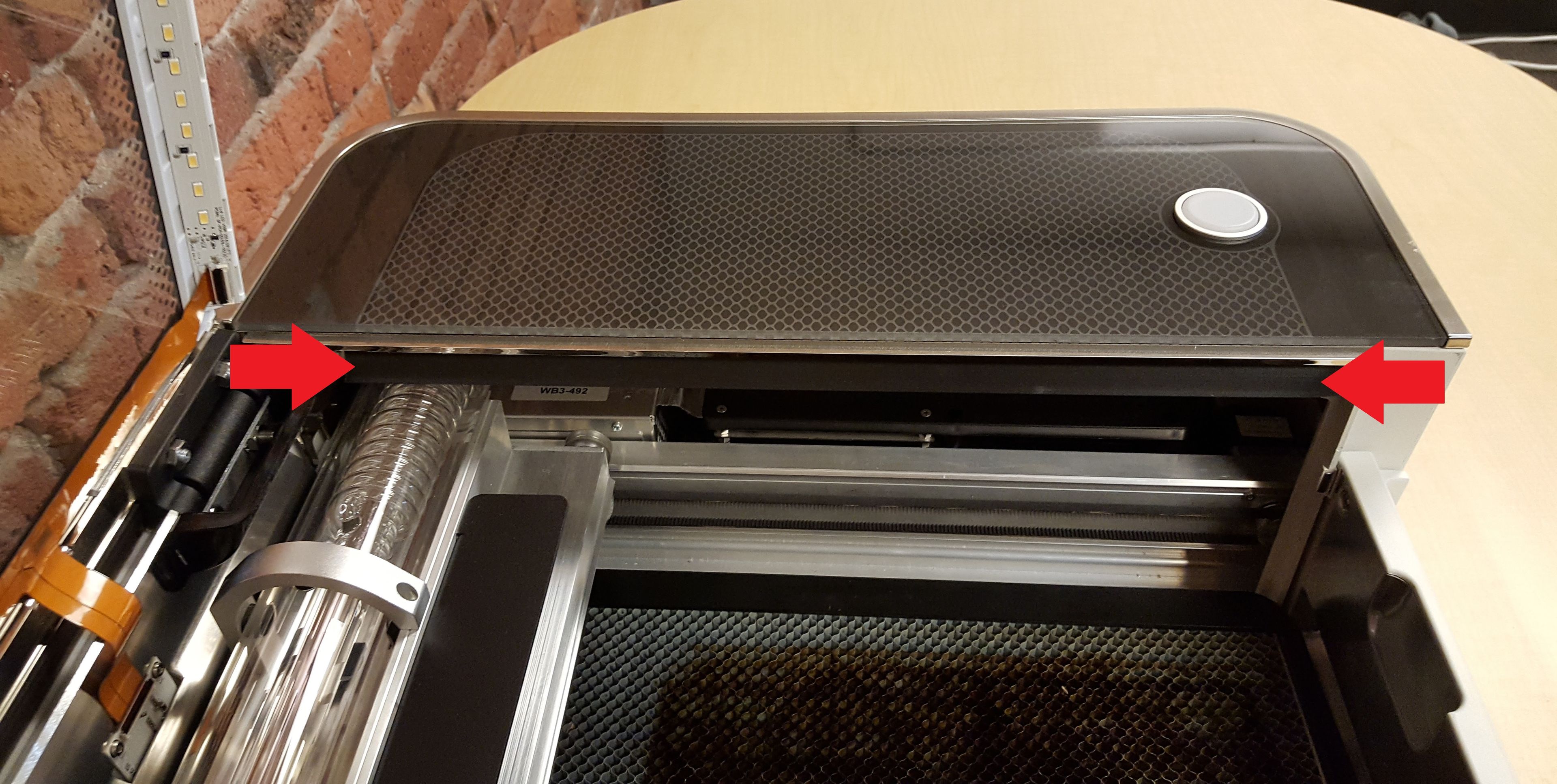

Check the seals on the printer
Verify that the seals around the lid and door of the printer are intact.

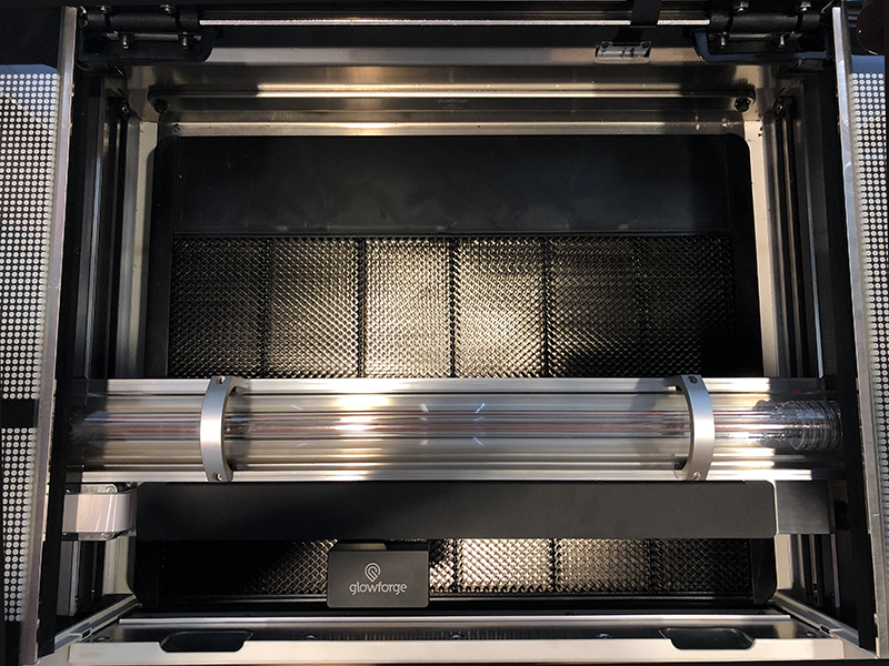

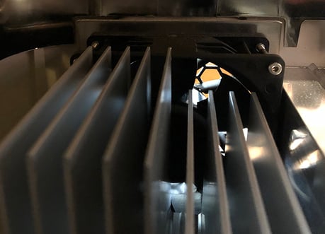

- The exhaust fan from the inside of the unit. To capture this photo:
- Turn your Glowforge off.
- Open the lid.

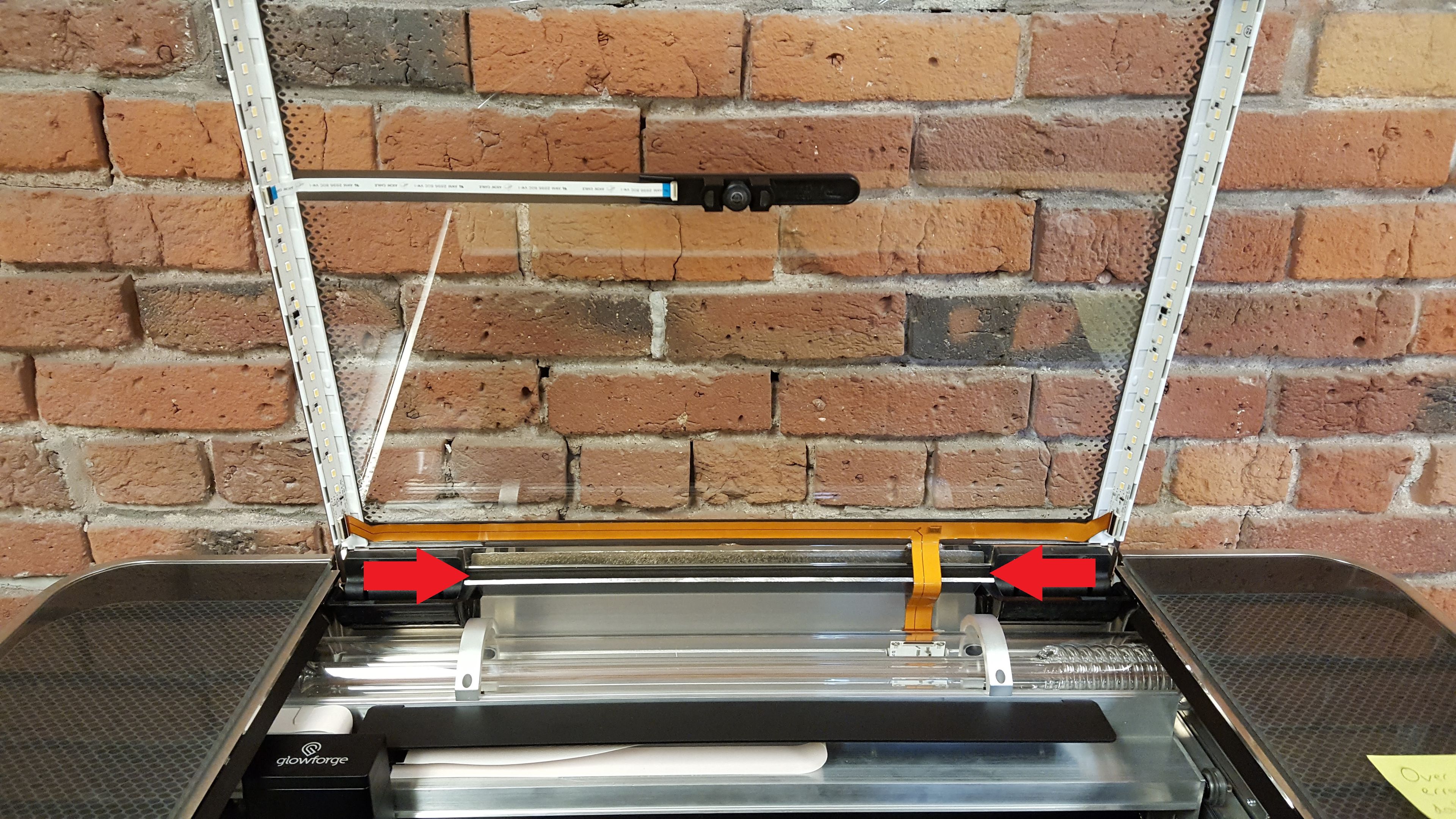

- Using both hands, gently pull the printer arm towards you as shown below:
- Aim your phone or camera inside the Glowforge on the left-hand side, past the metal rail, pointed away from you towards the exhaust hose. The photo should look like this:

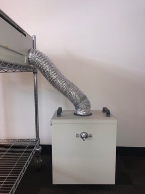

- Photos of (1) your exhaust hose attached to the Glowforge, (2) where the hose exits the room if venting outside, or where it connects to your Performance Filter, and (3) the path your exhaust hose takes from your Glowforge to the exterior vent or Performance Filter:
