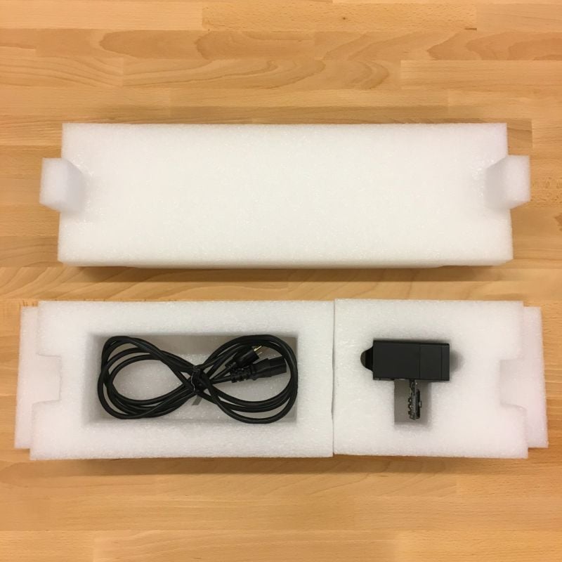

  5. Place the printer head and power cord in the foam block
    Remove all the packaging pieces stored in the white rear foam block. Gently lay the printer head and power cord into the foam as pictured.
    Note: Do not return power cord during a repair or warranty replacement.
    The Glowforge print head and power cord placed into their protective foam for transport

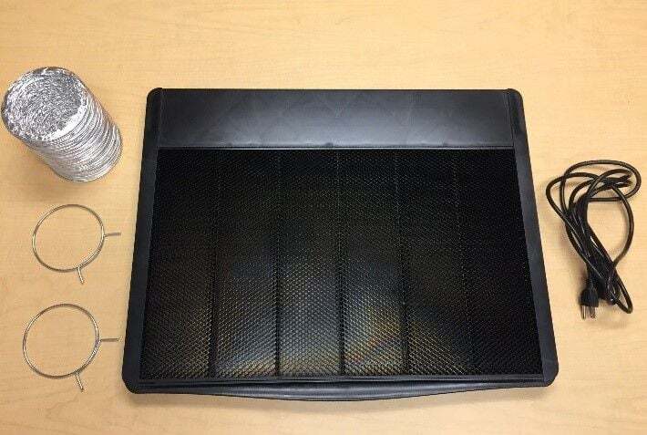

  4. Remove the exhaust hose
    Squeeze the ends of the ring clamp together and pull it and the hose off the exhaust vent with a gentle tug.
    Two hands disconnecting the exhaust hose from the back of a Glowforge
  5. Pack the accessory box
    Place the crumb tray, exhaust vent, and lens tool in your Glowforge accessory pack box.
    An exhaust hose, two ring clamps, a Glowforge crumb tray and a power supply cord

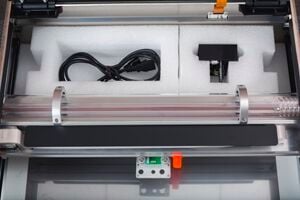

  4. Insert the rear foam block
    With the lid removed, insert the foam block containing the printer head and power cord into your Glowforge. The bottom will lay flat against the floor of your printer.
    A Glowforge with its lid open and the rear protective foam inserted into the bed

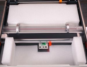

  6. Insert the rear foam lid and front foam block
    Place the lid of the rear foam block, covering the printer head and power cord. Place the final foam block in the front of your printer and close the front door.
    A Glowforge with its lid open and both the front and back protective foam blocks inserted into the bed.
