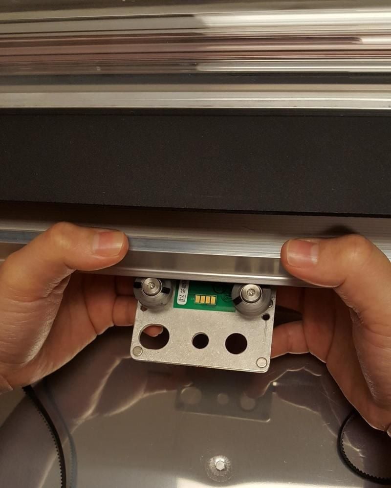

Grasp the carriage plate as shown
Place both index fingers on the rear corners of the plate and both thumbs on top of the front wheels. Use your other fingers to support the plate.
Pull the plate toward you
While keeping the laser arm stable with your thumbs, use your index fingers to pull the plate towards you as far as it will go.
Push the plate down and back to disengage
Push down with your thumbs to angle the plate down and toward the back of the Glowforge until the plate pops off of the laser arm.

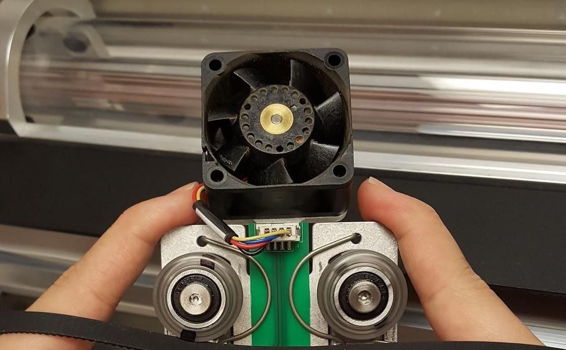

See the black plastic fan on the underside of the carriage plate? This is the air assist fan.
You can clear debris or build-up with a can of compressed air.
If the fan is damaged, has build-up that can't be removed, or doesn't spin freely, we recommend replacing it. The fan is part of the carriage plate assembly, which is available in our shop here.
