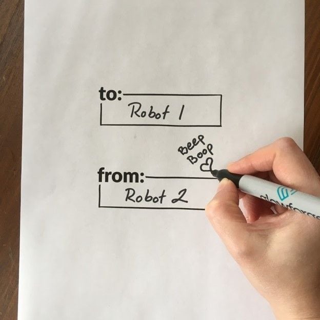

  1. The Artist Draw a picture with a black marker on a white piece of paper. Stay away from the edges so there’s some white on every side of your drawing. Tip: Leave room for the handle in the middle of your drawing.
  2. The Poet Using a black marker, write a favorite quote or song lyric, or sign your name on a blank white piece of paper.
  3. The Good Friend Print this template out on an paper printer (not your Glowforge!) and use a black marker to fill in the blanks.
  4. The Shadow Master Grab something nearby: a shoe, a leaf, a doll, your other hand - and plunk it on a blank white piece of paper. Trace around the edges with a black marker.
We’ll use The Good Friend option for our example:

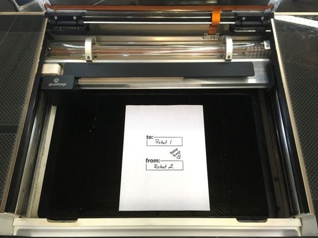

  3. Lift the lid of your Glowforge, place your artwork in the center of the printer bed, and close the lid.
    A piece of paper with hand-written lettering placed in the center of the Glowforge print bed

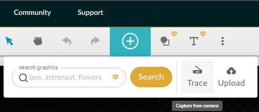

4. In the middle of the app, click the + button, and then click Trace.
Screenshot of the + and trace buttons in the Glowforge App

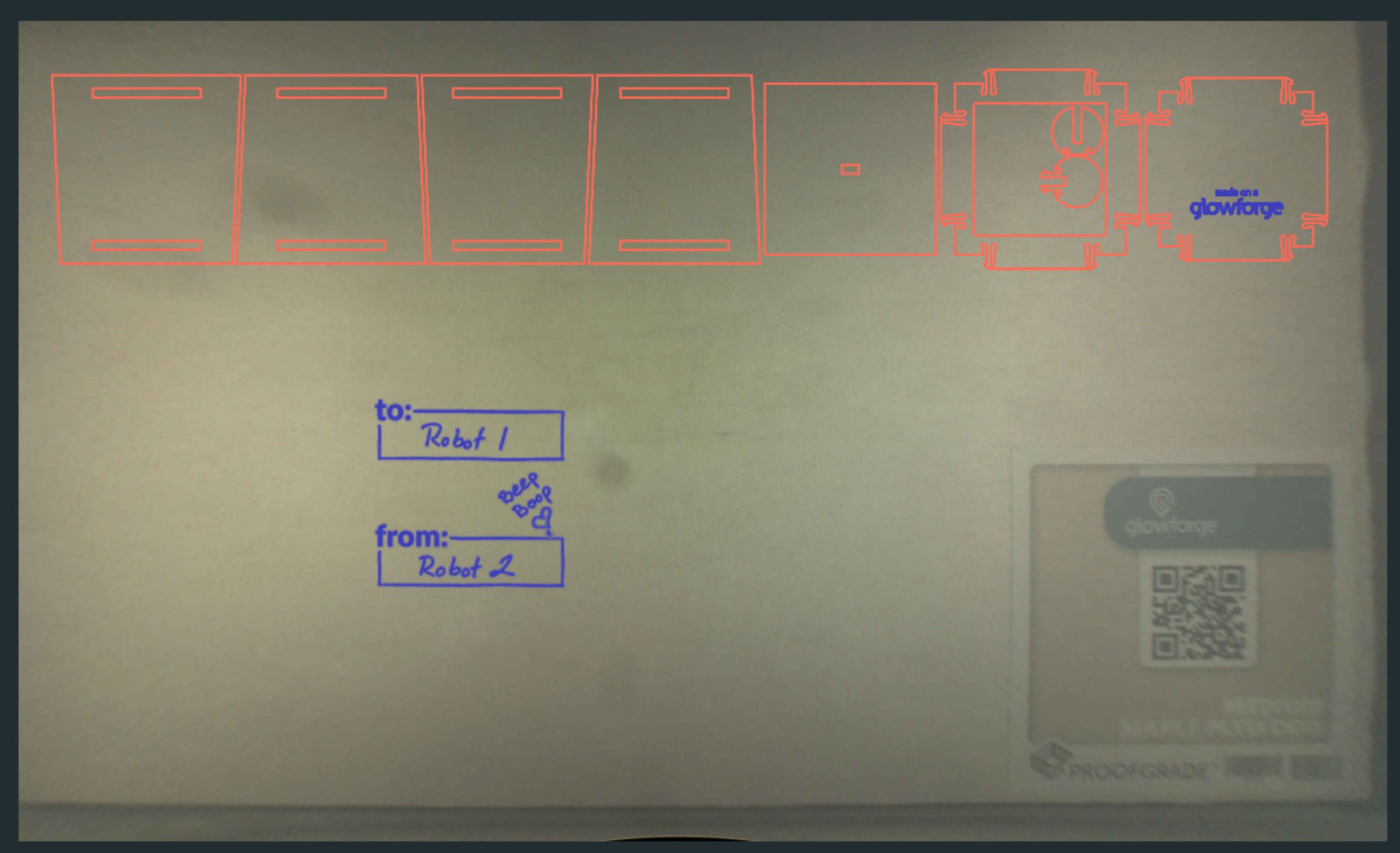

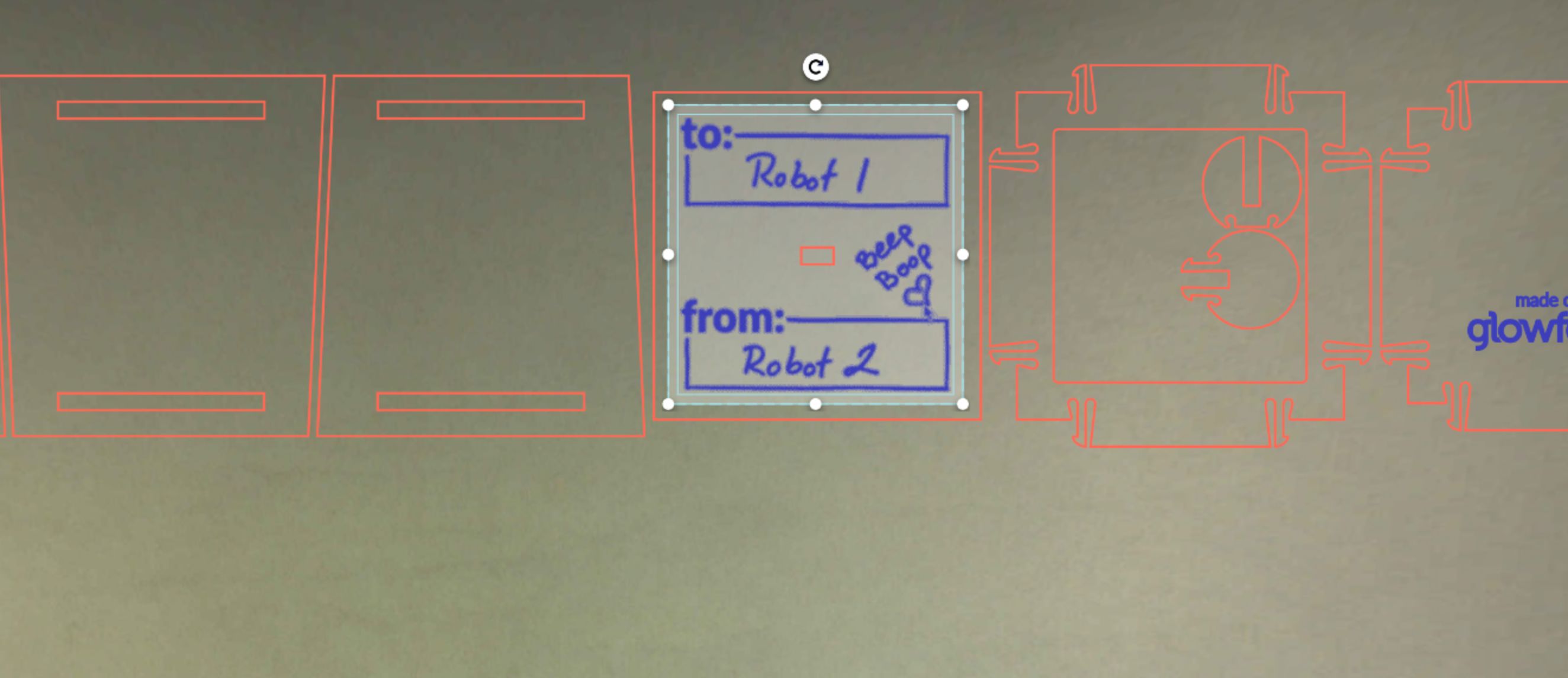

5. In the app, when the workspace loads, you'll see the box design and a picture of the bed of your Glowforge, including your drawing.
Screenshot showing the print area of the Glowforge, with material loaded and traced artwork in the workspace

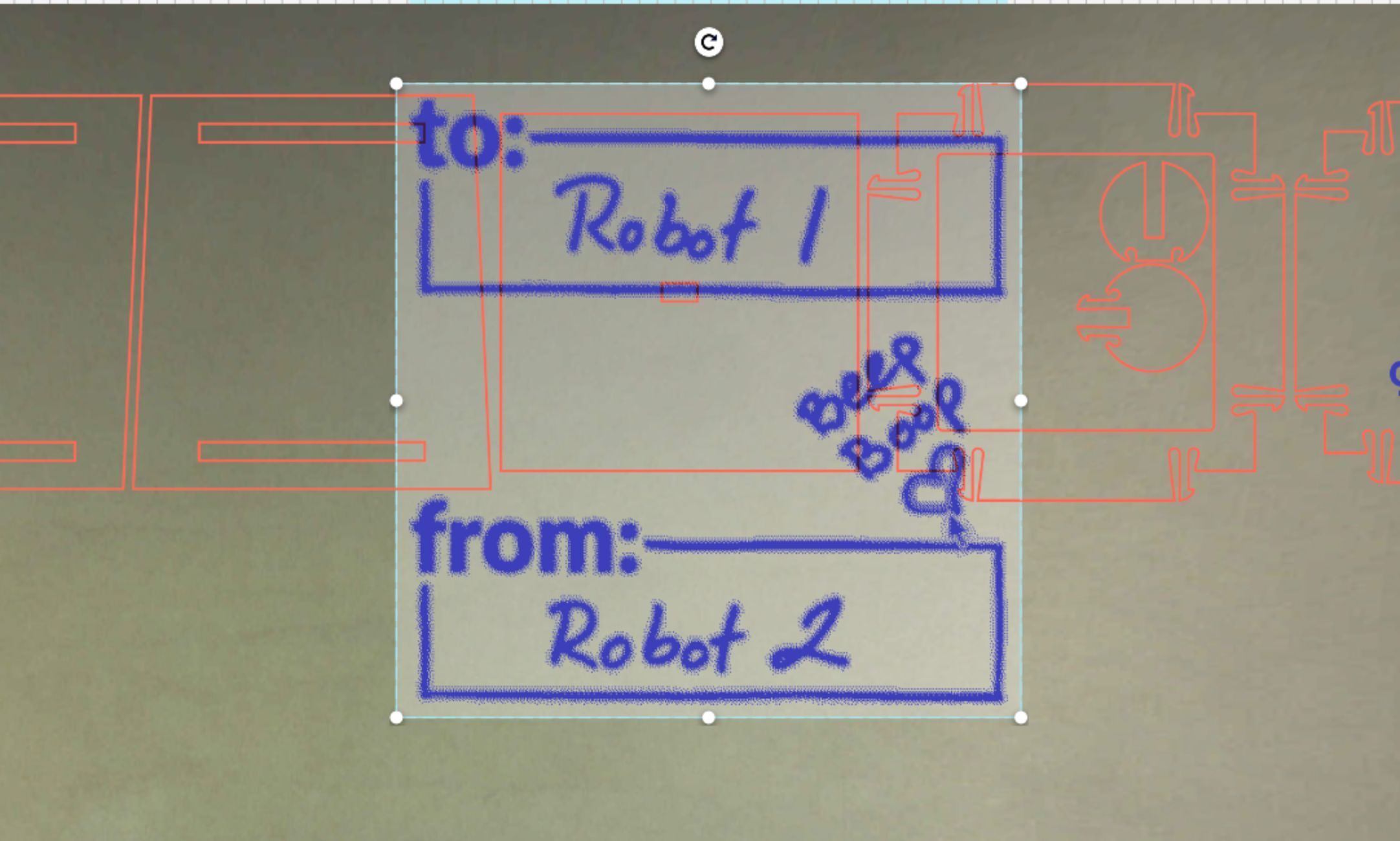

6. Click and drag a square around the artwork that you want to trace. You'll see a preview of what your Glowforge will engrave. Anything in black will be engraved, and nothing else will be. If you want to change your selection, click Undo in the app and try again.
Screenshot showing drawing a selection box around traced artwork to select it
7. If you want to refine the details, click on the item you want to change, and then use keyboard shortcuts to make changes.
Clicking on a portion of traced artwork in the Glowforge App to set it as a cut
8. If you drew a closed shape, you can click it to cut it out.
9. When you’re happy with your trace, in the upper right, click Place Artwork.

Size your artwork and place it in the design.
  1. In the app, the Workspace shows both design and artwork.
  2. Drag the box design to where you'd like it.
  3. Place your traced artwork within the design — for example, drag the artwork onto the box lid. Click and drag a corner to shrink your artwork to fit where you want to put it. Any artwork outside the outer lines of the box design will be cut off. Be careful not to resize the box design!
  4. To fine-tune placement, you can nudge selected objects using your arrow keys. To get bigger nudges, hold the Shift key while using the arrow keys.

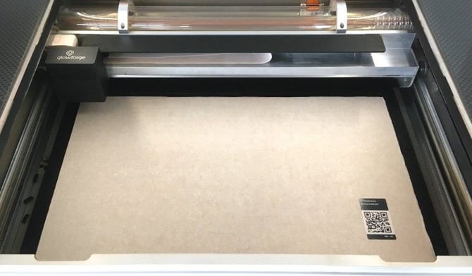

1. Place a piece of medium Proofgrade plywood on the center of the printer bed (it is very important you use medium Proofgrade Plywood so the pieces fit together), and then close the lid.

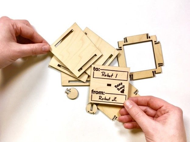

  3. When the button stops glowing and the fans stop, remove your print, peel off the protective layer, and get ready to assemble.
Two hands holding a lasercut wooden parts over a pile of other parts for a box prior to assembly
