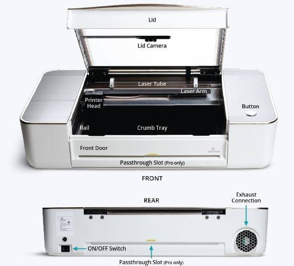

Here’s a quick tour of parts you’ll need to know:
Your shipment arrived in two boxes (plus another one for the Air Filter if you ordered one). The largest box contains your Glowforge printer and (shipped inside your Glowforge for safety) the printer head and power cord. We suggest telling the neighbors the box contains a big microwave, so they don’t pester you all day to use it.

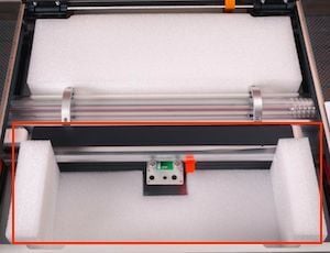

Remove the front foam block
Gently pull out the foam closest to the lowered front door.

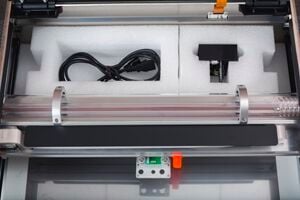

Remove the top layer of the rear foam block to reveal your printer head and lens tool.
Remove the rear foam block
Gently remove the rear foam block, including the printer head and lens tool. Set these aside for now. Don’t worry! You’ll power up your Glowforge in just a few minutes.

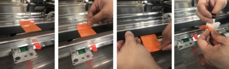

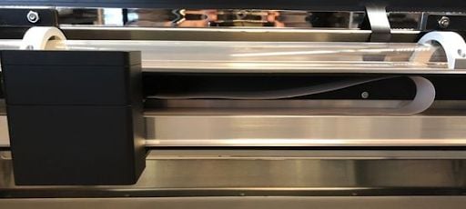

Remove orange tape from the laser arm
Pull the tape from the point farthest away from you towards you, then gently remove it from the wire ribbon.
You don’t need to save the tape!
Remove the orange clip
Under the glass tube, you’ll find an orange clip. Push down on it and it will pop off.
Remove red strips
Push the laser tube back gently, then lift off the two red silicone strips.

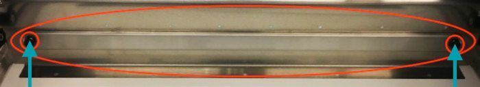

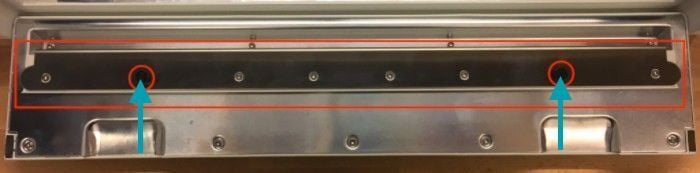

Remove the front Pro Shield from the front door of your Glowforge
With the front door opened, turn the black finger screws on either end of the Pro Shield counterclockwise to unscrew them, then lift the shield away from the front door.
Using two hands, gently pull the laser arm to the front of your Glowforge
This will expose the rear Pro Shield so you can easily remove it.
Remove the back Pro Shield from the inner back wall of your Glowforge
Turn the black finger screws on either end of the Pro Shield counterclockwise to unscrew them, then lift the shield away from the wall.

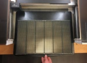

Slide in the crumb tray
The black, metal crumb tray sits inside the bed of your Glowforge, supports the material you place inside, and catches leftover print bits to keep your Glowforge nice and tidy. It has four little feet that rest in four small dimples. The handle goes in front, and the feet go on the bottom.
Lift the lid of your Glowforge and lower the front door
Gently move the laser Arm
Using two hands, gently push the laser arm away from you until it’s near the back of the printer.
Pick up the crumb tray
Pick up the crumb tray, making sure the handle is in the front and the wide black plastic strip is in the back.
Slide it in until you feel the feet settle into the dimples in the base of the Glowforge printer.
Make sure the handle is in front
Double-check that the handle’s in the front, and the wide black part is in the back, just like the picture. Otherwise, you’ll have mysterious printing problems, and feel silly when we ask you if your tray is in backwards.

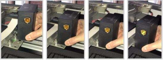

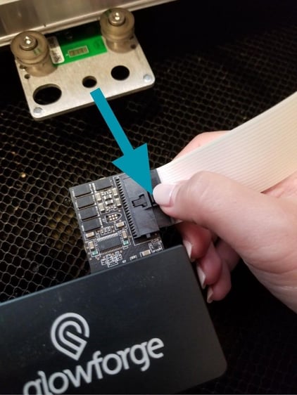

Carefully pick up the printer head
Do not touch any part of the printer head that is not flat black metal. Be especially careful of the yellow window on the side of the head. Remove the printer head from the white foam tray and remove the orange foam cylinder from inside the head.
Pick up the wire ribbon
Holding only the finished black surfaces of the printer head, pick up the printer head and wire ribbon as shown.
Slide the ribbon into the head.
Make sure the tab on the wire ribbon is facing up. Gently slide the ribbon into the head until it clicks.
Attach the printer head
As shown, lower the printer head over the metal plate so that it rests next to the two round posts. Then push it gently away from you until you feel a “click” as magnets pull the printer head to sit snugly atop the metal plate.

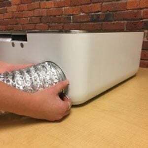

Connect the hose to the printer
Slide the ring clamp around the silver 4-inch-diameter hose provided. Squeeze the two ends of the clamp together to fit the hose and clamp over the exhaust connection on the back of your Glowforge printer. Let go, then check that the clamp is settled over the white ring around the exhaust and will not come off with a gentle tug.
Extend the hose to the outdoors
Extend the other end of the hose to the outdoors through a window or a vent that connects directly outside. Do not use a vent that extends the length of the hose past 8 feet or adds any turns. Keep the hose as straight as you can, with no more than two turns of 90 degrees or less. Make sure the hose isn’t twisted, pinched, kinked, or flattened.

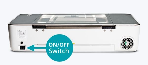

Ensure your Glowforge is off
Make sure your Glowforge is turned off (on the rear switch, O is depressed) and then connect the power cable.
Plug in your Glowforge
Plug the Glowforge into a grounded wall outlet with 800 watts of power. Make sure you connect the printer directly to a wall outlet and not a surge protector or power strip.

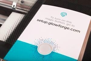

Turn on your Glowforge
Turn on your Glowforge by pressing the switch so the “I” side is depressed.
Lights will come on, the head will move, and you might hear a bubbling sound. The printer's button will glow teal. Your Glowforge is on!
