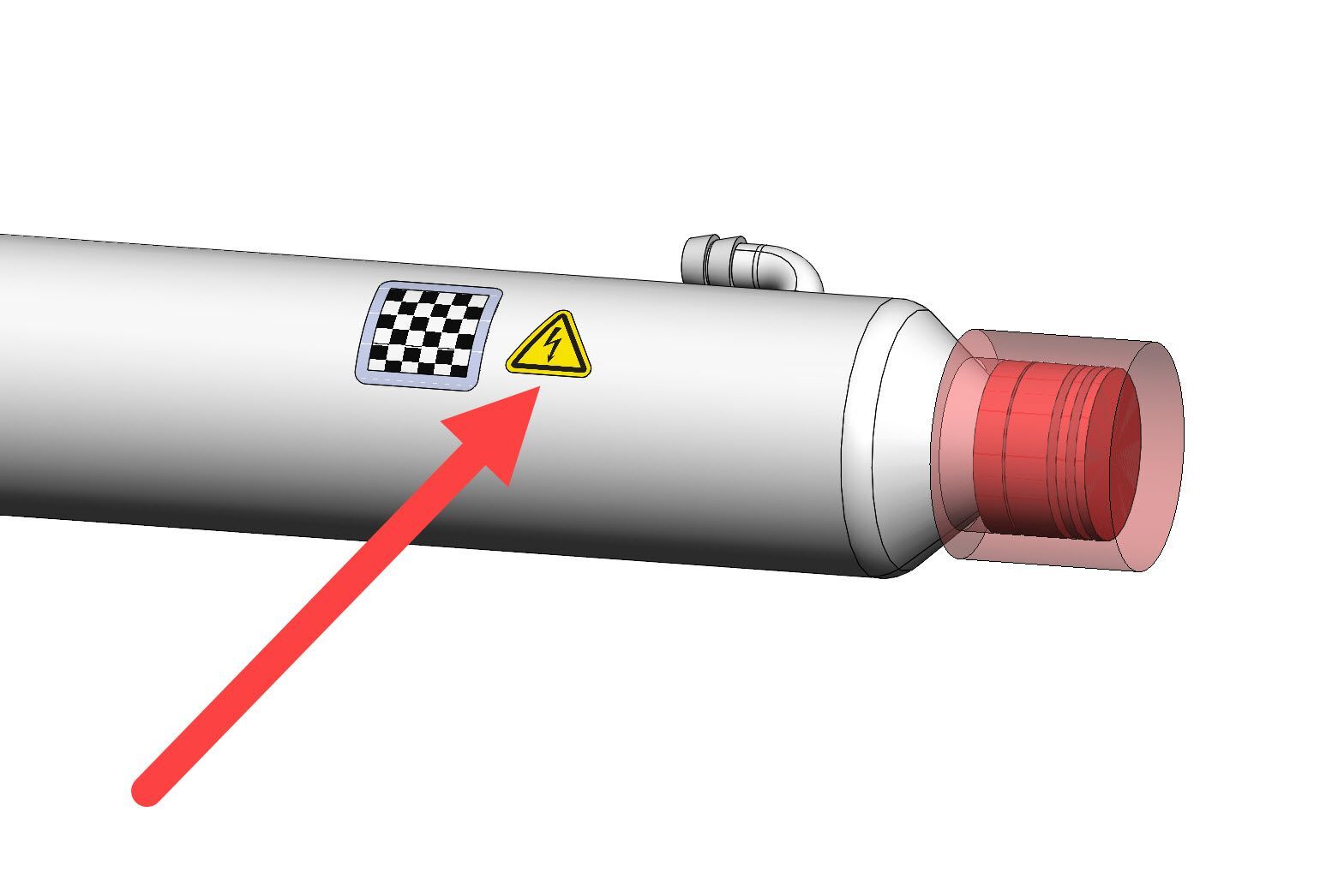

The following label information applies to the Glowforge Basic, Plus and Pro
This label appears on the laser tube in the spot indicated by the arrow in the diagram below and indicates that there is a high voltage shock hazard.
