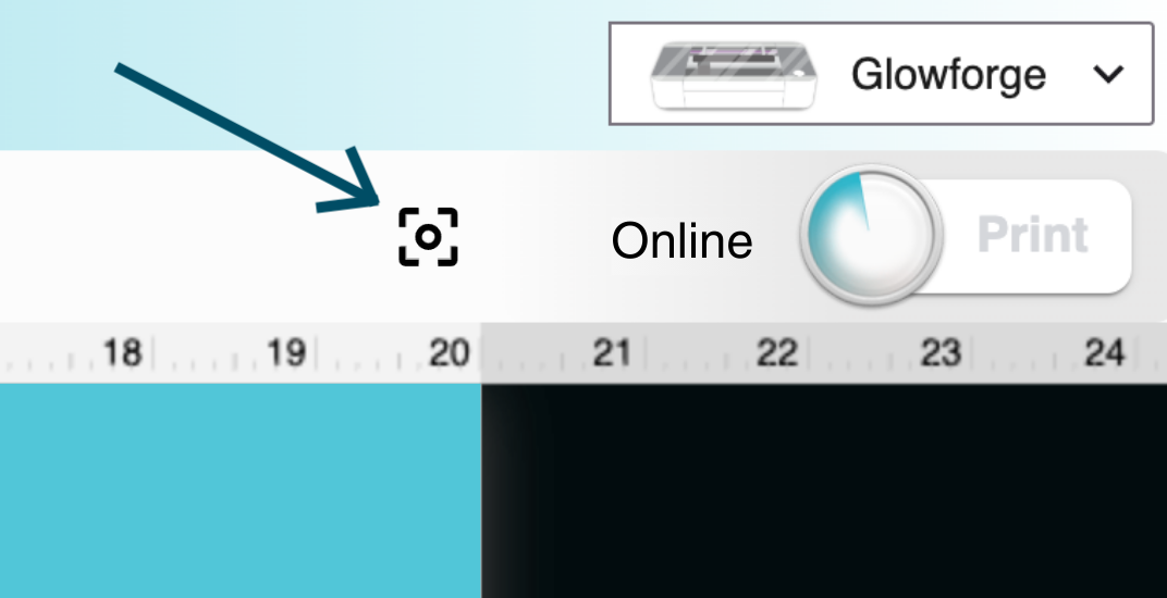

How to Set Focus
Sign into the App and enter the workspace.
Place the material in your Glowforge and wait for the bed image to update.
On the top menu bar, near the printer status on the right side, look for the icon as shown below, and then click Set Focus. Your cursor changes to a red target.
Note: If your Glowforge is offline, or if a print is already running, this option will be unavailable.
Click the spot where you want to print. The printer head will move there, and the image will refresh to be more accurate.

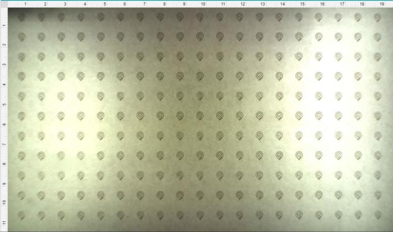

Each Glowforge unit is tested on a flat surface at the factory. Moving your Glowforge may shift its camera slightly.
To restore factory accuracy, you can use the Camera Recalibrator. It prints a grid of markings, takes a picture, then measures its height in multiple locations. This data makes your camera more accurate for future prints.
Using the Camera Recalibrator
You’ll need a 12” (30.4 cm) x 20” (50.8 cm) piece of material with no markings or stickers. The feature was designed to be used with a flat piece of medium Draftboard, used upside-down (with the sticker side down). It may work with other materials that are the same size and use the same print settings, such as Proofgrade plywood.
Once you've placed your material, you can launch the Camera Recalibrator, which will guide you through the process.
