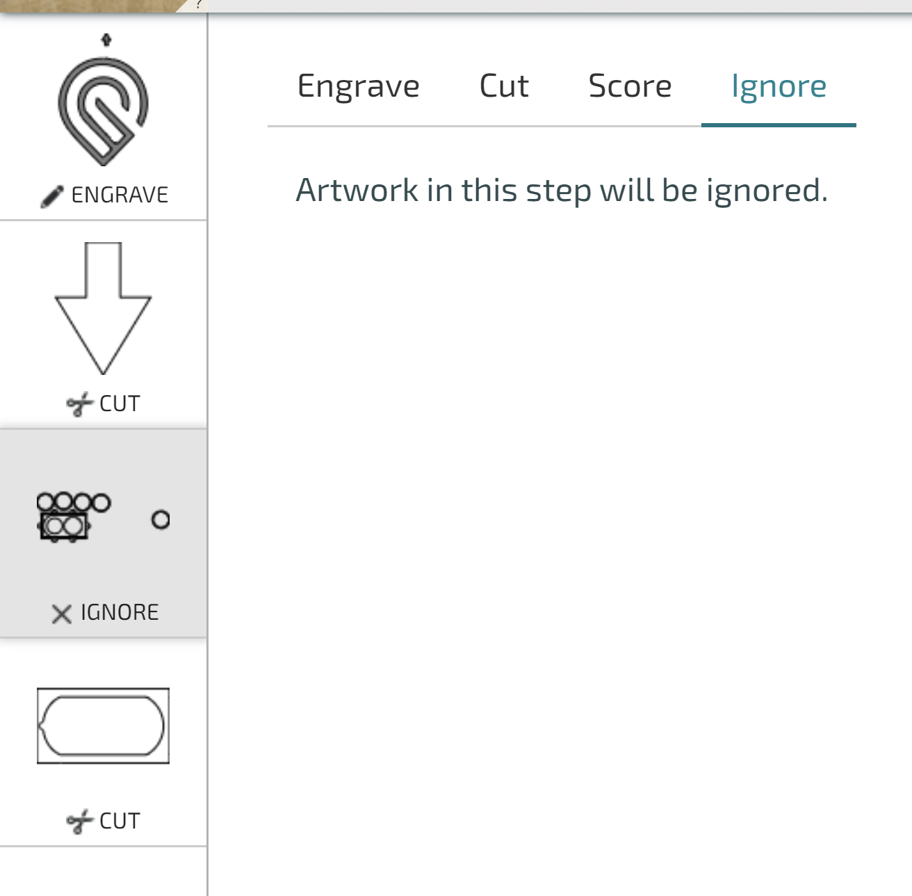

Break the design into steps
  1. When you upload your file to the Glowforge App, each color and each image or photo becomes a separate print step. Divide your design into more steps by changing some of the lines and shapes to different colors.
  2. Click on any step on the left side of your workspace. In the option box that pops up, select Ignore. This will tell the app to do nothing with that object.
  3. Repeat this with the other steps until you have only one left. Then press Print. This will send just one shape to your printer.
  4. When the print finishes, leave your material in place.
  5. Set the step you printed to Ignore. Choose one other step and set it back to its original setting (Cut, Engrave, or Score.)
  6. Continue ignoring and printing until you’ve finished.
