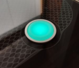

  2. Make sure your Glowforge button is teal colored
    When you first power up your Glowforge, the button will turn teal to indicate it’s broadcasting a Wi-Fi signal and ready for setup. If the button is not teal, no problem. Turn on your Glowforge and hold down the button for ten seconds until it turns teal. Your Glowforge is now broadcasting a temporary Wi-Fi signal.
    The button on the top of the Glowforge. It is glowing teal.

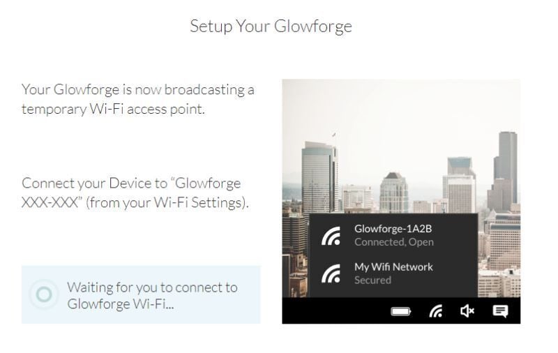

  4. Turn on airplane mode
    If you are on a phone or tablet with a cellular connection, you will need to turn it off. Otherwise, your phone or tablet will use the cellular connection instead of the Wi-Fi signal broadcasted by your Glowforge. Turn on airplane mode, and if necessary, turn Wi-Fi back on.
  5. Search for the Glowforge Wi-Fi
    With your computer, phone, or tablet, search the list of available Wi-Fi networks, looking for one that starts with “Glowforge,” followed by 6 characters with a hyphen, like “Glowforge XXX-XXX”. You’re going to disconnect from the internet and connect to your Glowforge to continue the setup process.

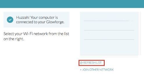

  1. Refresh the list of networks
    Sometimes it takes a moment for a network to show up on the list, so press “Refresh List” and wait for 30 seconds.
    Screenshot from the Wi-Fi setup process. The network list is blank, and the refresh list button is highlighted

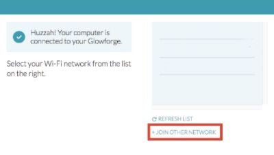

  2. Join Other Network
    If your network doesn’t appear, first make sure your network is broadcasting on 2.4 GHz. Then click “Join Other Network,” type your network name and password and click “Connect.”
    Screenshot from the Wi-Fi setup process. The network list is blank, and the join other network button is highlighted

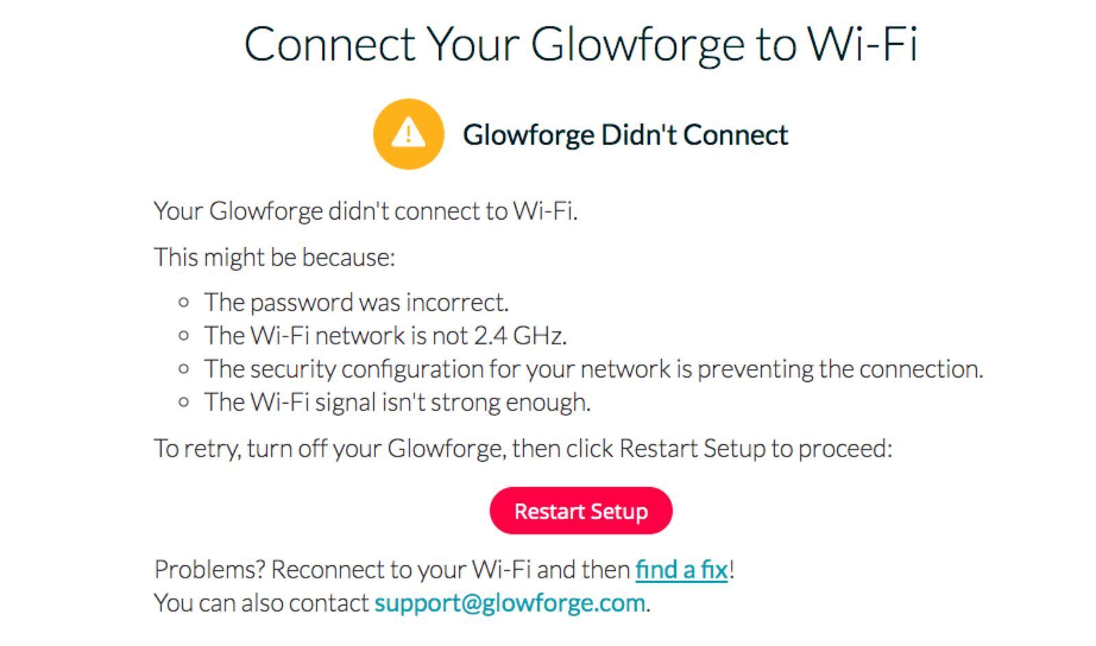

Once you’ve connected to your Glowforge and selected your network, you’ll be asked for your Wi-Fi password. If you get this error, the most likely issue is that your password was not correct.
  1. Click “Restart Setup” and choose your network again
    Screenshot of a failure to connect error messsage
