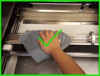

  4. Clean the floor
    Wipe the metal floor of your Glowforge with a soft cloth to sweep away any bits.

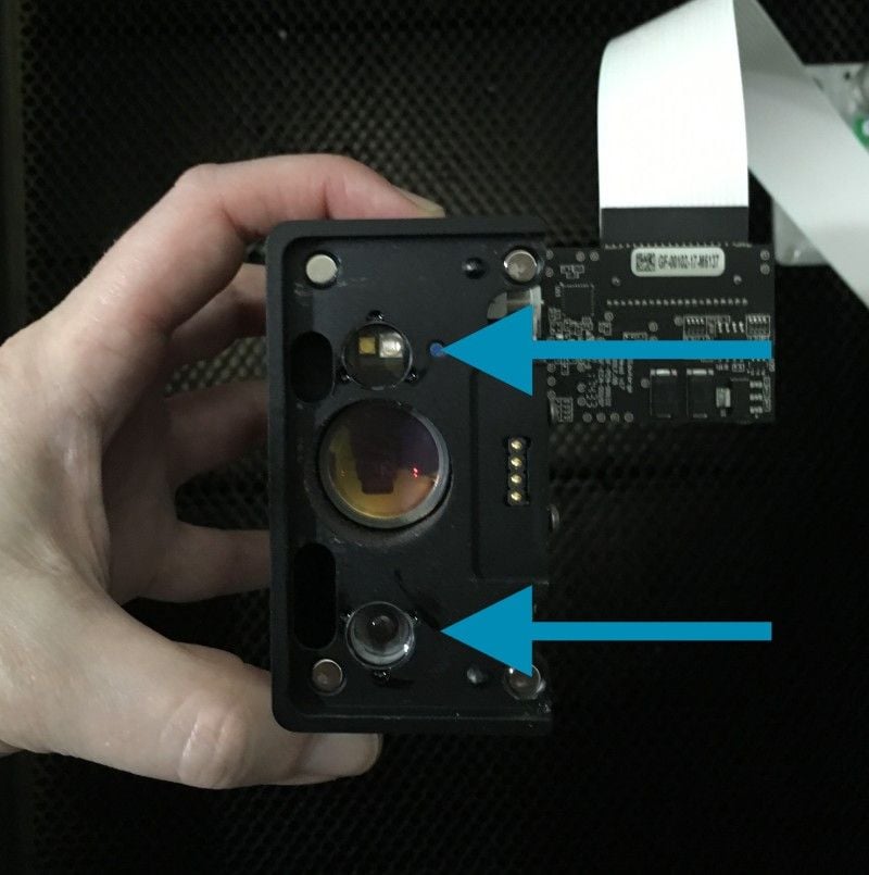

  2. Wipe the windows on the underside of the printer head
    Turn the printer head over and use a ZEISS cleaning wipe to gently wipe the small window on either side of the lens.
    The bottom of the print head. Arrows are pointing to the windows on  the left and right on the bottom of the head.

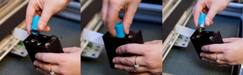

  3. Remove the lens
    With the "Remove" arrow pointed in, gently insert the lens tool into bottom of the printer head. When you hear the magnet click, remove the tool and the lens.
    An image sequence showing a hand inserting the lens tool into the bottom of the print head and then pulling it back out to remove the lens.
  4. Wipe the lens
    Gently slide the lens off the lens tool and wipe both sides with a lens wipe. Be careful to touch only the metal ring to avoid fingerprints on the lens.
    One hand holding the lens tool, and the other removing the lens from the tool

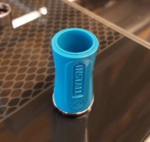

  5. Re-insert the lens
    Flip the lens tool so that the “Install” arrow points up. Set the lens down on the lens tool. The open side faces away from the blue plastic, so it looks like a bowl on top of the tool. It will sit firmly on the tool and will not wiggle. Slide the lens tool up into the printer head until the magnet clicks, then remove the tool.

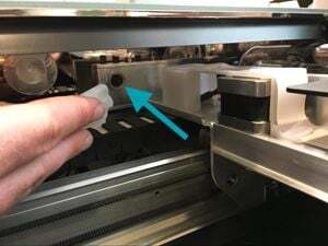

  7. Wipe the printer head window
    Wipe the window on the left side of the printer head.

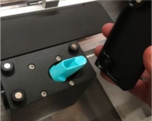

  3. Remove the top of the printer head. The top of the printer head is held on by strong magnets. Grasp only the top, and then pull up carefully to remove it and set it aside.
    Top of the print head, fully removed.

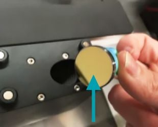

  4. Gently pick up the mirror by grasping the blue mirror handle.
    A hand grasping the handle of the 45 degree mirrorA hand holding the handle of the mirror, with the mirror turned towards the camera.
  5. Inspect and gently clean the mirror using a Zeiss wipe. Use several passes until the mirror is clean, each time moving to an unused portion of the lens wipe. Be careful not to touch the mirror surface with your bare fingers.
Note: If the mirror has a spot in the middle that can't be cleaned or can't be cleaned to a reflective finish, it needs to be replaced. Replacement mirrors can be purchase in our shop here.

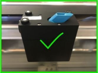

1. If everything looks okay with your mirror, return it to the printer head.
Hold the mirror by the handle and gently slide it into the notch with the mirror at a 45-degree angle to the top of the printer head. (See the sequence below.)
Fingers grasping the two large, flat sides of the mirror handle. The mirror is pointed towards the inside of the print head.
The mirror is partially inserted into the print head. The flat side of the handle with the Glowforge logo embossed onto it is parallel with the top of the print head.
The mirror is fully inserted into the print head. The flat side of the handle with the Glowforge logo embossed onto it is parallel with the top of the print head.
The Glowforge logo on the handle will face up and sit parallel to the floor. The handle will rest lightly in place; there's no need to force it.
The mirror handle should look like this:

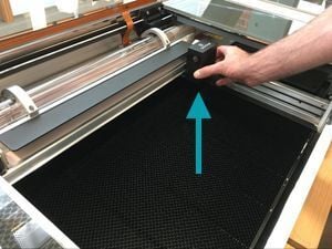

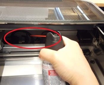

  4. There’s another circuit board on the left side of your printer. It’s not necessary to clean this, either. If you’d like to, follow these steps:
    Use both hands to gently move the laser arm to the front of the print bed. You’ll see the circuit board on the left side of your printer. Use canned air to blow the dust away (as seen below). Then use both hands to roll the laser arm back to the middle of the print bed.
    Using a can of compressed air to clean the largest circuit board located in the left-hand side of the Glowforge.

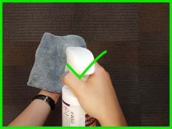

  5. You can use isopropyl alcohol to wipe down the laser tube of your Glowforge. Spray it on a lint-free cloth, then wipe away dust and debris. Important: Never spray liquid on or in your Glowforge printer.
    One hand holding a lint-free cloth, the other spraying isopropyl alocohol onto itA hand cleaning the glass of the laser tube inside the Glowforge using a lint-free cloth.
  6. Wait for your everything to dry completely before turning your Glowforge back on.
