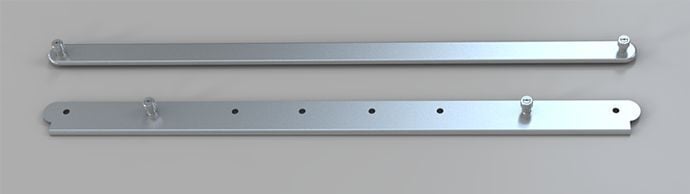

Remove the front Pro Shield from the front door of your Glowforge.
With the front door opened, turn the black finger screws on either end of the Pro Shield counterclockwise to unscrew them, then lift the shield away from the front door.

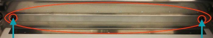

Using two hands, gently pull the laser arm to the front of your Glowforge. This will reveal the rear Pro Shield so you can easily remove it.
Remove the back Pro Shield from the inner back wall of your Glowforge.
Turn the black finger screws on either end of the Pro Shield counterclockwise to unscrew them, then lift the shield away from the wall..

Install the front Pro Shield
- The front Pro Shield has a rectangular edge and six circular holes which align perfectly with the screws already in the front door of your Glowforge.
- With the rectangular edge facing away from you, align the two black screws on the front Pro Shield with the two open screw holes near the passthrough slot. The rectangular edge of the Pro Shield should be facing the inside of the Glowforge as pictured.
- Using your fingers, screw the two black knobs clockwise to secure your Pro Shield.

Align the back Pro Shield against the passthrough slot on the inside of the Glowforge
The back Pro Shield is an oval and has no screw holes aside from a black finger screw on either end. Using your fingers, screw the two black knobs clockwise to secure your Pro Shield.
