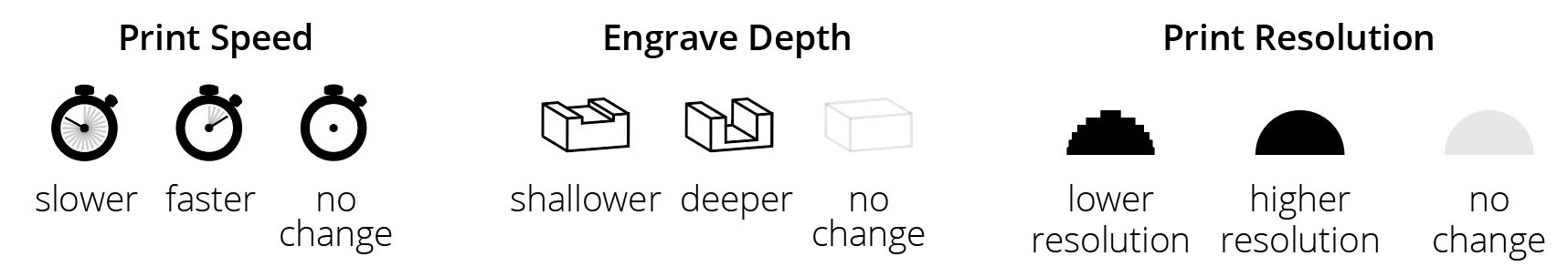

Legend
Three symbols offer a quick visual reference for each parameter's effects. "Print speed" refers to how quickly your print will complete; "engrave depth" refers to the depth of your engraves and scores; and "print resolution" refers to the level of detail achievable. Keep these in mind as you read further.

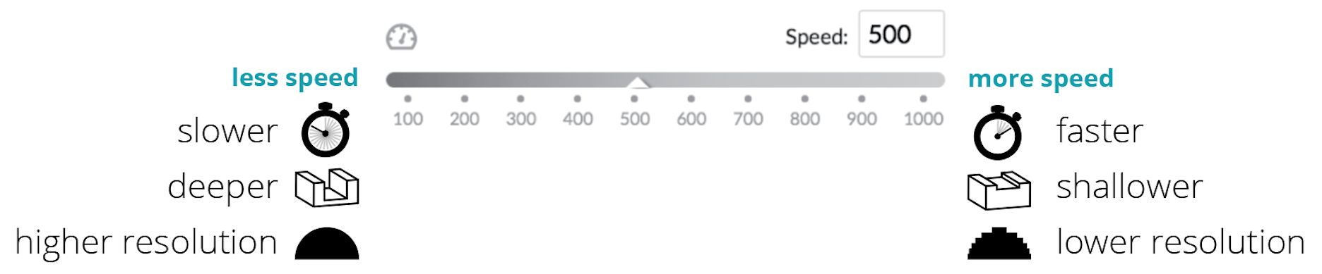

Speed controls the maximum speed the laser head moves around the printing area.
How does this affect my print?
- Increasing speed decreases your overall print time, as the laser head moves more quickly.
- Increasing speed decreases the depth of engraves, cuts, and scores, as the laser has less time to impart laser energy into your material.
- Increasing speed reduces print quality. In the case of an engrave, the laser has less time to make an accurately positioned mark on your material. In the case of a cut or score, too much speed can result in the laser head jerking when changing direction, causing jagged lines and bumps in your print.
- Too much speed when cutting and scoring can also result in dark corners when the laser head changes direction, imparting too much energy for the material.

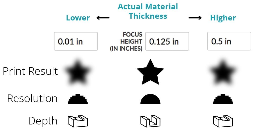

Focus height can override the autofocus result, changing the size of the laser spot and how efficiently it can mark the material. For the highest levels of detail and most efficient cutting, the focus height should not be changed.
- Changing the Focus Height is the same as switching from autofocus to manual focus on a camera. If the Focus Height is not set accurately, the laser spot will be blurred, and will cause the edges of your engraves to seem less sharp
- Changing the Focus Height also reduces the amount of energy the laser can put into your material, much like when focusing the sun through a magnifying glass. If the lens (or magnifying glass) is not in the right position, the energy from the laser (or sun) is spread over a wider area and the amount of heat that can be produced is reduced. As a result, engraves will be less deep, and the marks made when cutting and scoring will be less deep and wider.

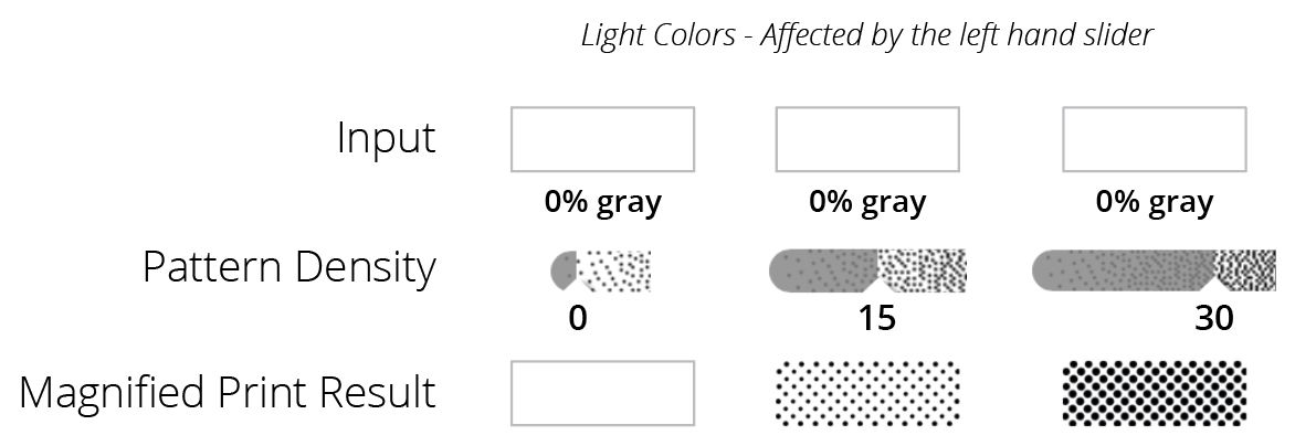

Pattern Density
In conjunction with dithering, the Pattern Density can be used to make the light areas of your image appear darker or deeper, and the dark areas of your image lighter and less deep. It’s a powerful tool, especially when engraving photographs.
Let’s assume we upload a photograph that includes both light and dark areas, and engrave it using full speed, 100 precision power, and Convert To Dots.
In this scenario, unless we have carefully processed our image to prepare it for engraving, we will likely find that the lightest areas in our image don’t make a mark on our material, and the darkest areas are very dark and deep, and may be merged together into a big brown blob.
If the lightest areas of our image don’t mark the material, increase the value of the left hand Pattern Density slider. This is somewhat equivalent to darkening the light areas of our image, which when combined with the Convert To Dots option, increases the concentration of dots within a given area, causing more of them to overlap, and visually translating to a darker print result.
If the darkest areas of our image muddle together or are too deep, decrease the value of the right hand Pattern Density slider. This is somewhat equivalent to lightening the dark areas of our image, which when combined with the Convert To Dots option, decreases the concentration of dots within a given area, reducing the amount of times the dots overlap, and the depth of the engrave.

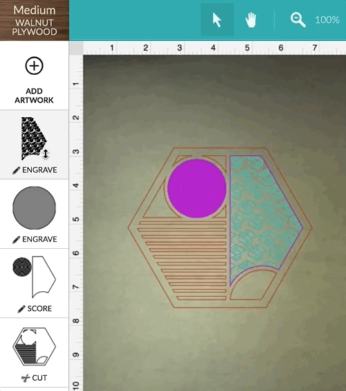

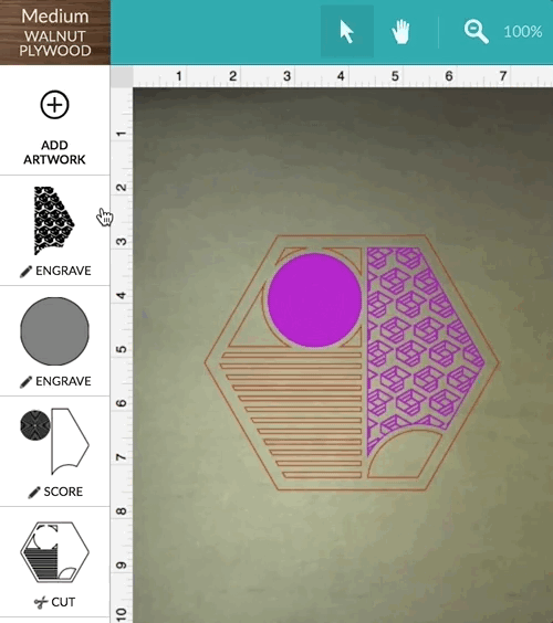

Testing and Saving New Settings
Printing on a huge variety of materials is exciting, but extreme caution is required. Beware that printing with custom settings creates a high risk of fire or damage to your Glowforge. Follow all instructions in the Glowforge user manual carefully and never print with your laser unattended.
Manual settings can be used on both Proofgrade materials (for custom effects) or on your own materials. When experimenting with new materials, run a small test print at minimum power first, and gradually increase the power until you achieve the desired result. Some materials behave unexpectedly when lasered, and it’s important to proceed with caution.
After dialing in a custom setting, save your parameters for use on any future designs.
Saved settings are tied to a specific print operation. You can have a unique list of settings for Cut, Score, Vector Engrave and Bitmap Engrave. For each step, once you’ve selected the operation, you’ll see the list of available settings.
