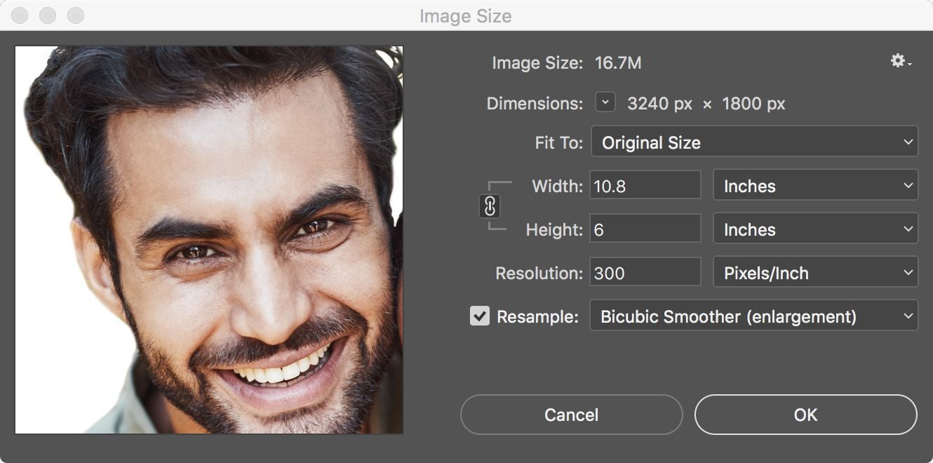

- From the menu, click File > Open, select your photo and click Open.
 - Click Image > Image Size and lock the Width and Height by clicking the chain link to the left side of the text fields so it shows a linked chain.
 - Check the box labelled Resample at the bottom of the window, choose “Bicubic Smoother (enlargement)” from the menu by the check box.
 - In the Width or Height fields, enter the width or height of the image you’d like to print. For example, enter “8” into the Width field and ensure “Inches” is selected in the units menu. The other fields update automatically.
 - Change the resolution of the file to “300” if it’s 299 or less, by changing the Resolution field.
Begin by uploading an image that’s as big as, or bigger than, the size of your finished print.

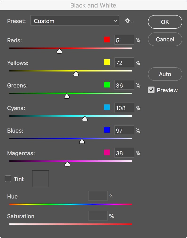

Convert to black and white
- Choose Image > Adjustments > Black and White from the menu bar and ensure the Preview checkbox is checked.
 - Explore the effect of adjusting each slider and experiment with the results. Pay careful attention to areas of high detail, such as hair and grass, and ensure your adjustments don’t cause this detail to blend or blur together. Some sliders might seem to have little effect; that’s ok, as each slider affects only certain colors in your image.
 - Once you’re happy with the result, click OK.
Converting your image to black and white is subjective, so experiment with the sliders until the end result looks good to you. Each image is different and will need a slightly different adjustment to look its best.

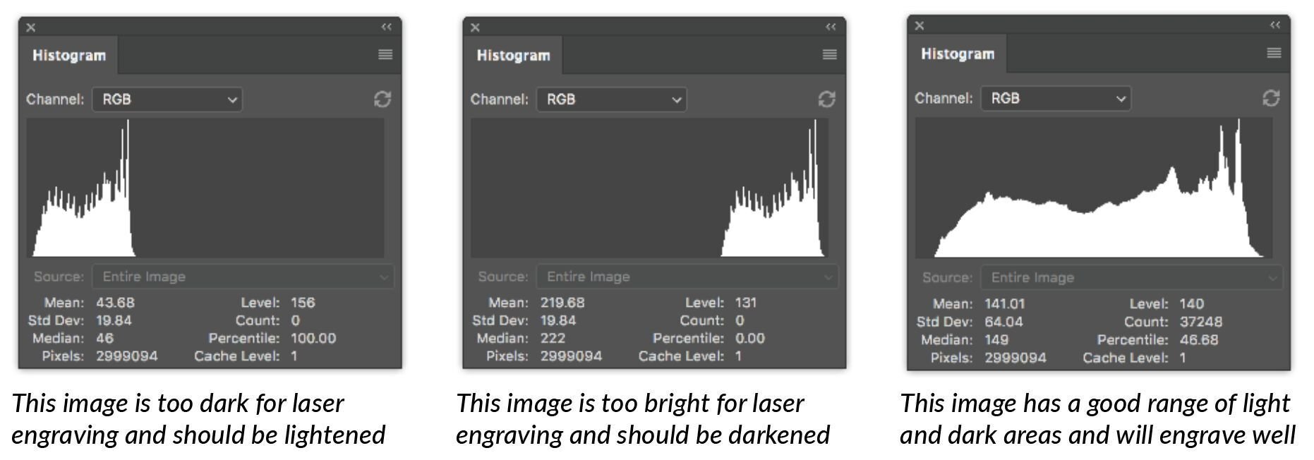

The histogram
Open the histogram by clicking Window > Histogram from the menu bar at the top of the screen.
The histogram displays the amount and distribution of light and dark areas, which helps us understand how to adjust the brightness for best results.
The histogram is unique to each image so don’t worry if yours doesn’t look the same as these examples.

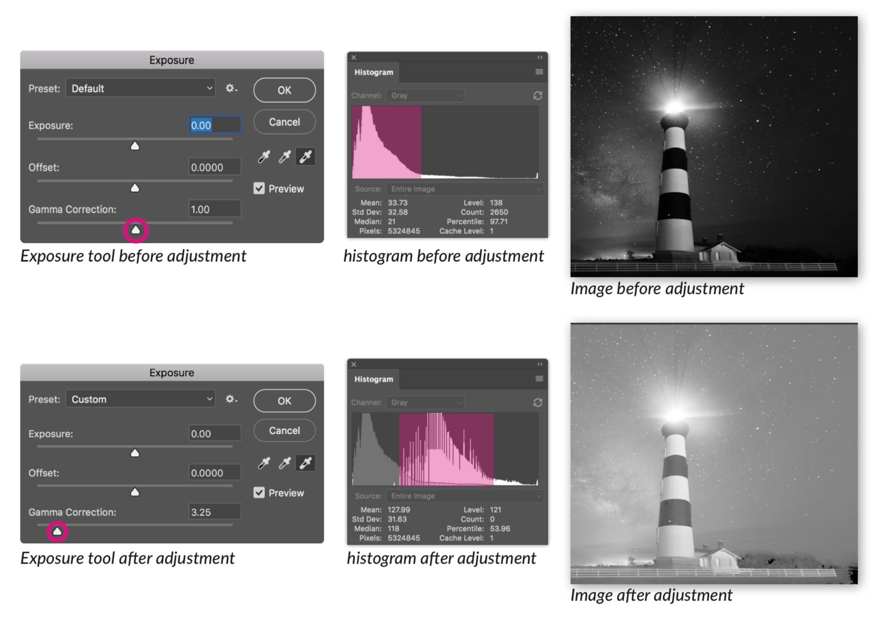

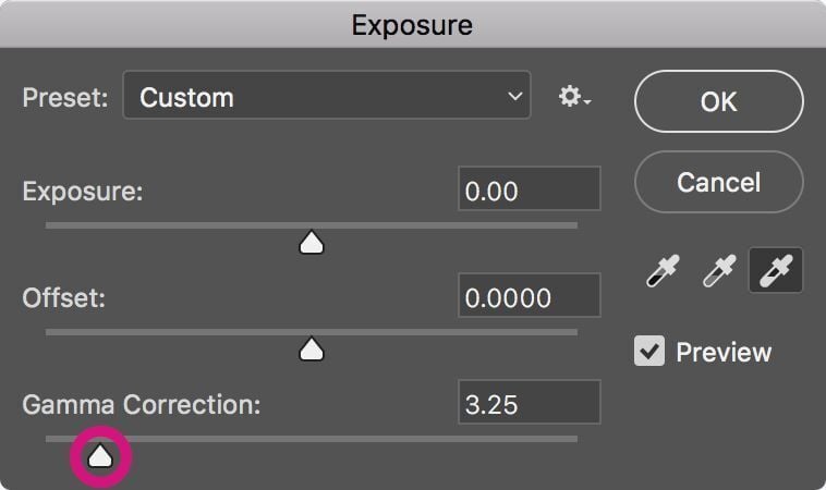

Optimize Exposure
Choose Window > Histogram to open Histogram, and Image > Adjustments > Exposure to open Exposure
Adjust the Gamma Correction slider to alter your histogram until the majority of the data (illustrated by the black mountainous shape) is roughly centered within the window.
- Here’s an example of an image and its histogram before and after the adjustment.

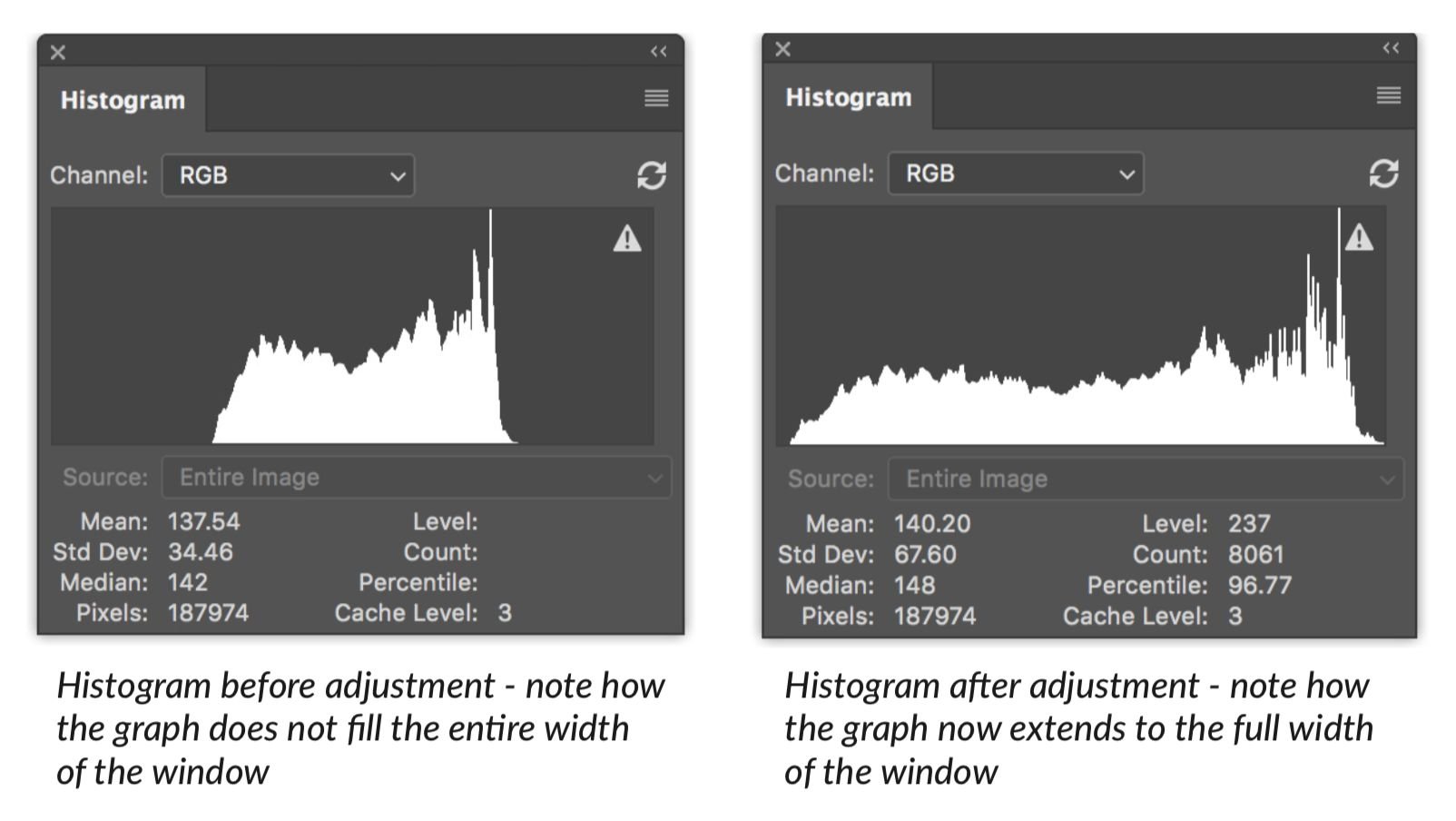

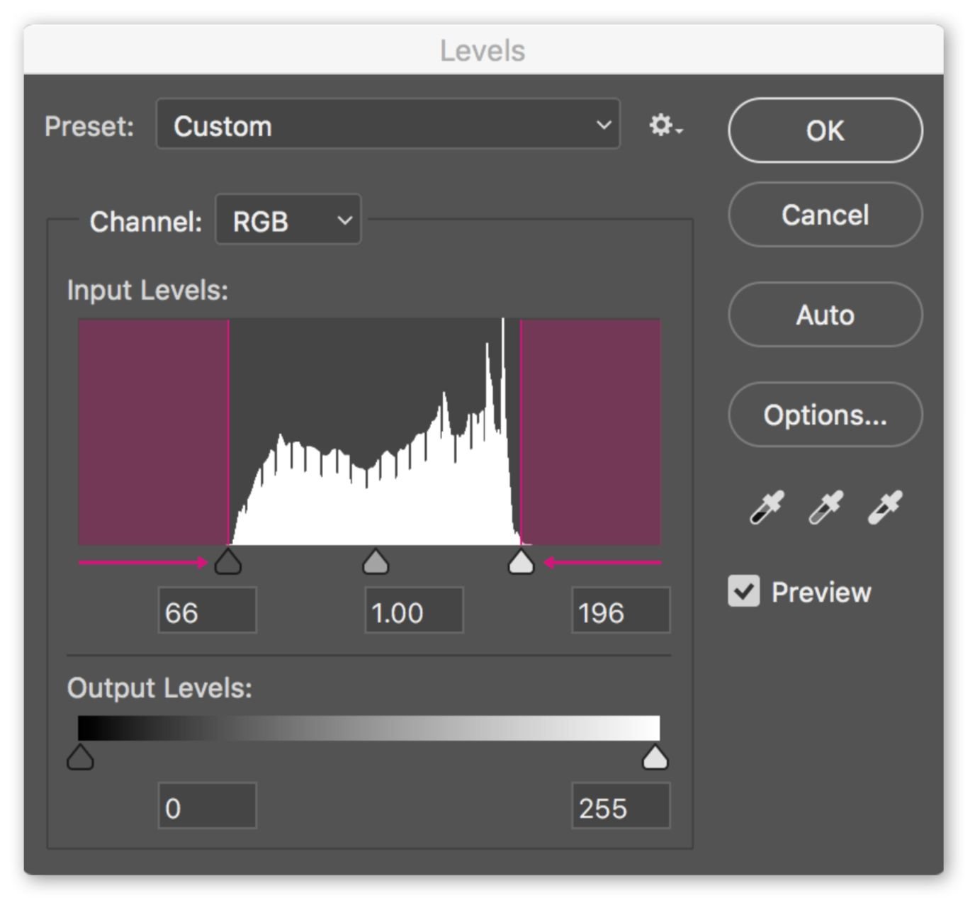

Clipping the histogram
Open the Levels Tool by clicking Image > Adjustment > Levels from the menu bar at the top of the screen.
If the main portion of your histogram doesn’t fill the width of the box, use the light and dark Input Level Sliders in the Levels Tool to clip away the lightest and darkest pixels. Click and drag the sliders found under the histogram toward the center until they frame the main body of the histogram.
In this example, we’re clipping away the magenta areas. You may need to clip away more or less, depending on the shape of your histogram.
If your histogram already spans the full width of the window you can skip this step.

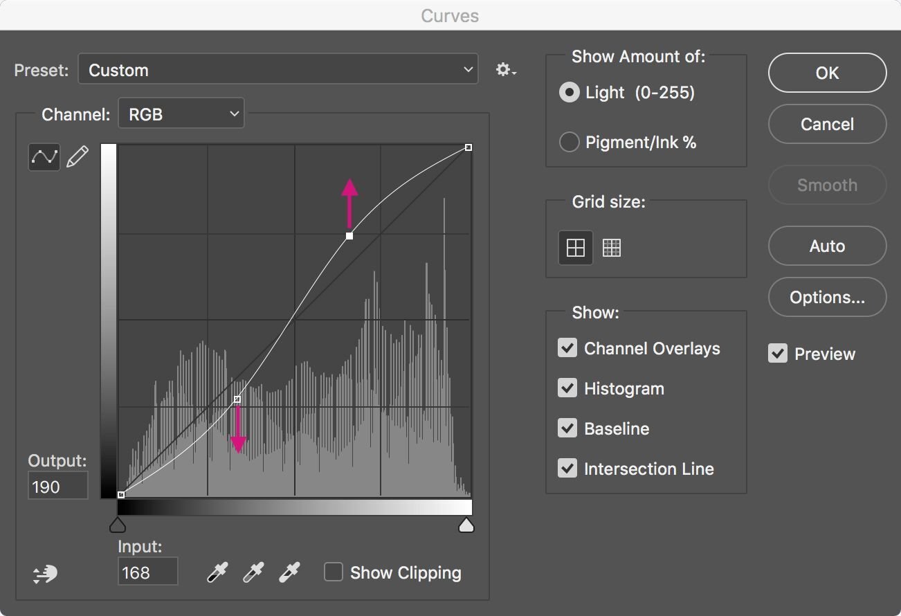

Boosting contrast
Slightly boosting contrast on your image can also help improve your engraving. Do this with the Curves Tool in the menu bar under Image > Adjustments > Curves.
Open the Curves Tool, and using your cursor, click and drag slightly up and down at the points indicated in the example below. This will introduce a gentle ‘S’ curve to the graph, forcing the middle grey tones lighter and darker.
Although the recommended adjustment to the curves tool is subtle, try experimenting by making more extreme changes to different points on the graph. Understanding this tool will be useful to you in both laser engraved and printed photography.

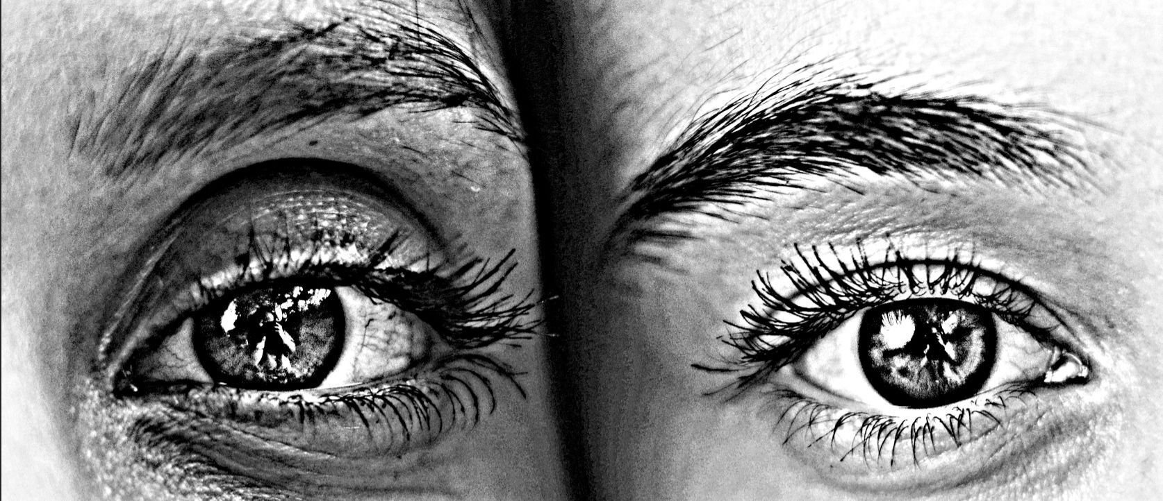

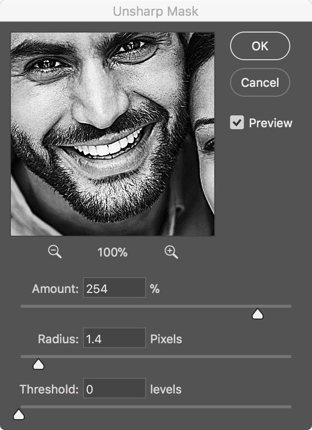

Apply sharpening
From the menu bar, click Filter > Sharpen > Unsharp Mask, change the Amount field to “250”, the Radius to “0.1”, and Threshold to “0”.
Start to increase the Radius by clicking into the Radius field and increasing the value with your arrow keys, or clicking on and dragging the slider.
Stop increasing the Radius when the details in your image start to look crisp and well defined. If you notice blotches and white halos around areas in your image, you might have increased the Radius too much.
- See the next step for some examples of sharpening.
An Amount of 254 and Radius of 1.4 provided the best result for this image. Remember, your image is different and you may need to apply a different amount of sharpening.

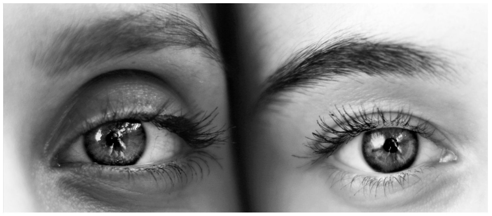

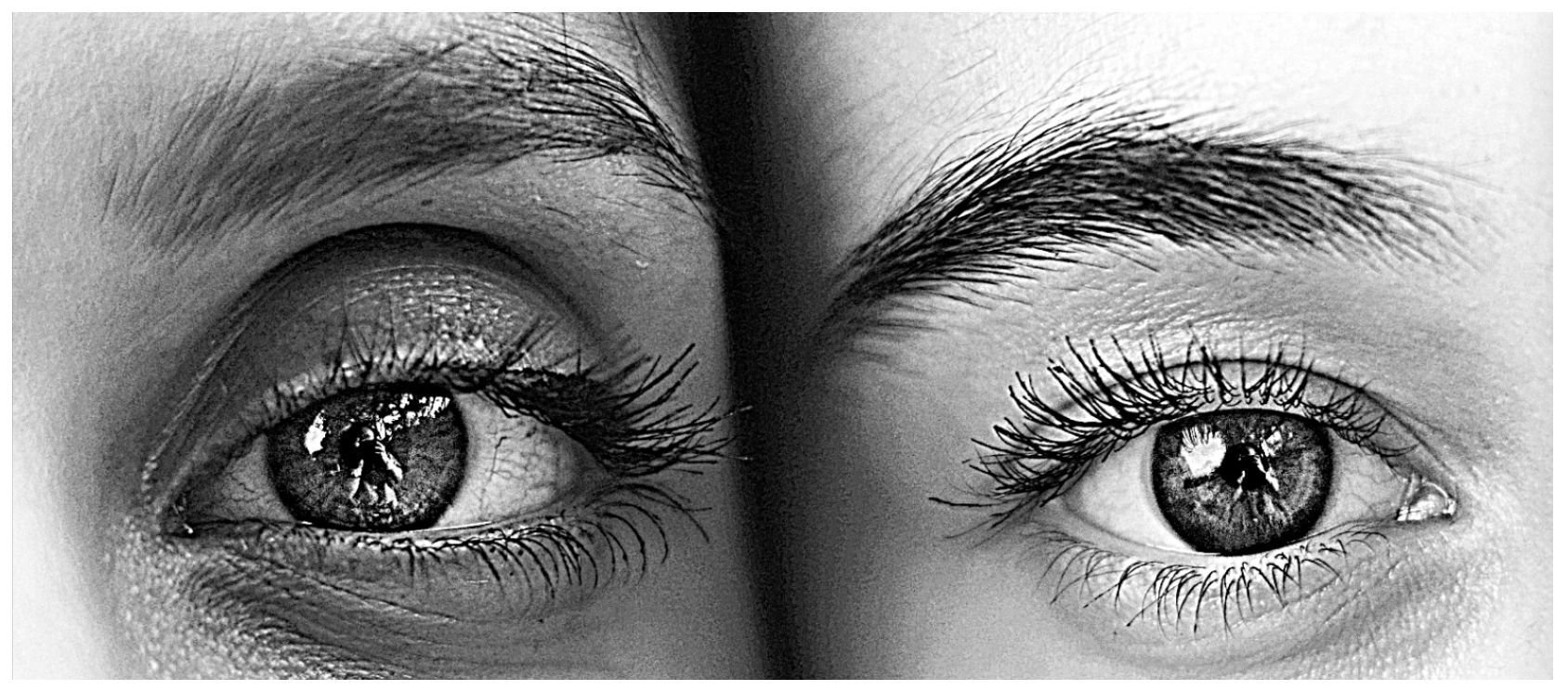

How much sharpening should I use?
As a general rule when laser engraving photos, apply more sharpening than if you were printing on paper.
- No sharpening. Looks a little soft and blurry.
- A small amount of sharpening. This would look great printed with ink.
- Slightly more sharpening than above. This photo would engrave very well on the Glowforge.
- This photo shows too much sharpening for a great engrave.
Each image may benefit from different sharpening amounts. Go ahead and experiment!
