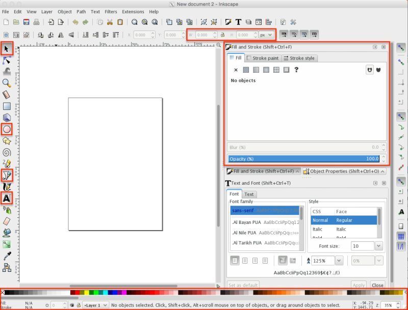

You’ll see a screen with a lot of icons and menus. It might look a little different, so find the items we’ve circled in red that we’ll use for this tutorial.
- Along the left side in this picture, the tool menu offers the select tool, the circle tool, the pen (or Bezier) tool, and the text tool.
- Near the top, you’ll see some boxes for adjusting the height and width of shapes.
- On the right, there’s room for several dialog boxes. If you don’t see these, you can click “View” in the menu, then “Show/Hide Dialogs.”
- At the bottom you’ll see the Palette. If you don’t, go to the “View” Menu, click “Show/Hide,” and then select the “Palette.”
- In the middle, there’s a picture of a blank page – that’s where you’ll draw!

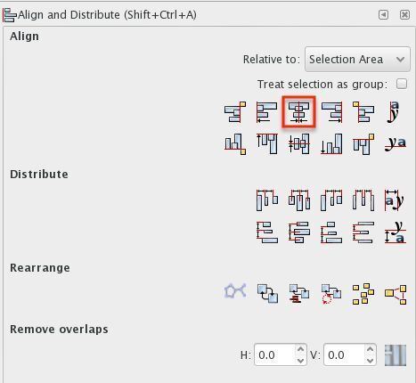

Align Shapes
To center things neatly, hold shift and click each element that you want lined up. Click Object > Arrange, then choose the “center” icon.

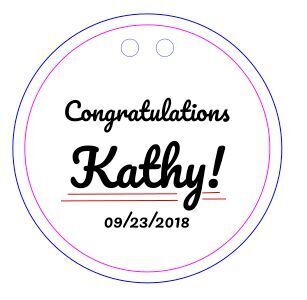

Congratulations - Your Design is Complete
- Go to the “File” Menu and click “Save As”
- Type your File name
- Choose “Plain SVG”

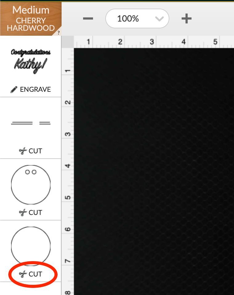

Your design will open in the Workspace. Each color in your drawing will appear as a separate print step on the left side of the screen.
Select A Step

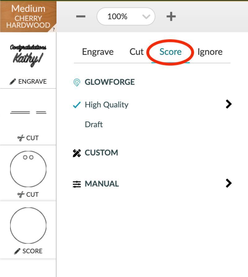

Click on the step showing the single circle (the one that was pink). Then click where it says "cut" below the thumbnail of the circle.
Convert to score
In the window that opens, click on “Score” near the top, so it prints this circle with a score line instead of cutting it out.
Repeat this process for the lines that you drew so they are scored as well
