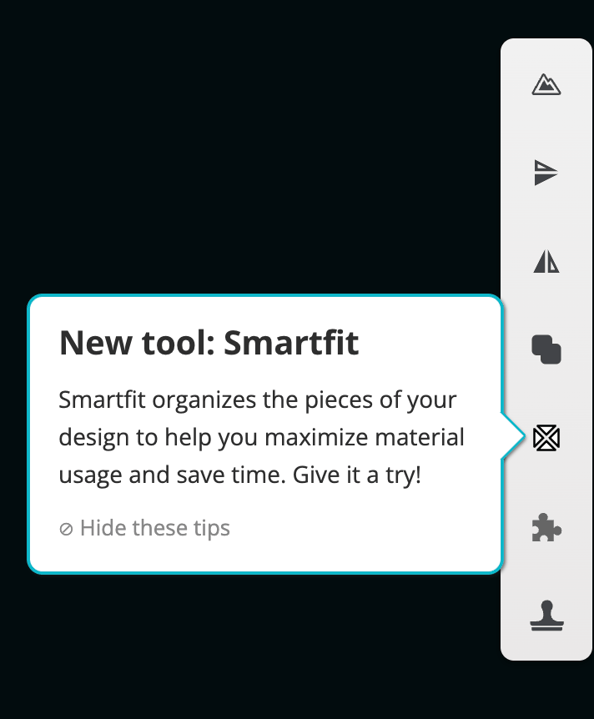

  3. Click-and-drag to highlight all the shapes in your workspace you want to Smartfit. Selecting multiple shapes at one time will make the Smartfit icon appear in the right menu bar.
4. Smartfit will arrange the selected shapes to fit within that area as efficiently as possible.
