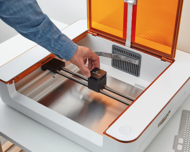

- Open the lid and move the Laser Head to the center of the rails.
- Lift your laser head off the magnetic dock.
- Grasp the black connector at the back of the laser head. Pull back on the connector to unplug it.

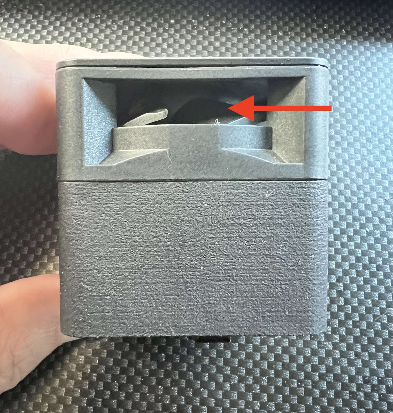

- If you see buildup on the fan blades inside the head, perform the steps in our guide on Air Assist Cleaning.

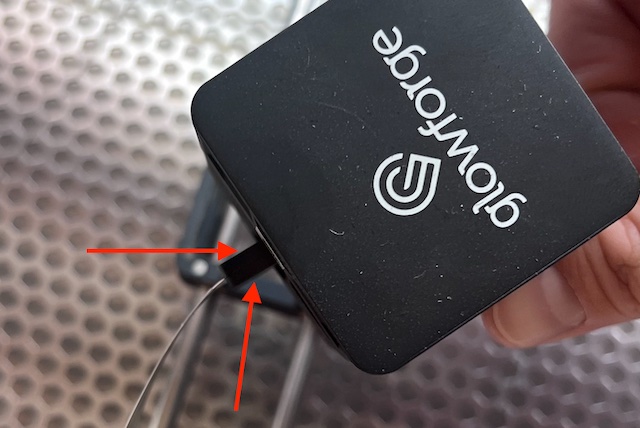

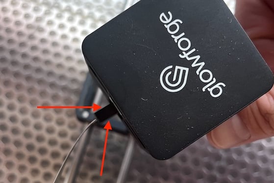

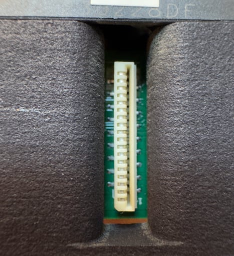

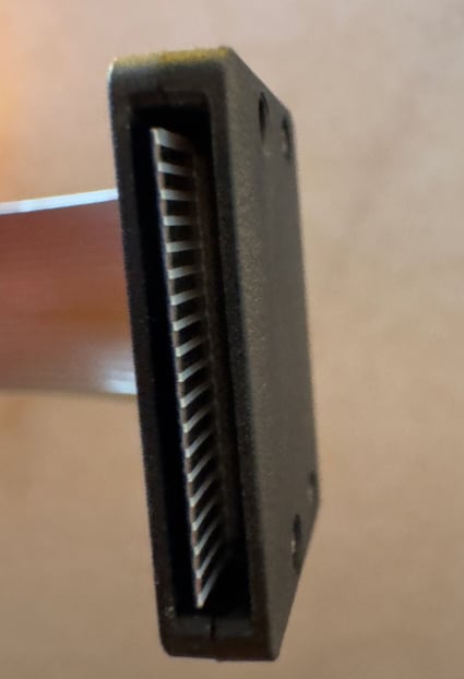

- Check the connector on the laser head cable, as well as the cable plug on the laser head itself. Compare to the following photos:
If your cable connector or plug look different than the photos above, please take a photo. If components look damaged, please continue to step 10. - Plug the cable back into the laser head, taking care not to twist the cable. Once plugged in, it's normal for the cable connector to be able to move back and forth just a bit.
- Place the laser head back on the magnetic dock, with the cable connector to the rear and the Glowforge logo reading from right to left. It should snap into place.
