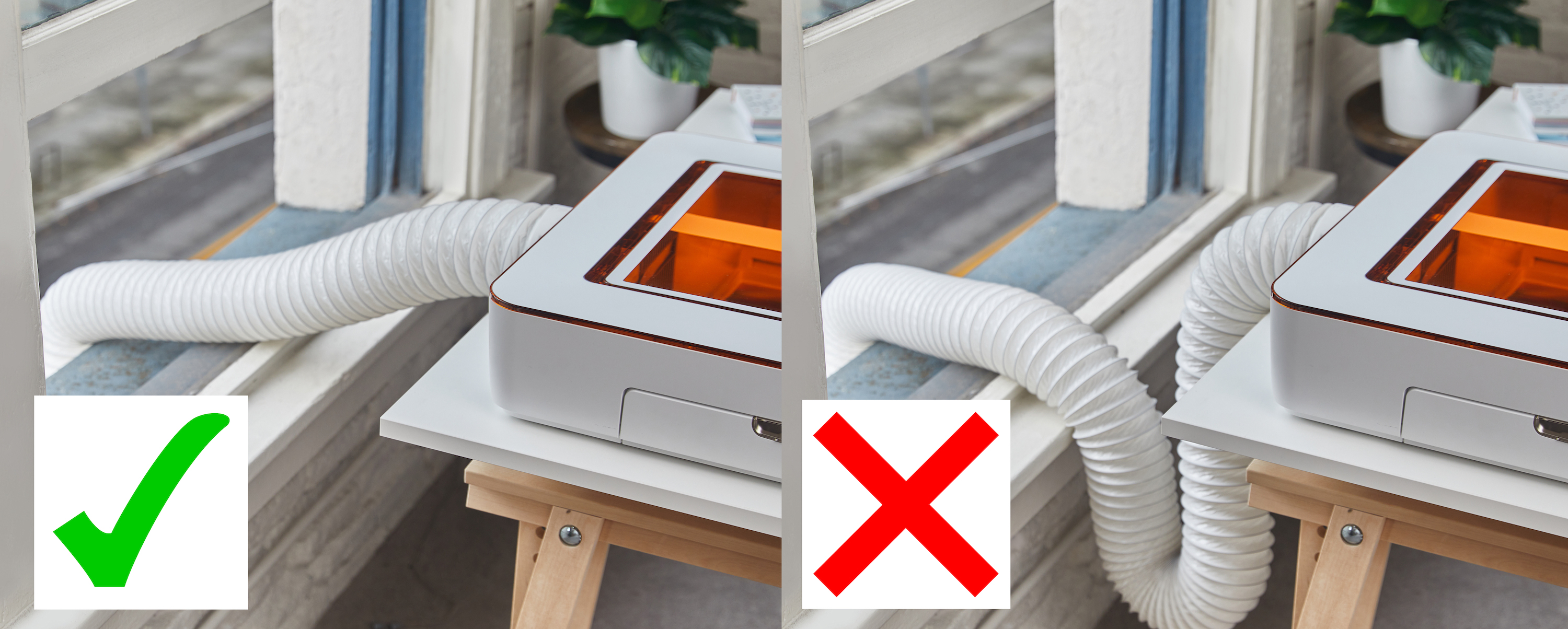

  • If venting out of a window, make sure the hose is positioned correctly to allow for good airflow.
    The example on the left shows correct exhaust hose setup. Avoid multiple bends in the hose where possible.
