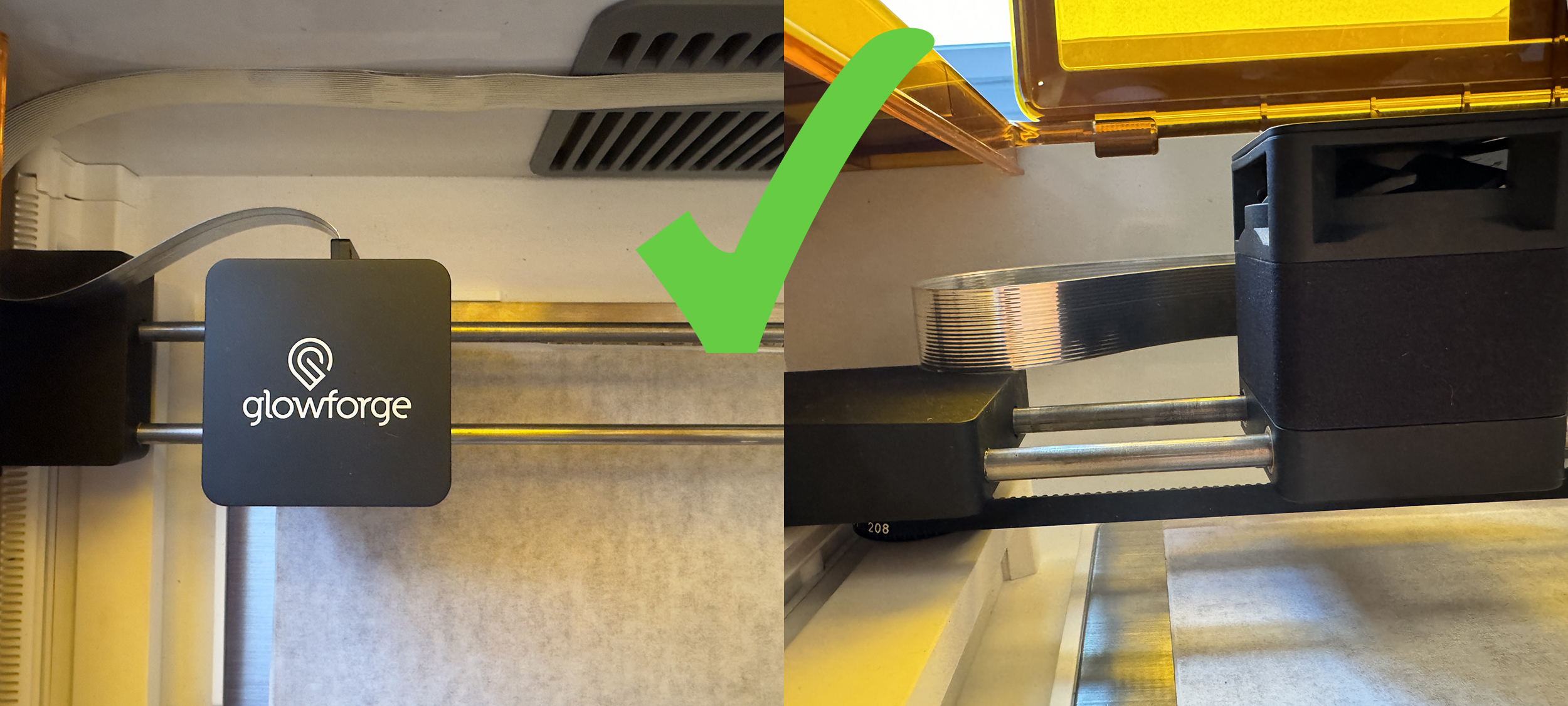

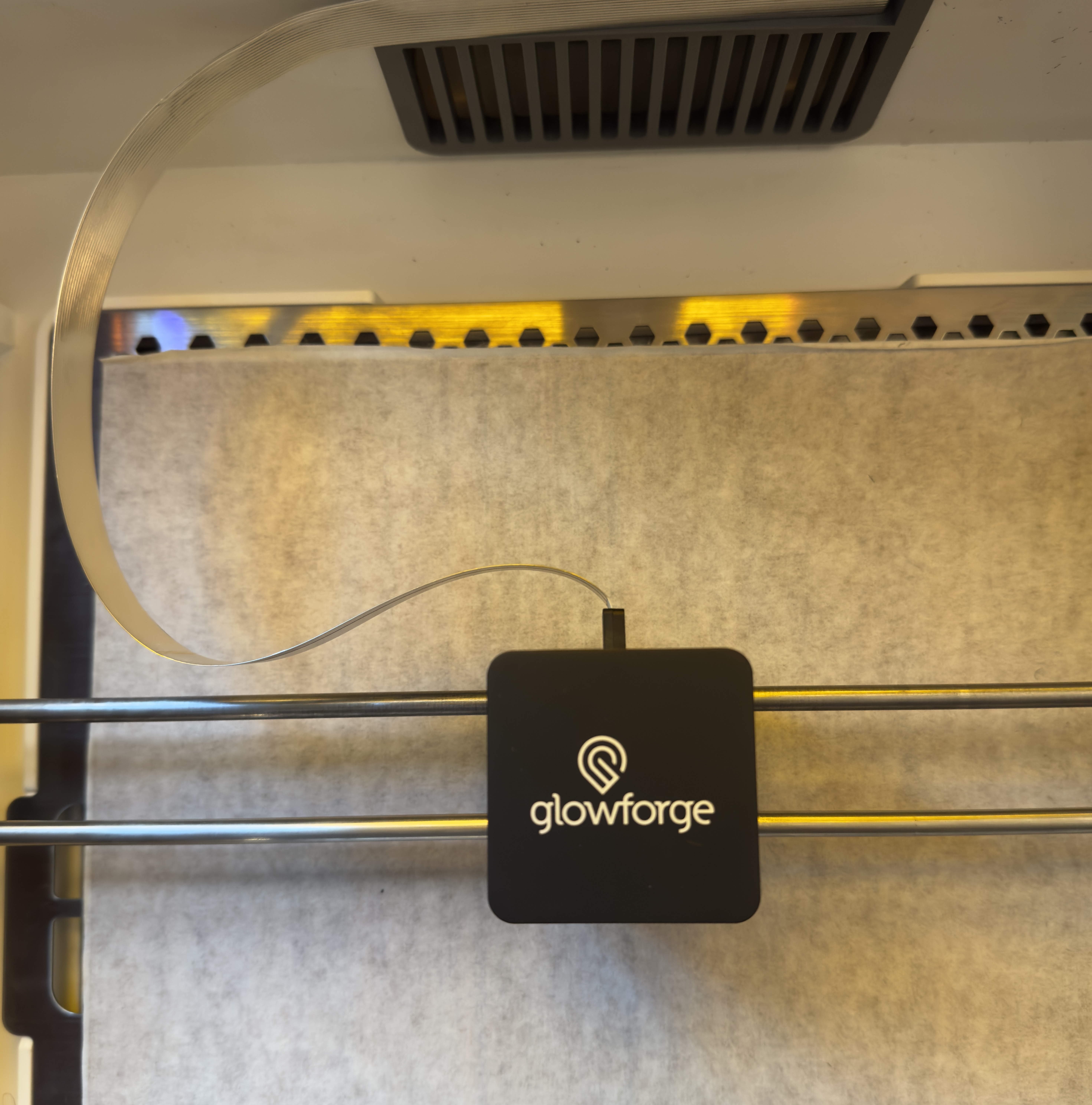

Check for Cable BindingWhen the laser head is installed on the magnetic dock, the Glowforge logo should read from left to right, with the laser head cable connected behind the head. Like so:
The cable is flexible enough that it should remain behind the laser head even near the rear of the printer bed. Though it's rare, it's possible for the cable to get caught between the laser head and the gantry end cap on the left hand side. Take a look at these photos for examples.
An example of good laser head cable position. The cable has cleared the gantry end cap to the left of the laser head.

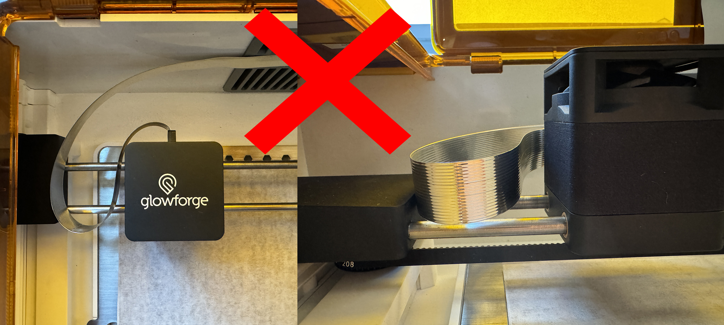

An example of poor laser head cable position. Notice the binding of the cable against the gantry end cap, and how the cable loops between the head and the end cap.
When the cable is bound between the gantry end cap and the laser head, it will restrict movement of the laser head in the upper left of the print area. If the head keeps moving to the left, it can cause the cable to suddenly “spring” over the end cap, resulting in poor print results in that area as the laser head moves suddenly to the left.

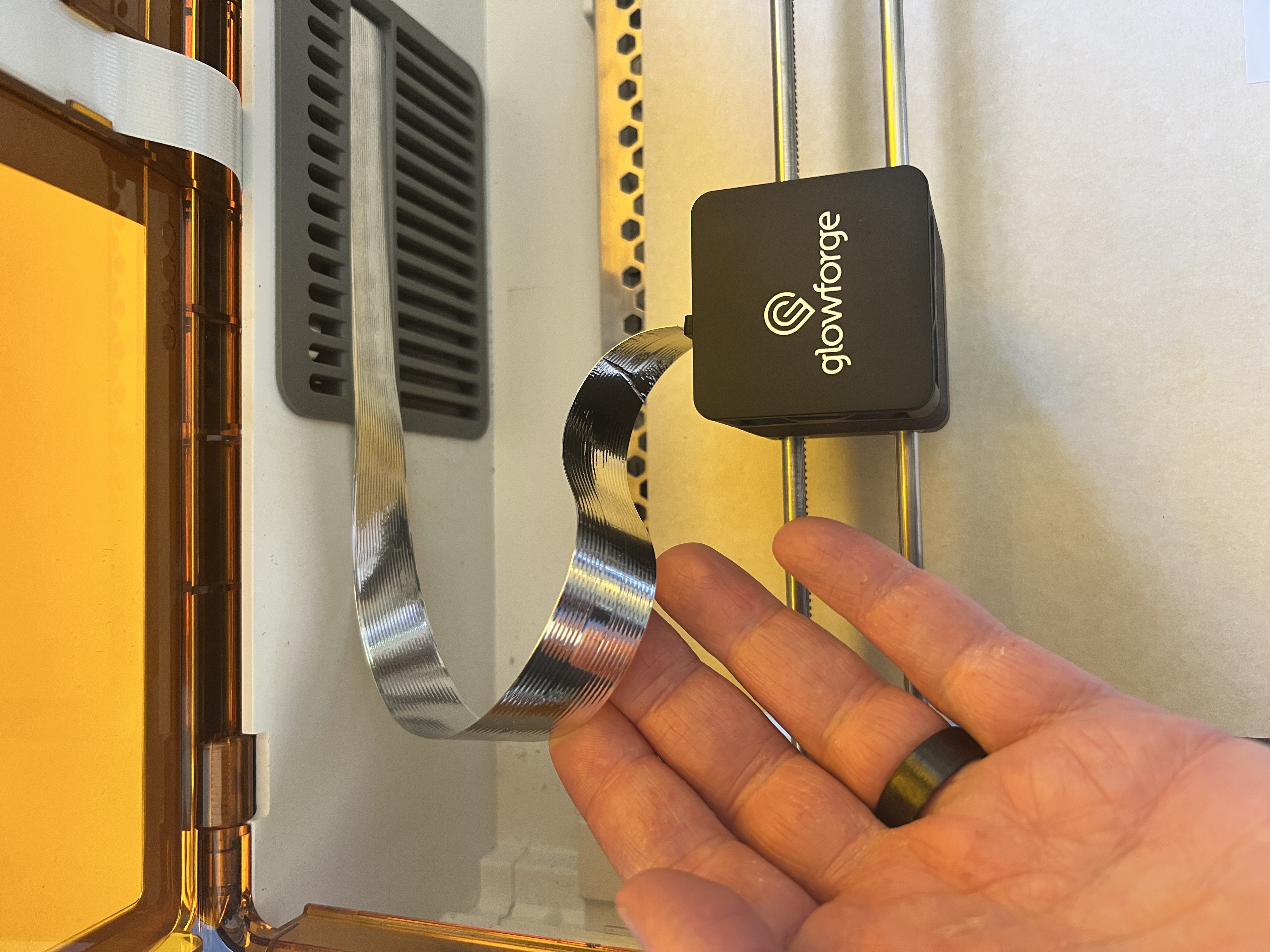

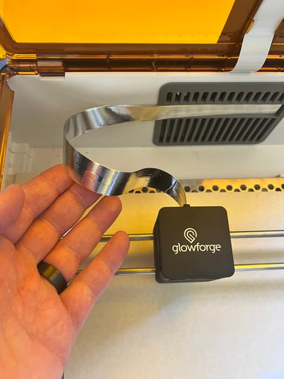

Lift up on the Laser Head ribbon cable from the underside, as shown in the photo below.
Hold the cable in this position for about 30 seconds. Don't be afraid to apply a bit of upward pressure!
