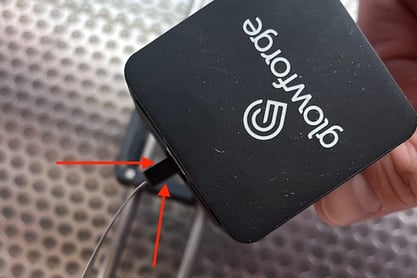

Grasp the black connector at the back of the laser head. Pull back on the connector to unplug it.

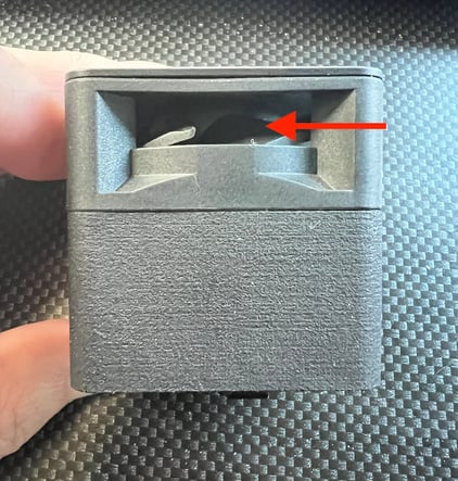

Clean the fan blades with isopropyl alcohol (we recommend 90% or higher) on Q-tips, in the area shown below.
Once the fan blades are clean, you can blow out the fan with some compressed air.
While blowing out the fan, make sure to only use the compressed air from the top of the laser head and place your fingertip in the side to keep the fan from spinning. This will prevent any loose debris from falling into the laser head.
