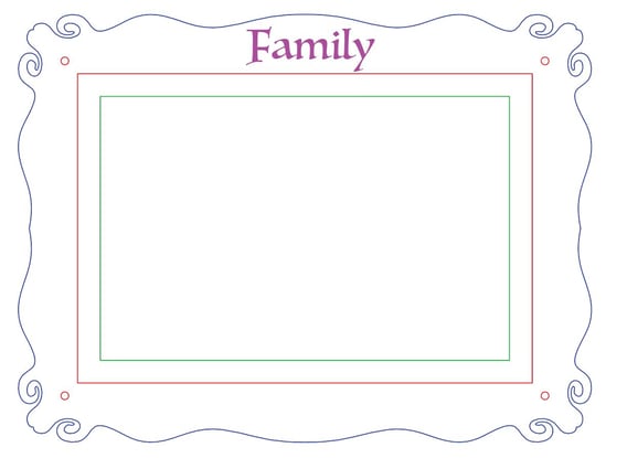

The simplest way to set up the order of your print is to adjust the steps in the app. Here’s an example using the following design for a picture frame:
Screenshot of a design for a picture frame
The design has text and multiple closed paths, all using the same color. For the purpose of this example, the text is to be engraved, the border around the photo is to be scored, and the holes in the corners, the opening for the photo and the border are all to be cut.
The following print step order would help to ensure that all steps have the best focus and positioning:

If everything in this design is left the same color, they will all be one step. To make it into separate steps and arrange the print order:
  1.  Assign each element of the print a corresponding color:
  2.  Save the SVG so it can be uploaded to the Glowforge app.

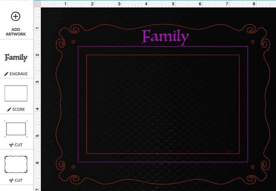

  3. Upload the file to the app. You will see the separate steps.
    Screenshot of a design for a picture frame imported into the Glowforge App
  4. Click and drag each step shown on the left to rearrange the order in which the steps will print. In the following image, this print has now been set up to engrave, score and then cut in a specific order.
  5. Print! When this design is sent to be printed, it will print in the order shown from to bottom. First it will engrave the text, next it will score the border line around the photo, then it will cut out the photo area and corner holes and finally it will cut out the outline of the frame.

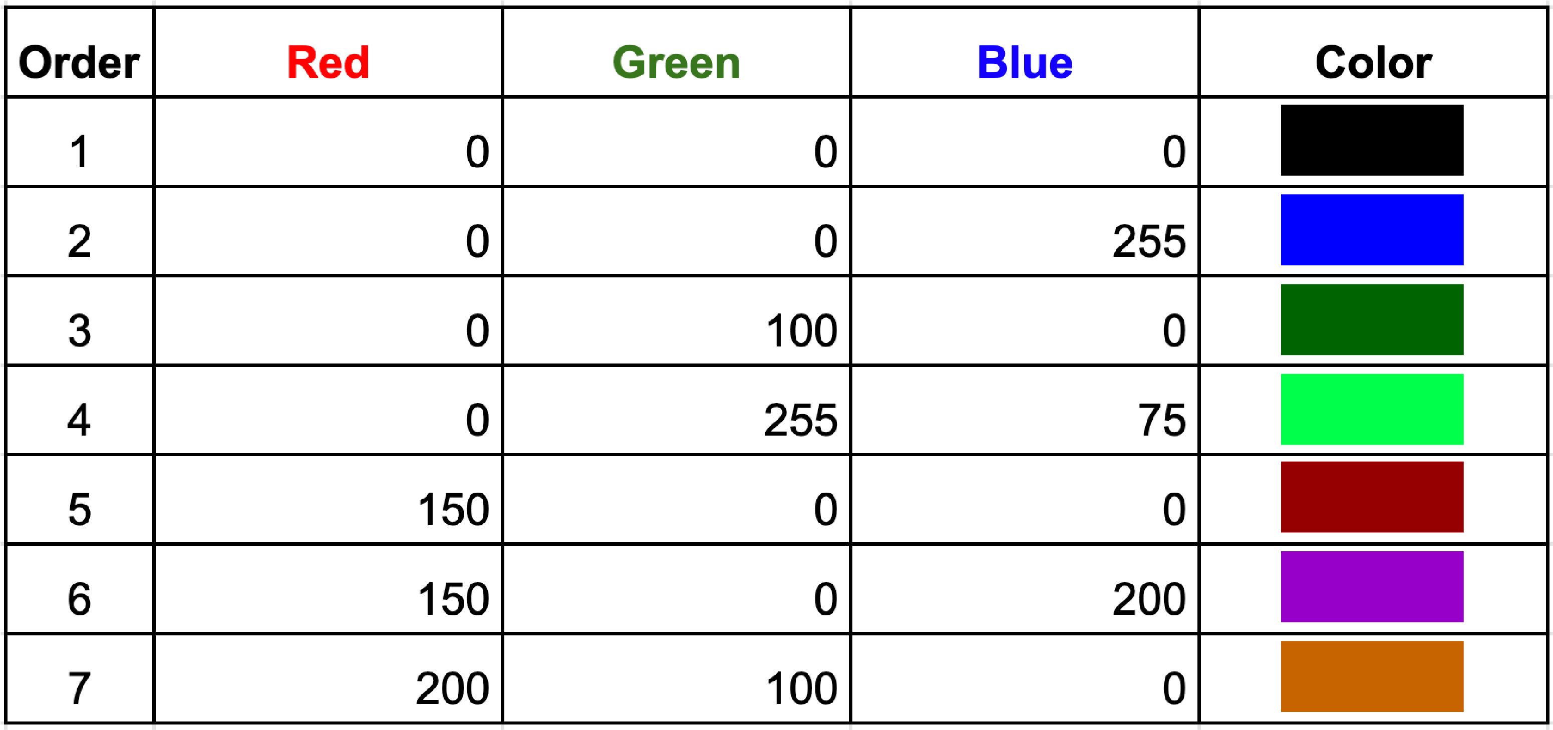

Designs can be created so that they will automatically upload into the Glowforge app in a desired order. When a vector design is loaded in the app, certain colors are always loaded before others.
Here is a handy chart containing a list of colors and their RGB values showing the order in which they’ll show up in your print steps:
Color chart with RGB values shown
In the left image below, each number has been set to its corresponding color from the chart above. The right image demonstrates how the elements appear when the file is uploaded into the app.
