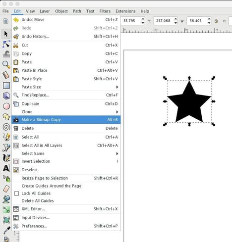

- Click on the selection tool
, and then choose the object or objects you want to rasterize. - With the object(s) selected, click Edit > Make a Bitmap Copy.
- A copy of the object will appear as a new raster layer.
- To delete the vector layer, click Object > Lower to Bottom, then click on your shape again and press the delete key.
