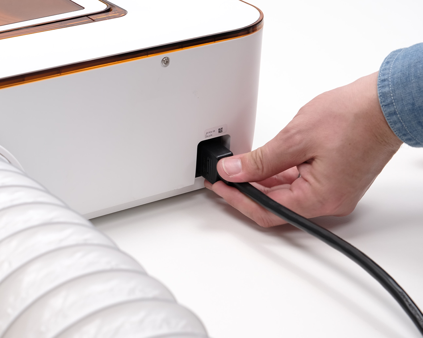

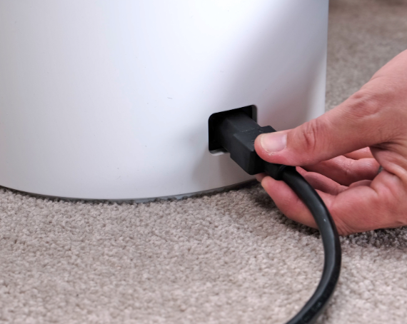

- Disconnect from power
Disconnect your Glowforge Aura from power by unplugging the power cord from the back. If you’re using a Glowforge Personal Filter, also disconnect it from power.

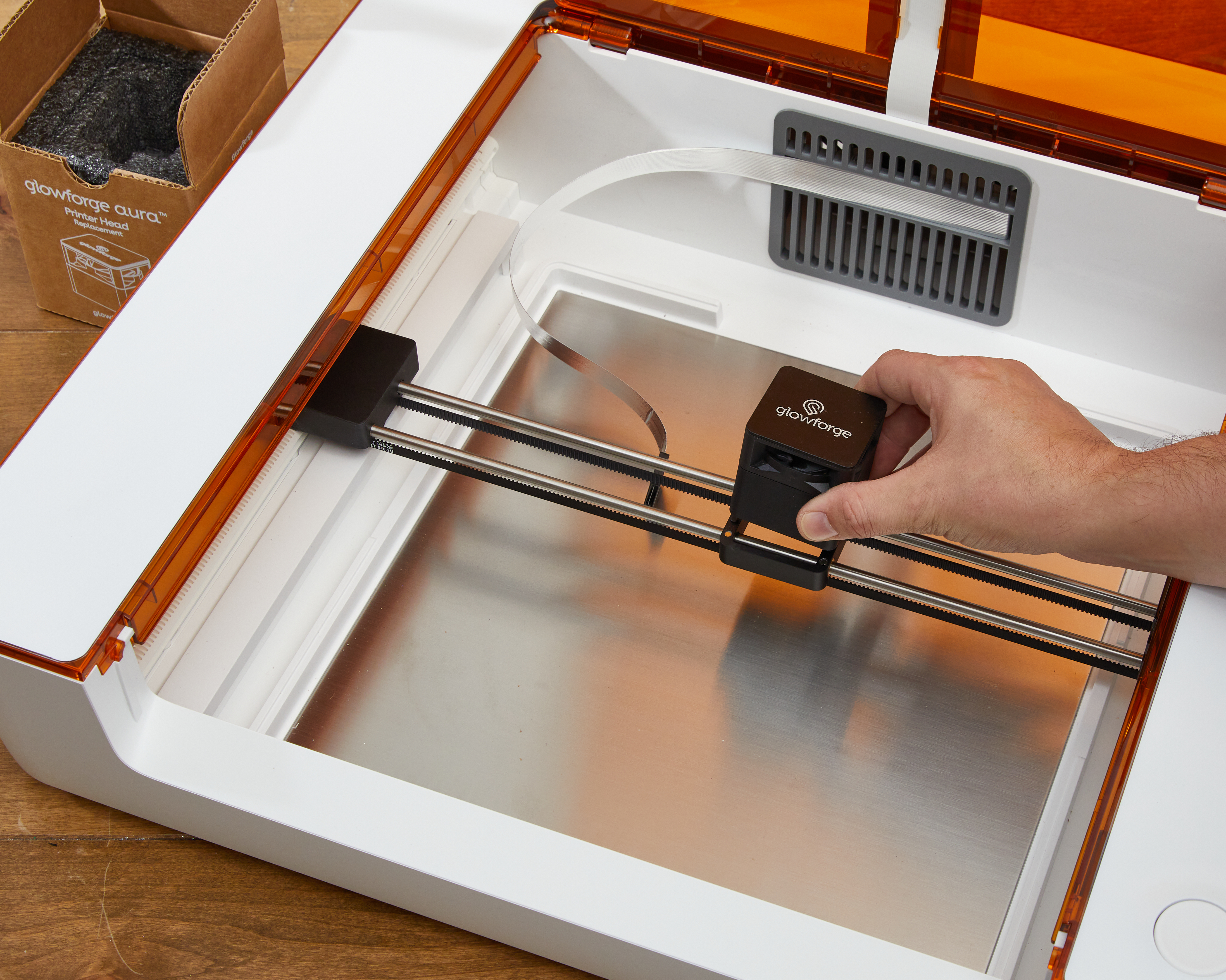

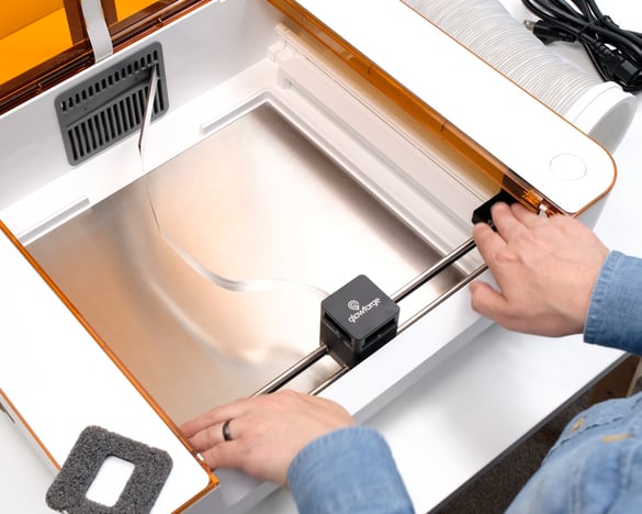

Holding on to the laser arm end caps, move the laser arm to the center of the bed.
Gently push the laser head to the center of the rails.
With one hand, hold onto the laser head. With the other hand, grasp the black connector at the back of the laser head. Pull back on the connector to unplug it.
Lift the laser head from the magnetic dock, and set it aside in a safe location while you set up your new Aura body. - Unbox your Aura body

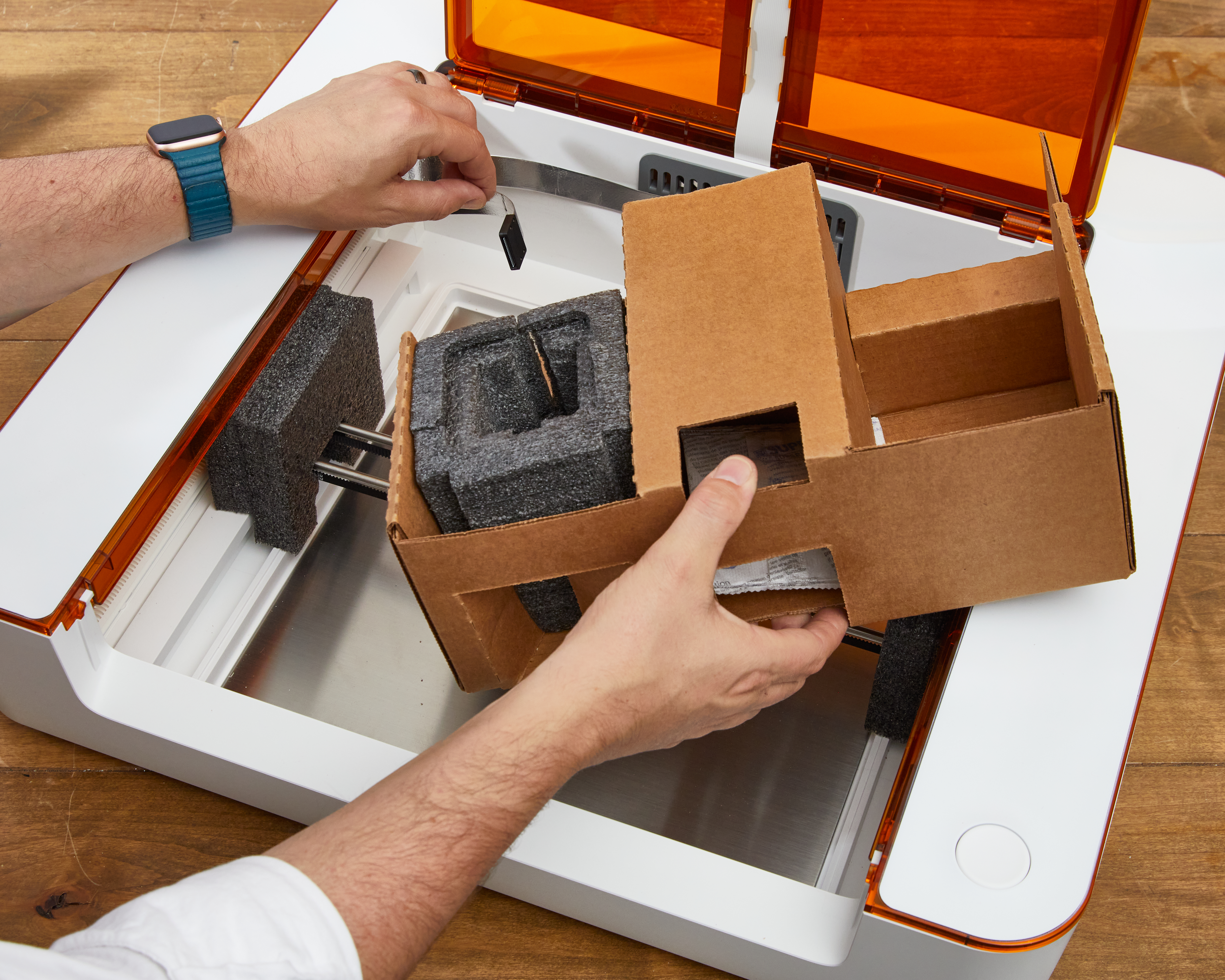

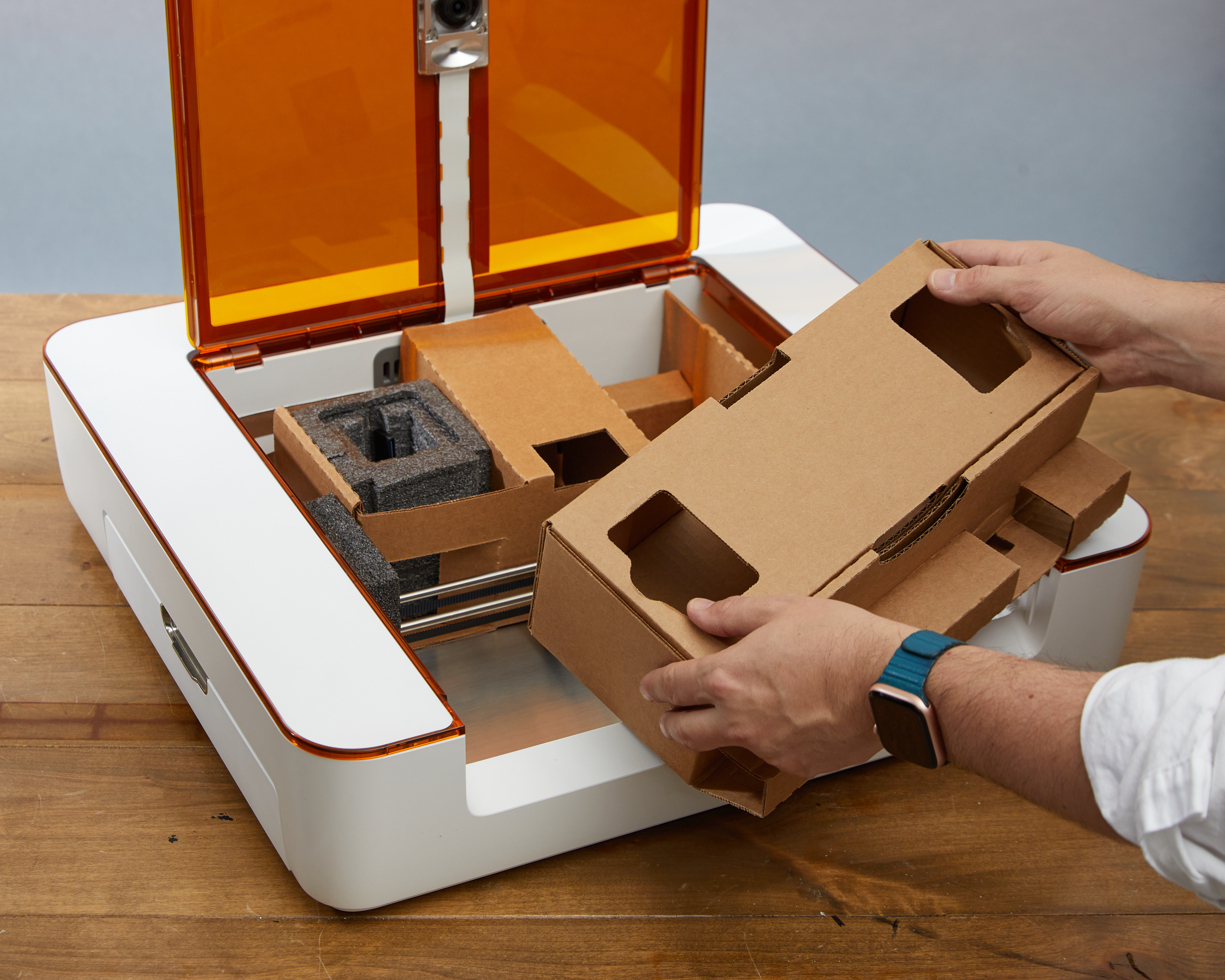

Open the lid. Remove the bottom cardboard insert.
In the top cardboard insert, find the laser head cable in a foam cube. Remove the top cardboard insert with one hand. Taking care not to twist the cable, pull it from the foam cube with the other hand.
Let the laser head cable rest on the bed of the printer for now. - Install your laser head

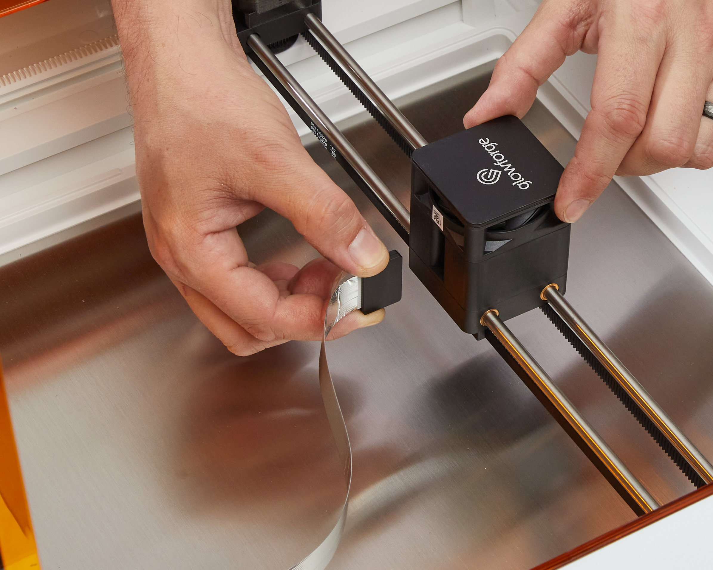

Set your laser head on the dock with the laser ribbon cable port at the back and the Glowforge logo reading left to right. You’ll feel it magnetically snap into place.
With one hand, hold onto the laser head. With the other hand, plug the laser ribbon cable into the laser head. Again, take care not to twist the cable.

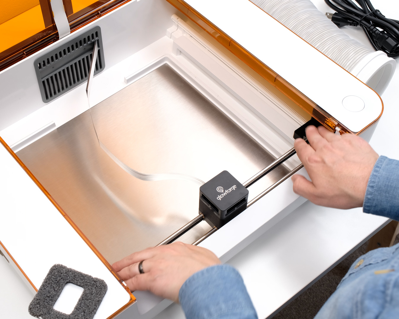

- Prepare the laser arm

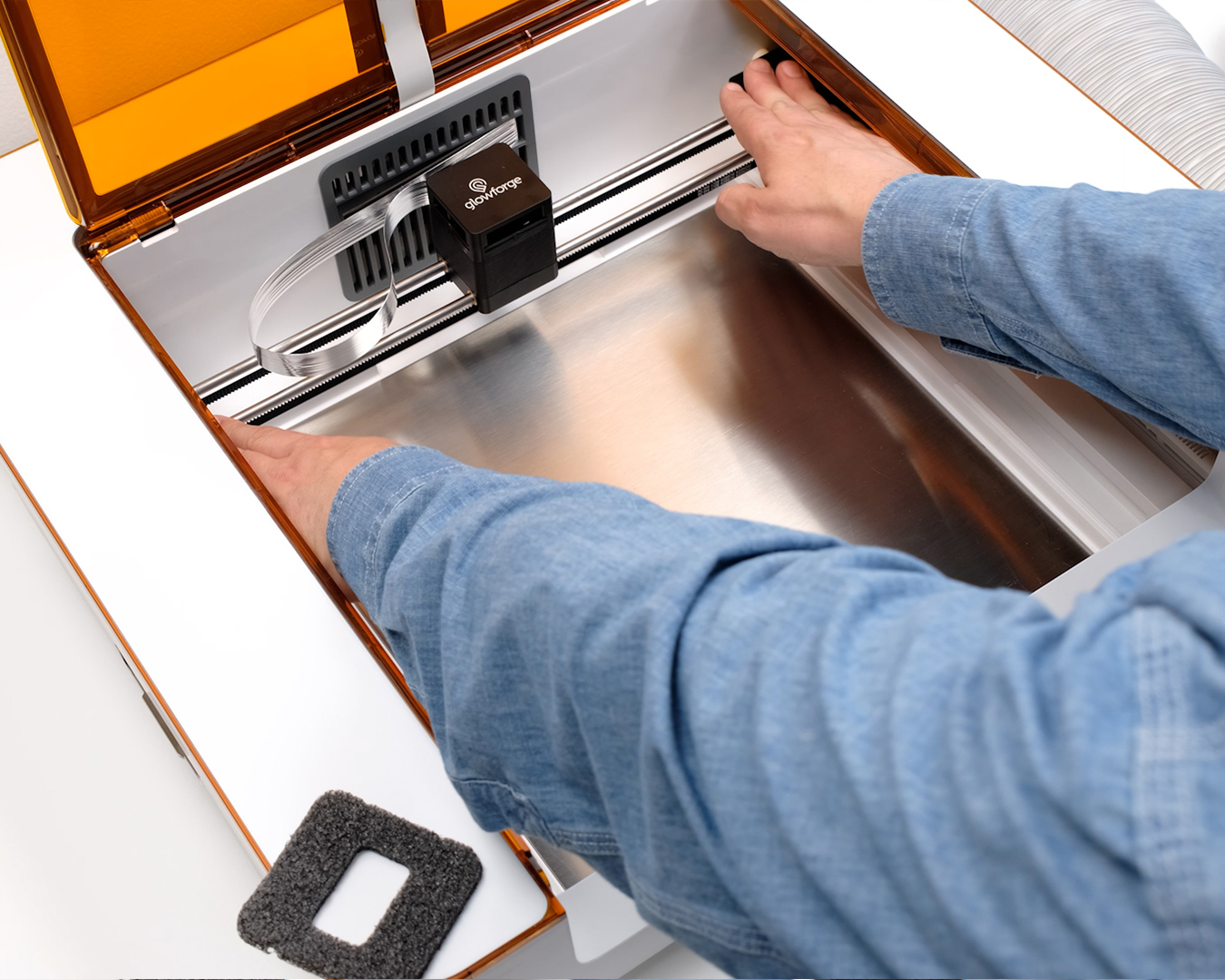

You may find some foam pieces tucked under the rails on the left and right side. Gently remove them by pulling out, then up, and store them with your other packaging.
Place your hands on the black end caps on either side of the laser arm. Gently pull the laser arm all the way to the front. Apply a bit of pressure to make sure both end caps are flush with the front. If the laser arm was skewed at all, you’ll feel it snap into place.
Now, still holding on to the end caps, gently push the laser arm all the way to the back. Again, apply some pressure to make sure both end caps are flush with the back.

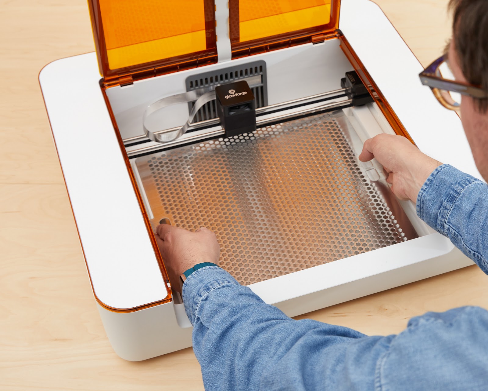

- Slide your cutting tray into your Aura
The handles on the left and right sides will slide into the notches on either side of your printer. You should have a snug fit.

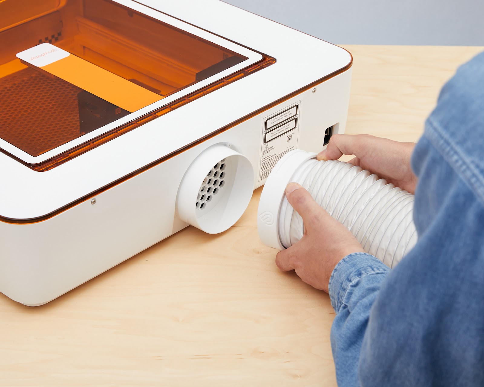

- Attach your exhaust hose
Slide the rubber ring over the lip that extends over the exhaust area. Push it on as far as it will go. It should be a snug fit all around, and should not come off with a gentle tug.

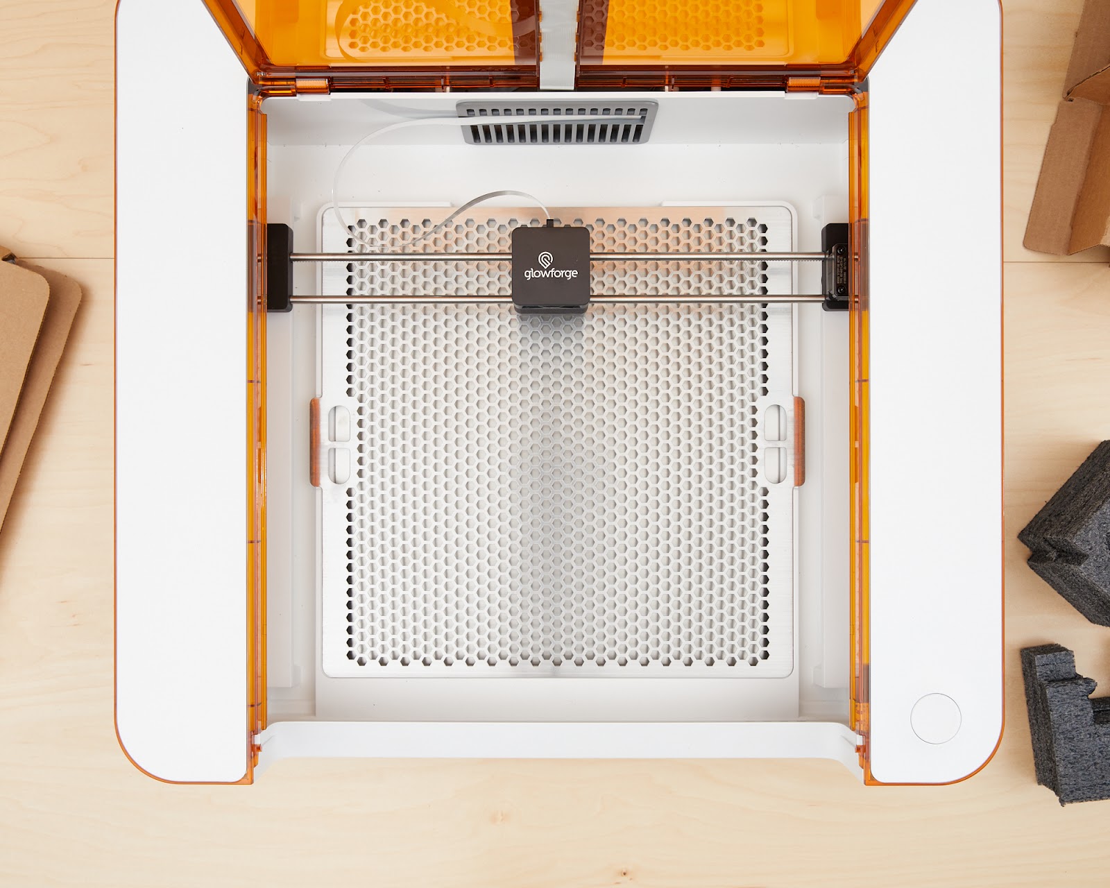

- Just a few steps to go! Your printer should look like this
- Close the lid on your Glowforge Aura, and plug it in.

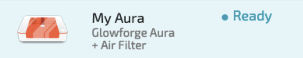

To verify that your Glowforge Personal Filter is paired and ready to filter, you can check the App.
In your web browser, navigate to app.glowforge.com and sign in.
Then, click on your Glowforge Aura printer icon in the upper right corner.
When your Personal Filter is paired to your Glowforge Aura, you’ll see a “+ Air Filter” along with your Glowforge Aura.
