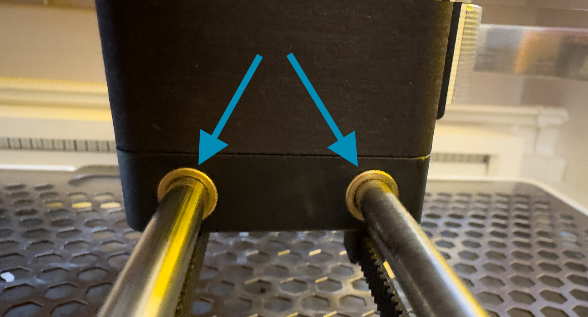

If the rails get dirty, you’ll experience misaligned prints and double images.

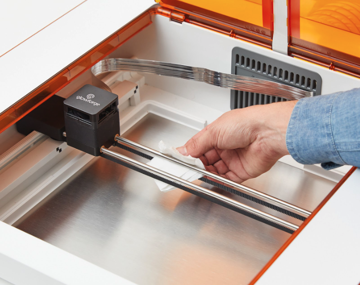

  • You should clean the rails every ten hours of printing, but you may need to clean them more often depending on what you're printing.
  • Wipe down the silver laser rails with a lint-free cloth and some isopropyl alcohol.  We recommend using 90% or higher isopropyl alcohol.
  • Be sure to clean all around the rail as you go - don't forget the underside of the rails!
  • Also clean the areas on the magnetic dock where the rails slide through.  Buildup can occur on each side of the bushings.
  • Be sure the rails are completely dry before you get back to printing.

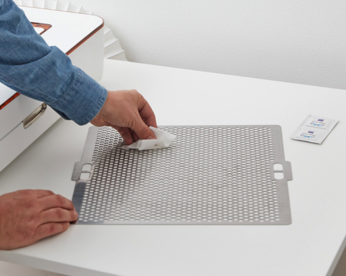

To remove the cutting tray, lift it up using the tabs on the right and left sides of the tray, and pull it out. Wipe the surface of the cutting tray using a cleaning wipe (such as a Lysol wipe or similar). Use a cotton swab to gently remove any bits that have gotten caught in the metal grid.

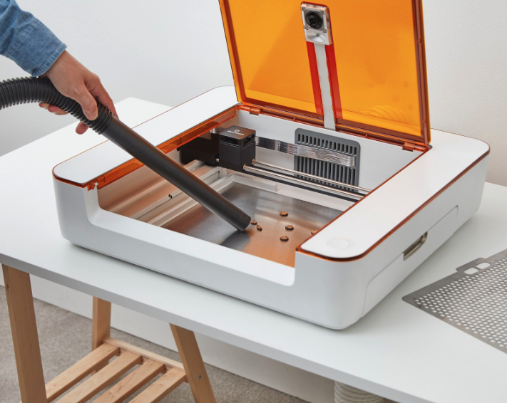

With the cutting tray removed, remove, sweep, or vacuum out any tiny remains of past projects that have fallen onto the printer floor. Wipe away any remaining bits with a cleaning wipe.

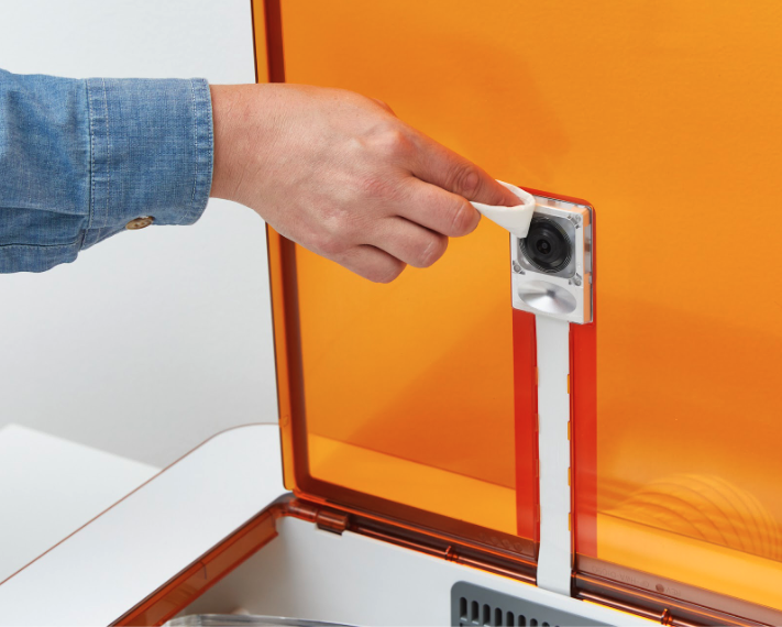

If you notice buildup on the diffuser, or if your camera images are dark, gently use a lens cleaning wipe (such as a  Zeiss lens wipe) to wipe it. Take care not to apply excess pressure to the diffuser when cleaning.

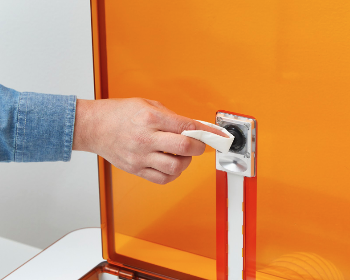

You can also use a lens cleaning wipe to remove any dust and buildup from the lid camera lens.
