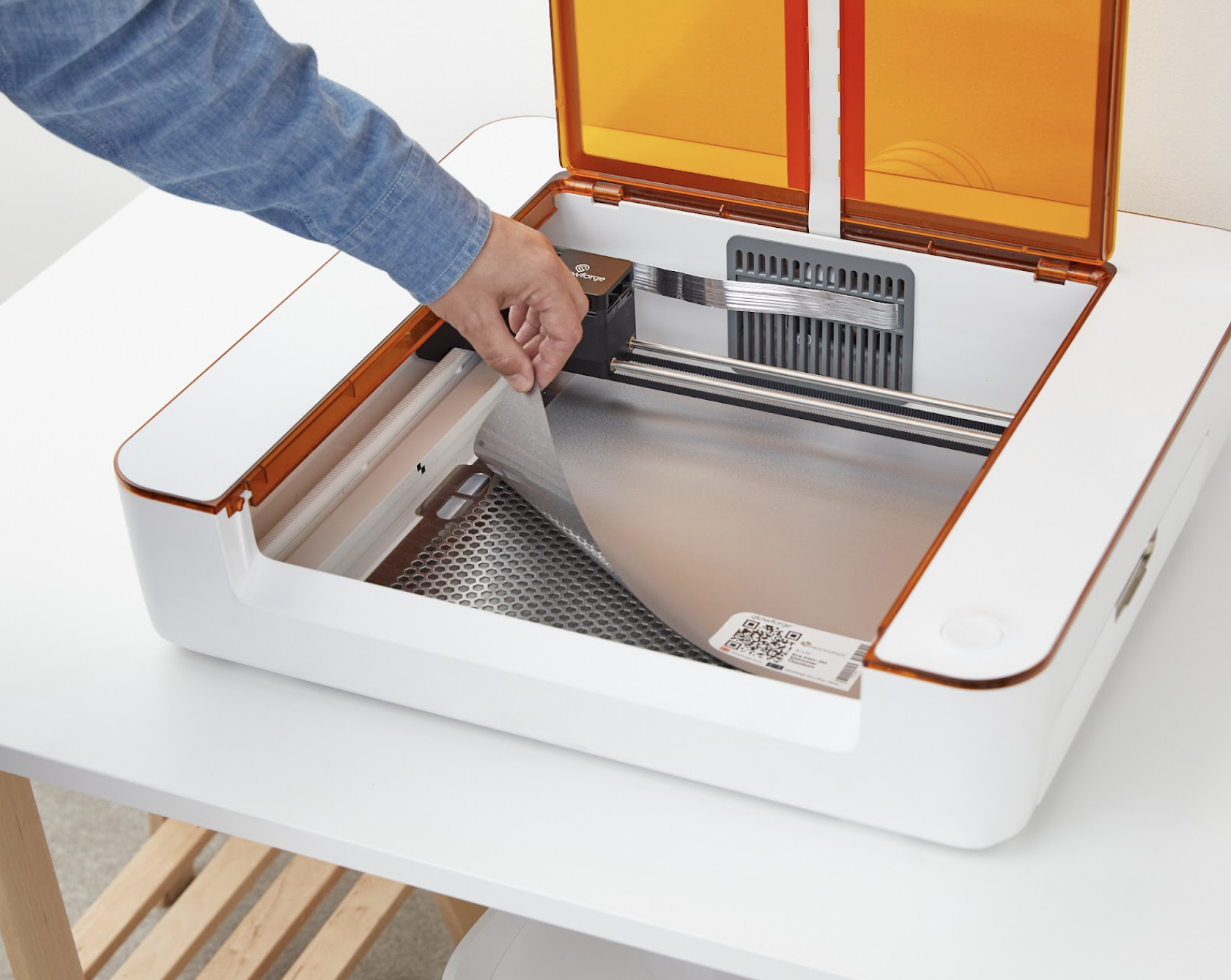

When you put the material in your Glowforge Aura, place it flat with the QR code facing up.
Once your design is printed, you’ll put the transfer material face-down on your fabric, apply heat, and then remove the backing material.

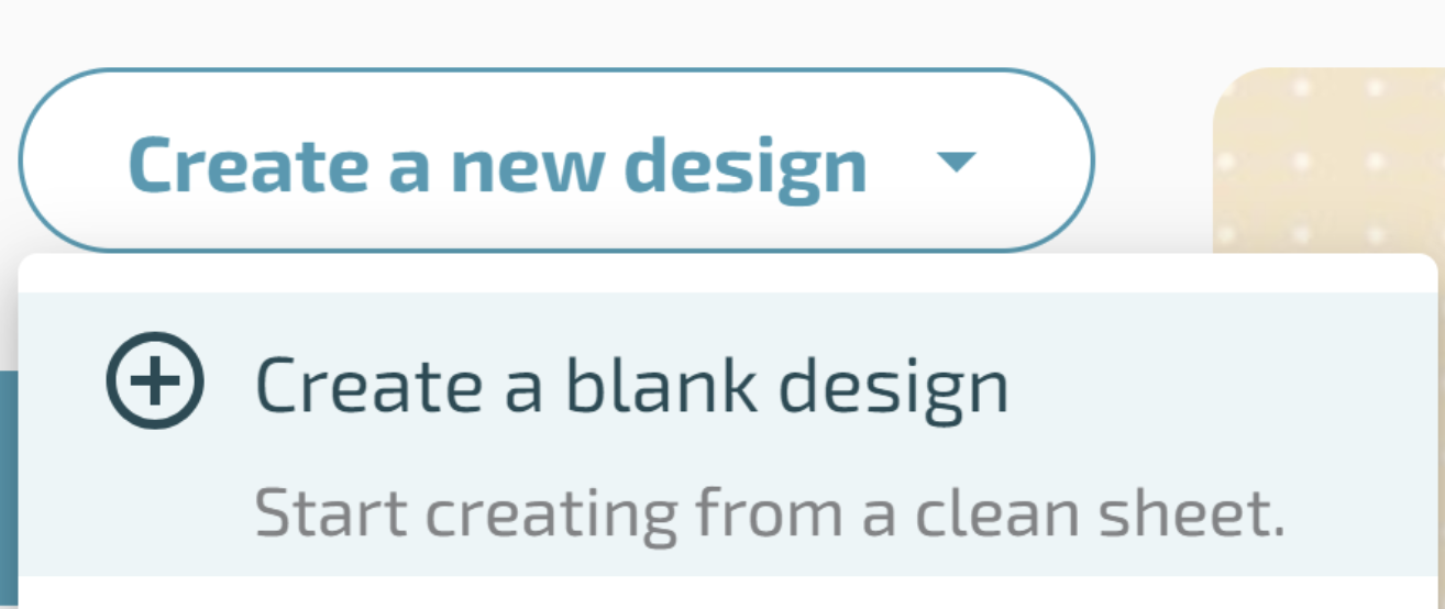

To start, head to your Dashboard at app.glowforge.com. Click on “Create a New Design,” then choose “Create a Blank Design.”

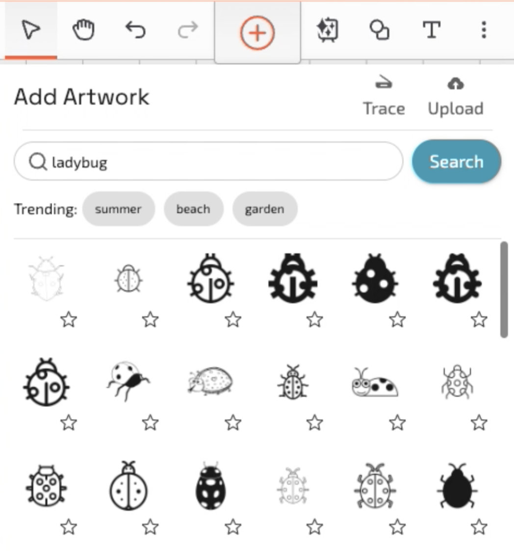

- Add some pizzazz with artwork

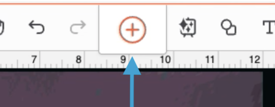

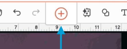

Click the “+” button in the middle of the top toolbar to add artwork to your blank design.
With Premium tools, you have access to a graphic library with over 5 million pieces of vector art.
Type in a keyword in the search bar, and click “Search.”
Click on a graphic you like, and it will be added to your Workspace. - Personalize it with text

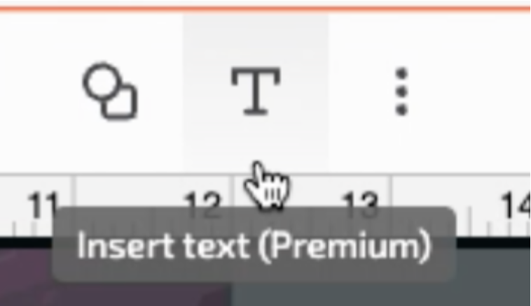

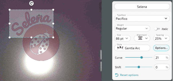

Let’s add a bit more customization with a name.

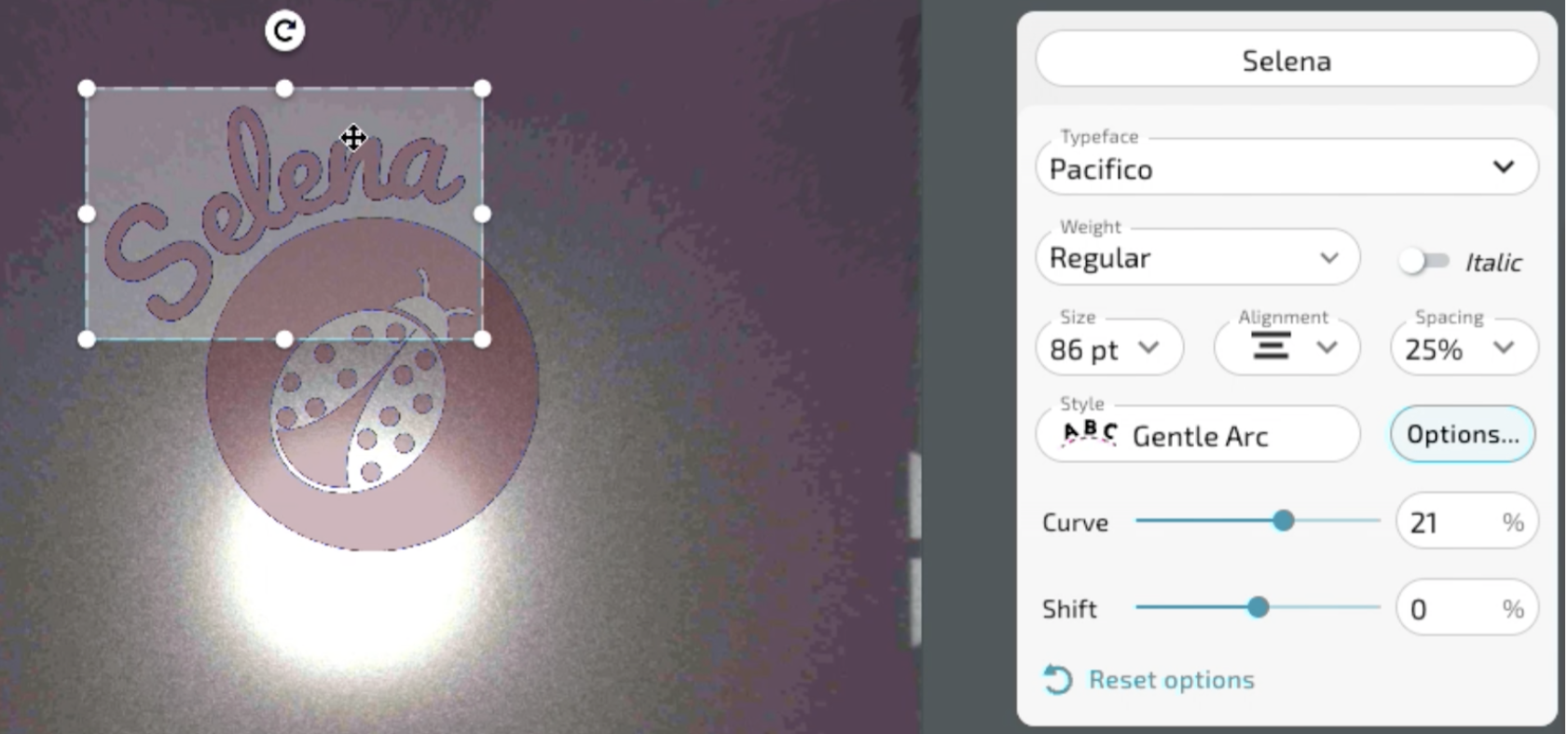

Click on the Text tool in the top toolbar.
Type the name into the text box at the top, and then use the options to customize the look of the text.

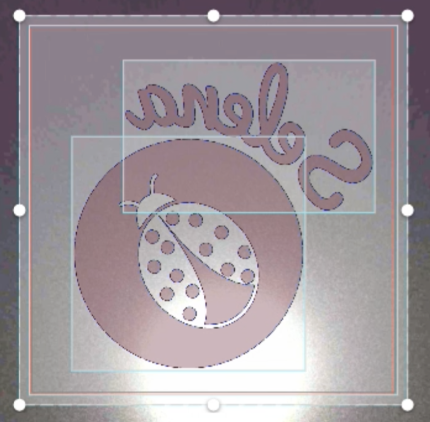

Using the Select tool, drag and select parts of your design and move them right where you want them. - Add a Cut-Out

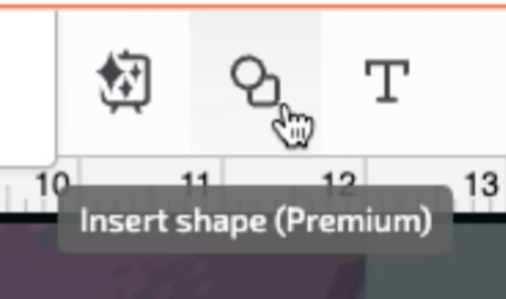

Click on the Insert Shape tool, and insert a square.
Click and drag the white dots at the sides and corners of the shape to resize it. Then, using the Select tool, move the shape to fit around your design. Give yourself enough room around the edges to peel the backing away later.

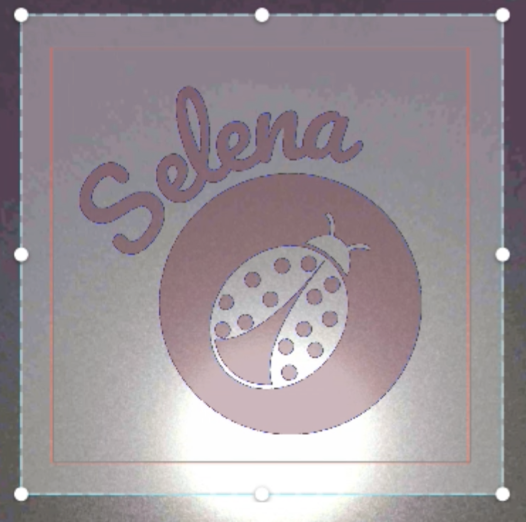

- Flip that!
Once you have the design and cut-out just right, you’ll want to mirror everything so the iron-on looks right. Otherwise, you’ll have backwards letters on your final project.
Select everything in the Workspace by pressing Ctrl+A (Cmd+A on a Mac).
Then, from the toolbar on the right side of your workspace, select “Flip horizontal.” That’s the pair of triangles pointing up.
Now, the entire design is mirrored!

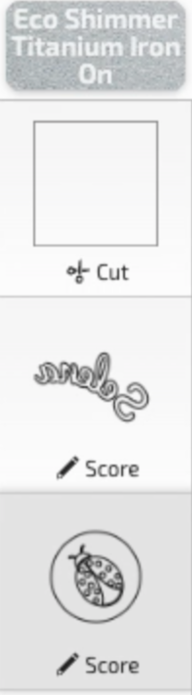

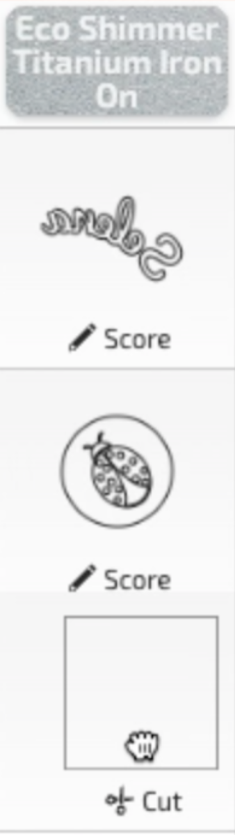

- Check your Steps and Settings
This project has three print steps - the graphic, the text, and the square.
You want the graphic and text to be set to “Score,” and the Square set to “Cut”. Click on the word to change the setting if it’s not right.
Click and drag the cut step to happen last.

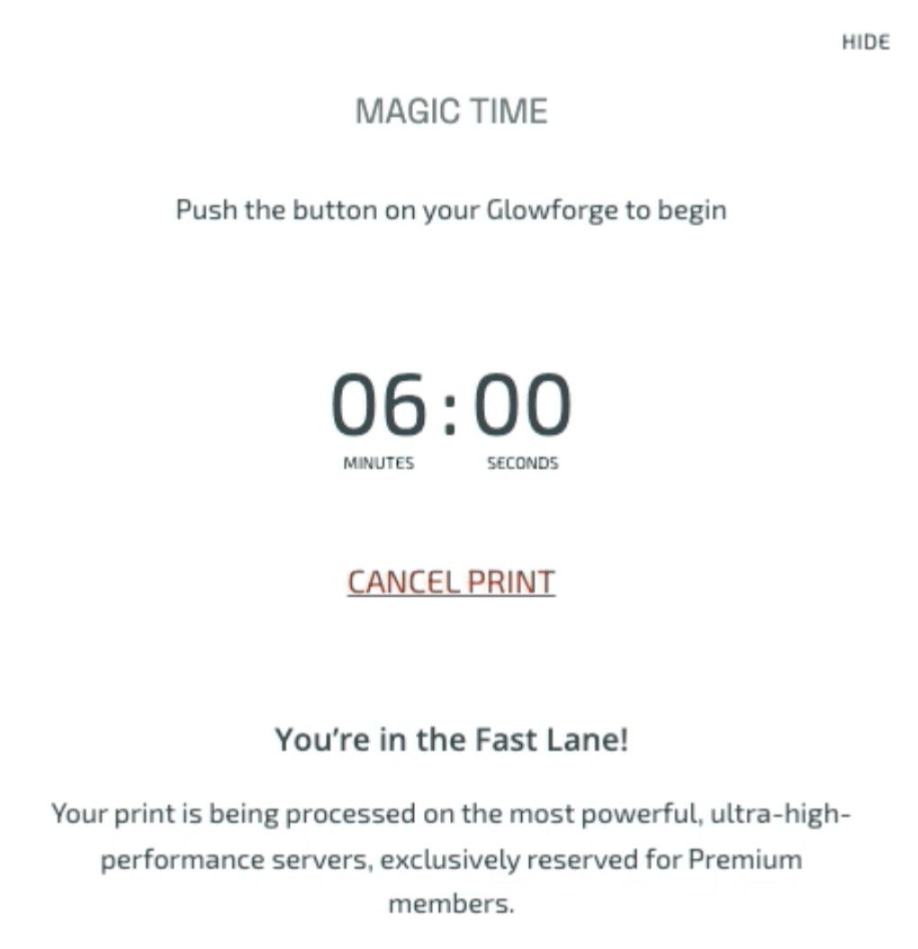

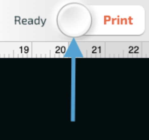

Click “Print” in the top of your Workspace.
The software will take a moment to prepare your design. When everything is ready, you’ll see the estimated printing time.
The button on your Glowforge Aura will blink. If you’re using a Glowforge Personal Filter, its button will also blink when a print is ready to start.
Press the button on your Glowforge Aura to start your print.

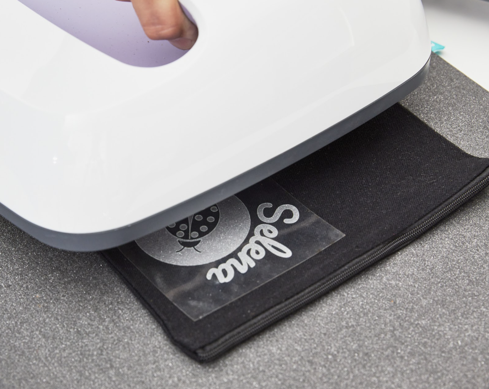

Once it’s ready, place your design onto the fabric with the shiny side facing up.

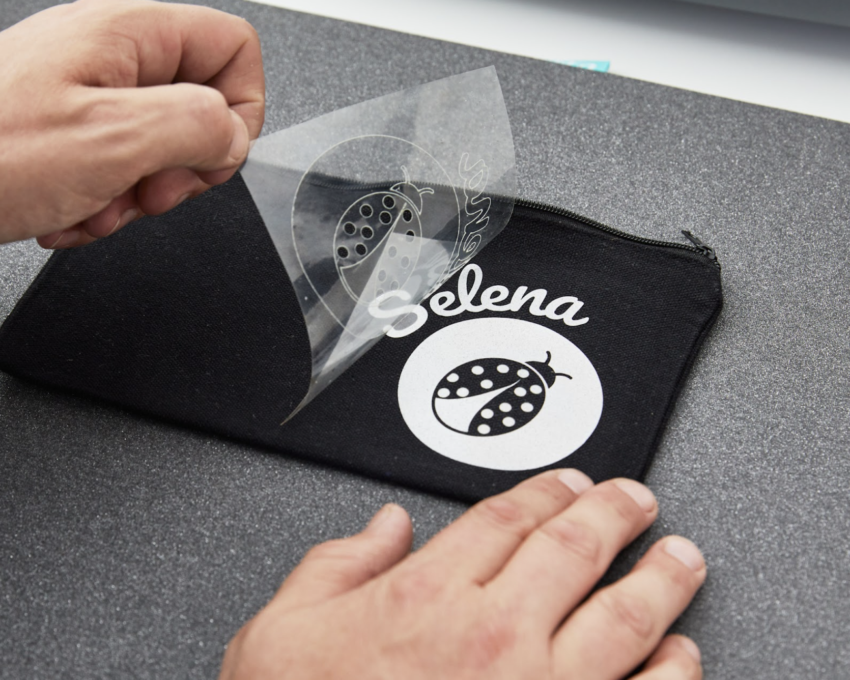

With an iron or press at 340° Fahrenheit, evenly apply heat for about 20 seconds. Then let the design cool for a few minutes.
After it cools, slowly peel the backing away from your design.
And now you have a gift ready for that special occasion!
