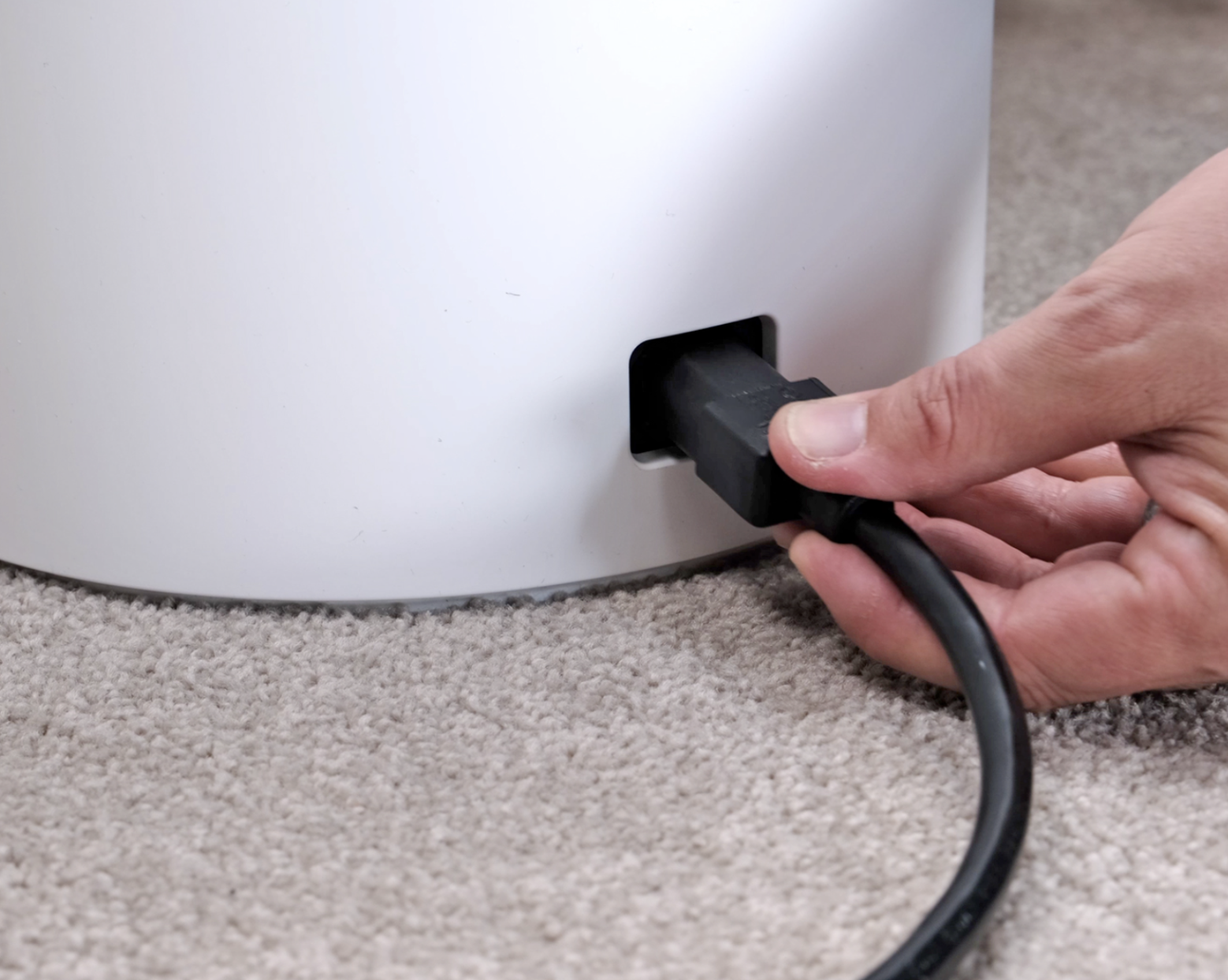

Unplug your Glowforge Aura and plug it back in so it is ready to find and pair with your Glowforge Personal Filter. - Connect your Glowforge Personal Filter to Power
Plug the power cord into the back of the Glowforge Personal Filter. Then plug the power cord into a standard grounded household socket.

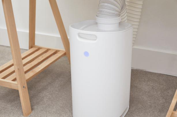

As soon as your Glowforge Personal Filter is plugged in, it will begin searching for your Glowforge Aura. The button on the front of your Personal Filter is a status indicator. It will blink blue for a few seconds when the Personal Filter is pairing with your Glowforge Aura. When pairing is complete, it will turn off.

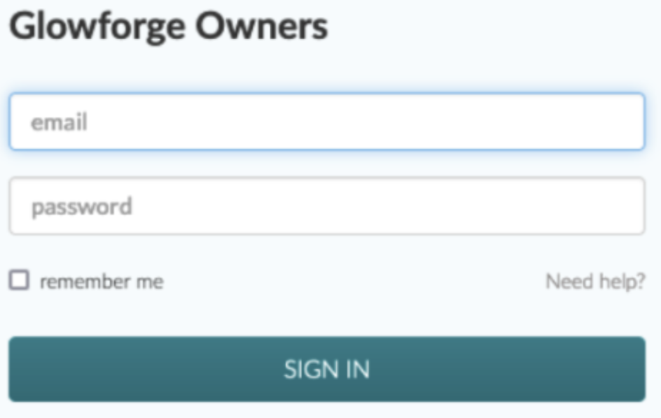

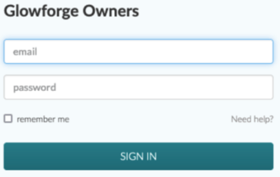

In your web browser, navigate to app.glowforge.com and sign in.

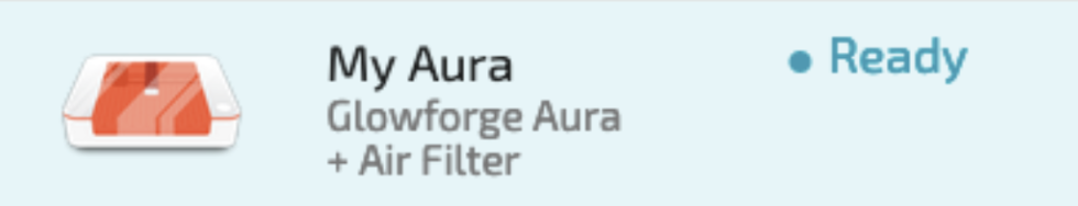

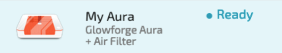

Click on your Glowforge Aura printer icon in the upper right corner.
When your Personal Filter is paired to your Glowforge Aura, you’ll see a “+ Air Filter” along with your Glowforge Aura.

There is no power button on your Glowforge Personal Filter. Once it’s paired, it will run automatically when you start printing. The button on the front of your printer is a status indicator.
When you’re ready to print, the button on the filter will blink white just like the button on your Glowforge Aura. When you push the button on your Glowforge Aura to begin the print, your Personal Filter will automatically begin filtering.
