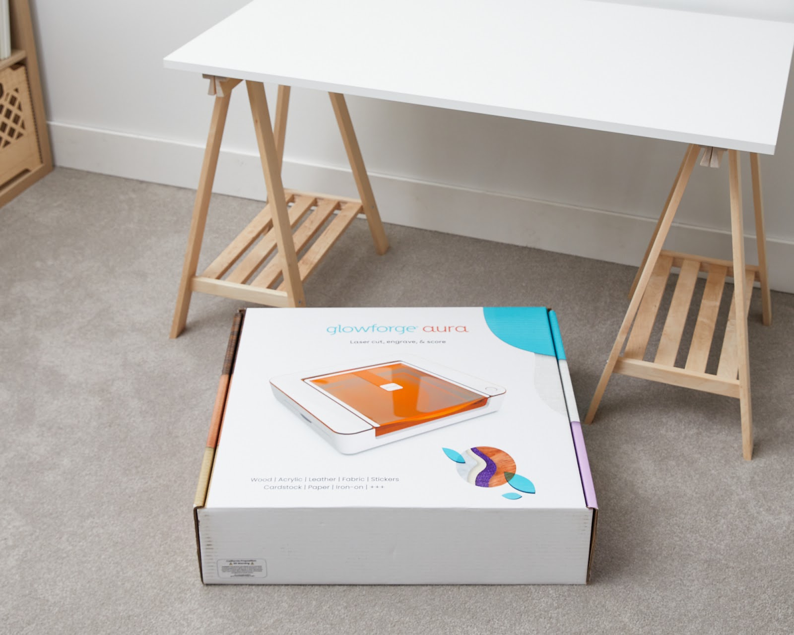

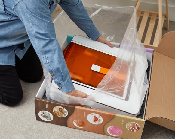

- Gently place the Glowforge Craft Laser box on the floor or large flat surface. Open it.
- Using two hands, remove the top foam piece from the box, and voila! You’ve revealed your Glowforge Craft Laser printer.
- Lift your printer out of the box and place it on your stable surface. Remove the clear plastic bag.
- In the box where your printer was you’ll find a cardboard sleeve containing your cutting tray. Remove this sleeve from the box and set it aside — you’ll need it shortly!

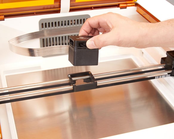

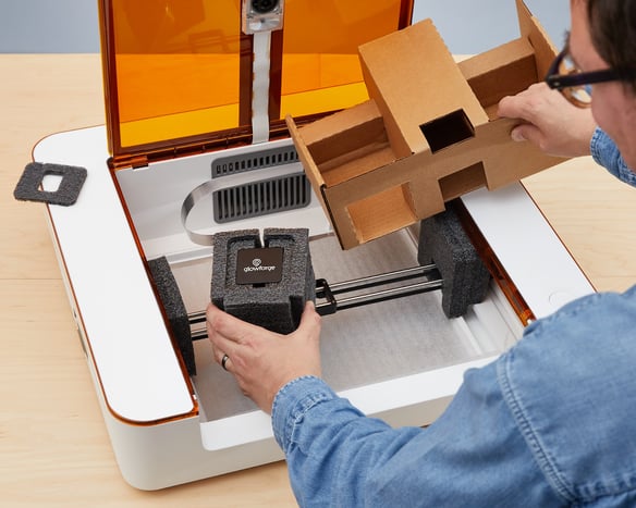

- Next, you’ll set up the laser head. It’s packed snugly in the black foam cube in the top left area of the printer bed. The laser head is already attached to your printer with a laser ribbon cable, so take care not to disconnect it.
- Remove the foam cover from the laser head and lift the whole foam block gently up and out of the cardboard holder.
- Carefully lift the laser head out of the foam block. Take care not to pull or twist the laser ribbon cable.

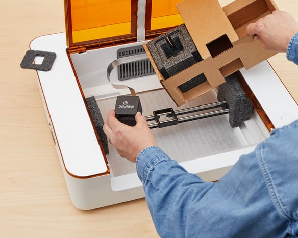

- Hold the laser head in one hand and remove the rest of the cardboard insert from the printer bed.

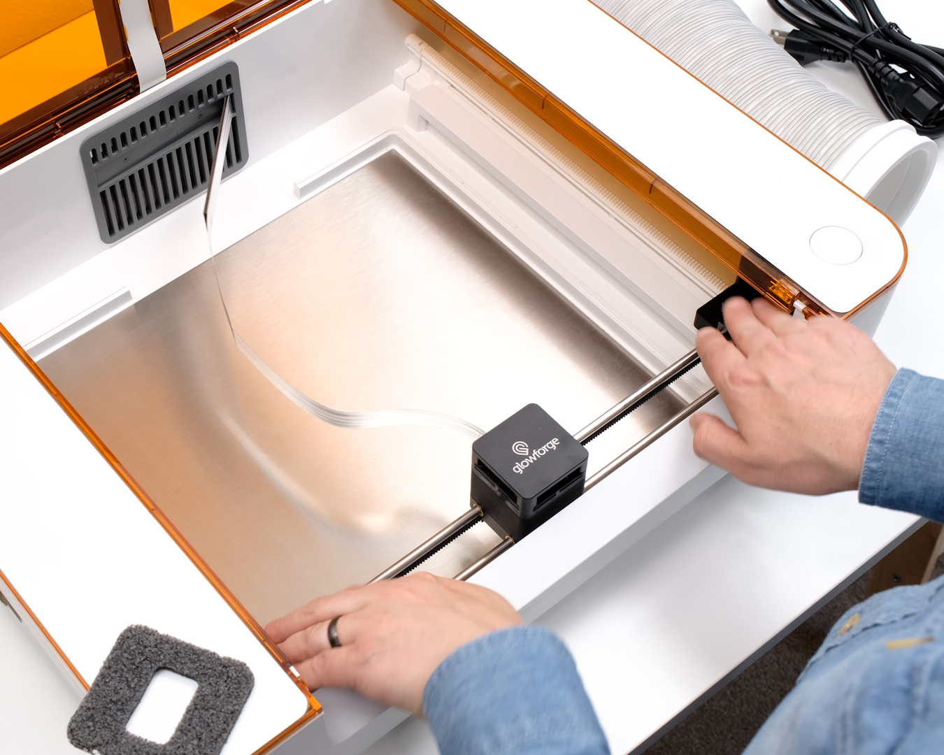

- Next you’ll place the laser head on the magnetic dock. It’s the black square mounted on the two silver laser rails. Set the laser head on the dock with the laser ribbon cable at the back and the Glowforge logo reading left to right. You’ll feel it magnetically snap into place.
- You may find some foam pieces tucked under the rails on the left and right side. Gently remove them by pulling out, then up, and store them with your other packaging.
- Once you’ve attached the laser head, it’s time to align the rails! It’s most likely that your laser arm is already sitting perfectly straight, but just in case there’s any skew there, these steps will take care of it.
- Place your hands on the black end caps on either side of the laser arm. Gently pull the laser arm all the way to the front. Apply a bit of pressure to make sure both end caps are flush with the front. If the laser arm was skewed at all, you’ll feel it snap into place.
- Now, still holding on to the end caps, gently push the laser arm all the way to the back. Again, apply some pressure to make sure both end caps are flush with the back.

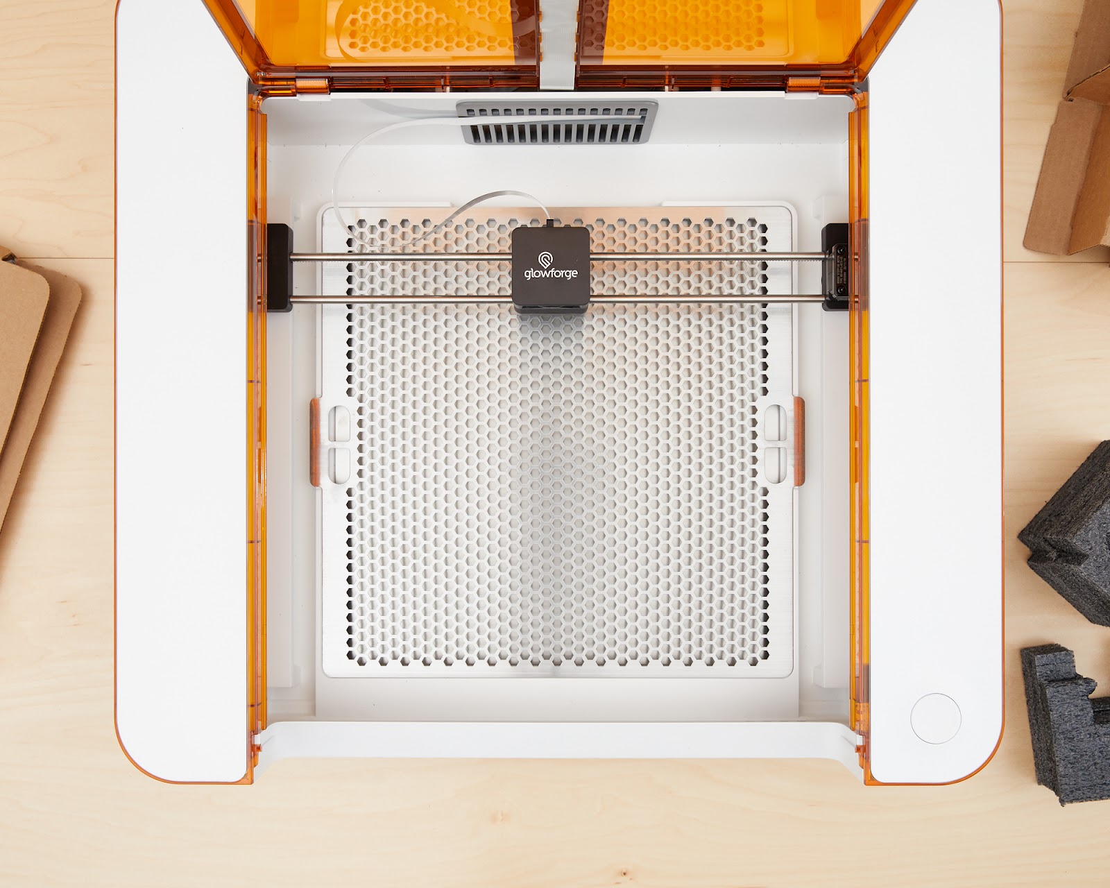

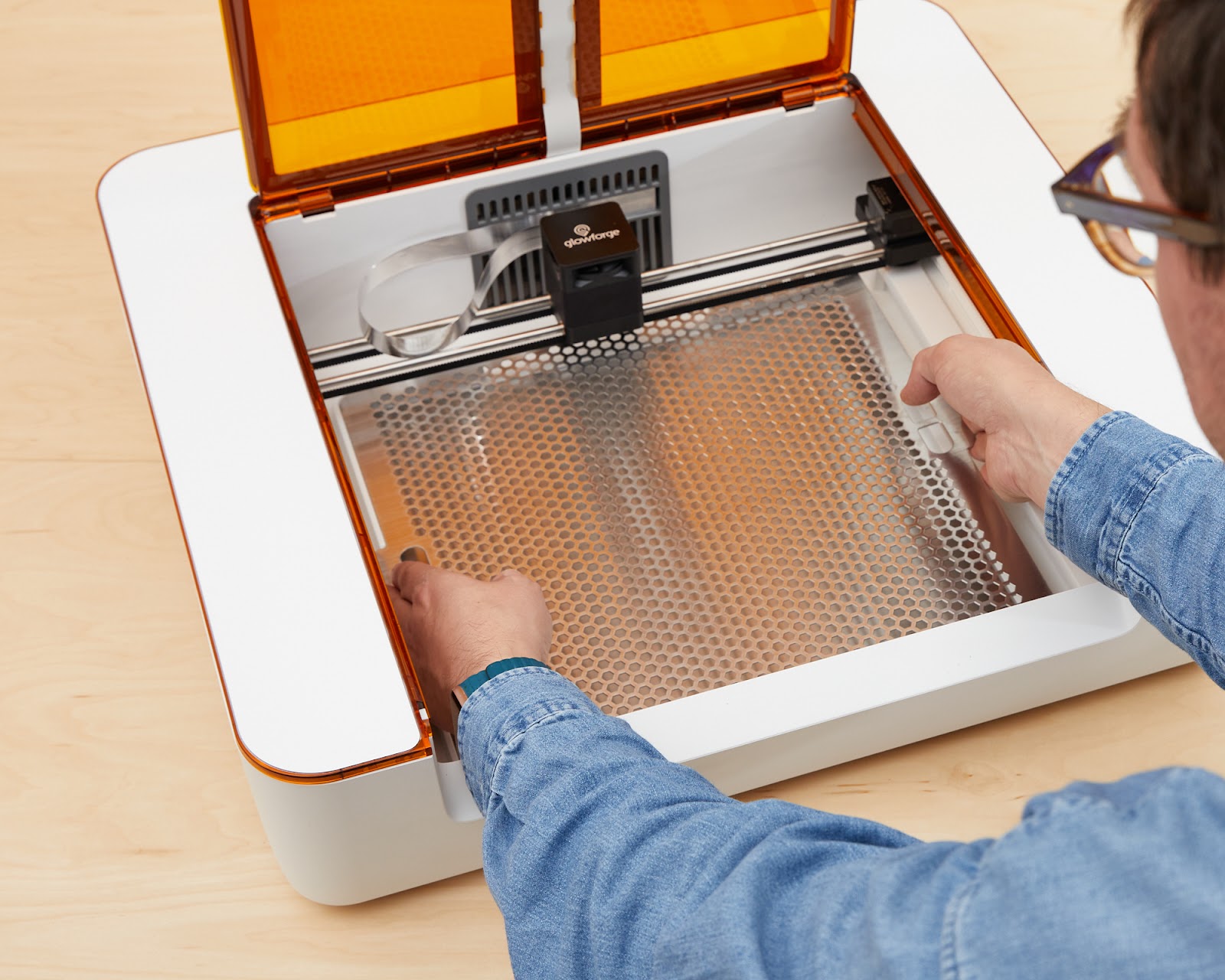

- Remember that cardboard sleeve you removed earlier? Open the sleeve and remove the cutting tray.
- Slide the cutting tray into your Craft Laser. The handles on the left and right sides will slide into the notches on either side of your printer. You should have a snug fit.
- Almost done! Your printer should look like this.

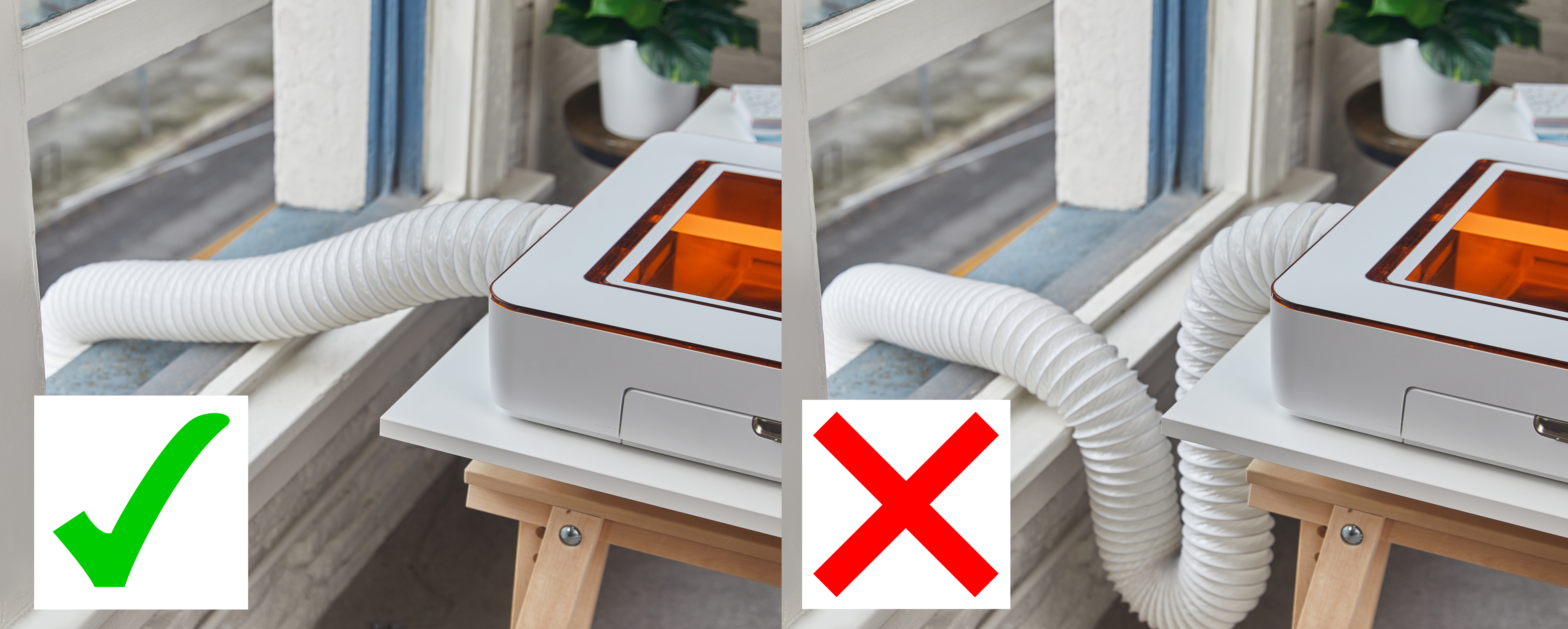

- Connect your exhaust hose to the back of your printer by sliding the rubber ring over the exhaust connection. Push it on as far as it will go. It should be a snug fit around the entire flange, and should not come off with a gentle tug.
- If you’re using a Glowforge Personal Filter, connect the other end of the hose to the lip on the top, and refer to the Glowforge Personal Filter Manual to complete setup.
- To vent outdoors, connect the other end of the hose to the outdoors through a window or a vent that connects directly outside. Do not use a vent that extends the length of the hose past 8 feet (2.4384 m) or adds any turns. Make sure the hose isn’t twisted, pinched, kinked, or flattened.
- If you are venting outdoors, disconnect the hose after use. Changing weather conditions may cause hot, cold, or humid air to enter your Glowforge Craft Laser that could damage it. When your Glowforge Craft Laser is not in use, remove the hose from the vent or window, or disconnect it from your Glowforge Craft Laser.

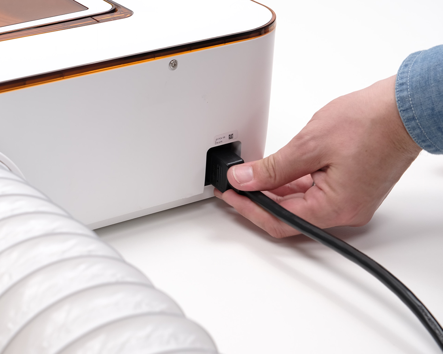

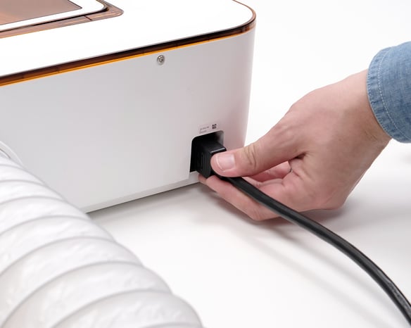

- Finally, connect the power cord to the back of the printer and plug it into an outlet.
- To turn your printer on or off, simply turn on and off the power at the outlet. Or, you can leave it plugged in and it will automatically enter a rest mode after 30 minutes of inactivity.
