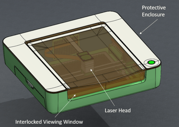

The Glowforge Aura (Model Number GFD200) is a Class 1 laser product as defined in International Standard IEC 60825-1.

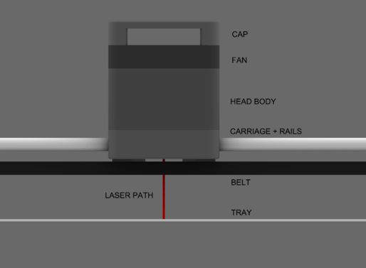

The Aura contains a Class 4 embedded laser source, known as the Laser Head, which is fully enclosed by the product safety enclosure with safety interlock that reduces the product to a Class 1 laser product.
In the image below the Laser Head is indicated, all operators should be aware that the Laser Head is a class 4 laser source with the laser beam path exiting from the bottom of the head towards the base plate of the product.
Figure 1: Glowforge Aura with Laser Head location shown.
Figure 2: Laser Beam path as viewed from the front on the unit inside the safety enclosure.
