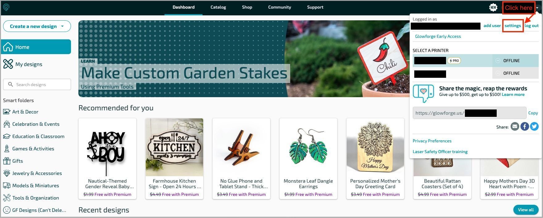

- Log into your Glowforge app account
- Click on your printer's name in the top, right corner and click Settings.

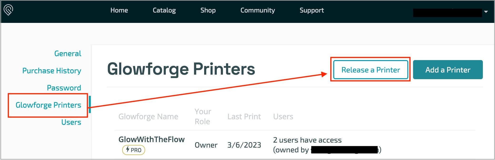

- On the left sidebar, click on Glowforge Printers, then click the Release a Printer button.

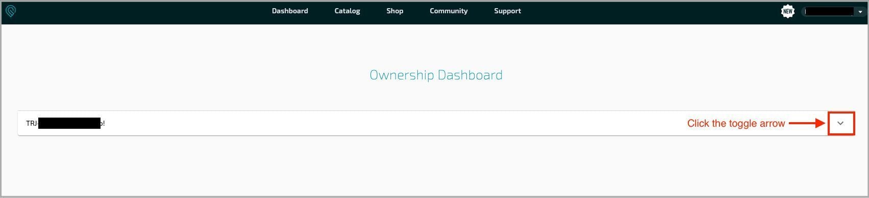

- The Ownership Dashboard will appear with a list of printers associated with your account. Click on the printer you want to release, then click the "To release ownership..." button.
- Click the "To release ownership..." button

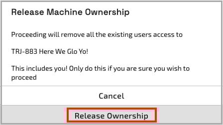

- A confirmation window will appear. If you wish to proceed with releasing the ownership of the printer, click Release Ownership. Otherwise, click Cancel.
A success message will appear once the ownership release is completed. If for any reason you don't see a success message, please contact our Customer Success team and we'll be happy to help.
